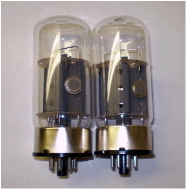

They seem to have something instead of a normal gether at the top of the tube, it look like a small cup filled with grey powder.
For a picture, see here: http://www.jogis-roehrenbude.de/EL34-Story/EL34-Story-Dateien/6P31S-EL36-6CA5.jpg
I've seen some Russian 6550 with those weird pellet getter contraptions. I've wondered how they work... hopefully someone here will know.
