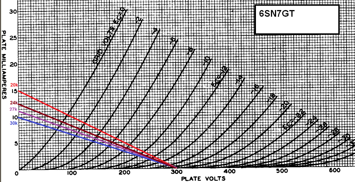

I Order now 20k,24k,27k and 30k 3w resistors.

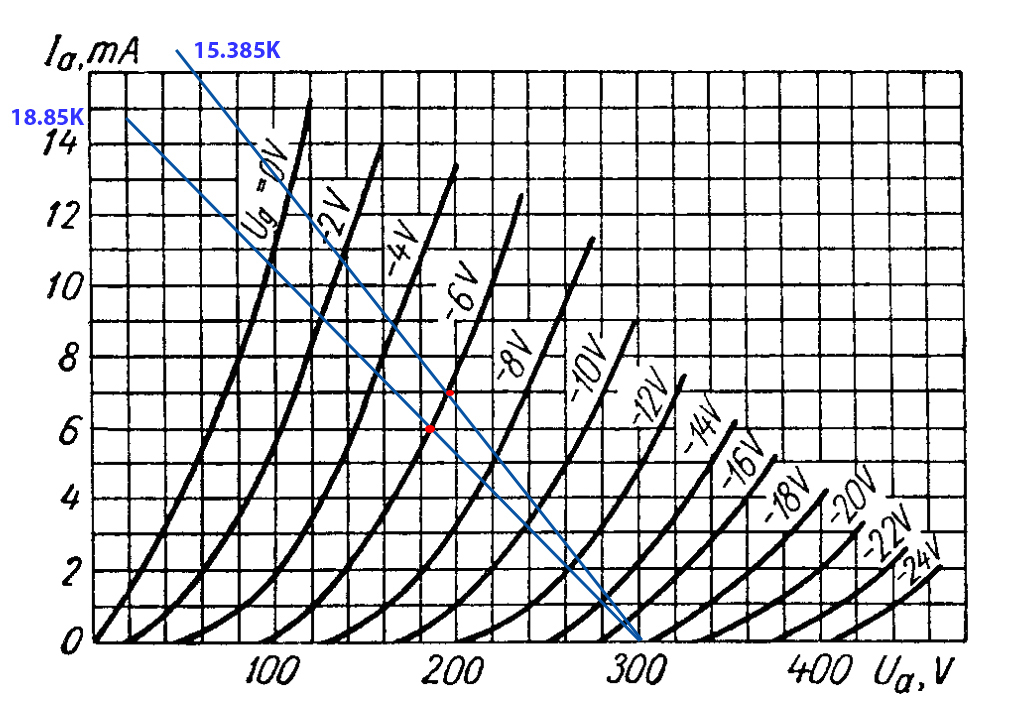

Sorry I didn't wrote the power of resistors at the jpeg, especially Rload 🙂
Lets see 13.5K @ 7mA = 13500ohms x 0.007A=94.5V drop @ Rload
Disipated power will be 94.5V x 0.007A = 0.6615W
This value can lead to wrong direction that 1W Rload will be fine BUT it is NOT like that. Use MINIMUM 4X calculated value! Rload or any other element should be just warm (DO NOT TOUCH HIGH VOLTAGE) and NOT hot...
So Your 3W are at the minimum power rating.
BUT with higher value of this from the example the DC voltage drop will be higher thus the dissipation will be higher. Please calculate before built.
And more important vith higher RLoad and same Vbattery You will shift opperating point to lower Vanode and other changes will include...
I think that these 2 x 27K/3W, (in parallel per 1 section) 6W total dissipation will be just slight warm in the preamp chases with long time operation?

OK but that is just test circuit and with 300V of Vb power supply tube will work at the significant lower Anode voltage. Remember tube is the voltage device not current 🙂
I will draw You test circuit with that supply You already have to test
with that 300V supply You can move lto lower Va of about bit less than 200V (minus 6 V of bias if You use cathode R biasing)
try to stick with Ug to -6V line and about the 5 to 6 mA Ia.
Rk=1200ohms for 5mA to 860ohms for 7mA
Ck= 220uF for Rk=1200 and 470uF for 860ohm

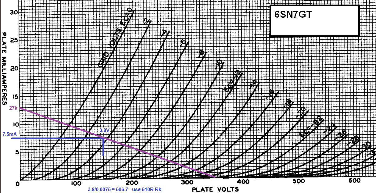

If you have a +350V Ebb and you use 27k ohm Ra, you could use 510R for Rk and it should work well enough, giving you Va = 150V... (Just an example, not "the final word" on anything!)

Load lines for Ebb = 300V and Ra = 20k, 24k, 27k and 30k. You can choose your own operating point, and you can figure out the value of Rk to achieve that operating point.
A couple of example operating points (I'm not saying they're 'perfect' or even 'desirable'. They're just examples.)
If you use Ra of 20k ohms:
Ebb = 300V
Ia = 7.5mA
Va = 150V
Vk = -3.6V (Rk = 470R)
If you use Ra of 30k ohms:
Ebb = 300V
Ia = 5mA
Va = 150V
Vk = -4.5V (Rk = 910R)

Ebb=300v,Ra=33k,Rk=560Ω,Vg~3v,Ia~5,4mA seems good to me...
(6n8s curves, soviet datasheet)
