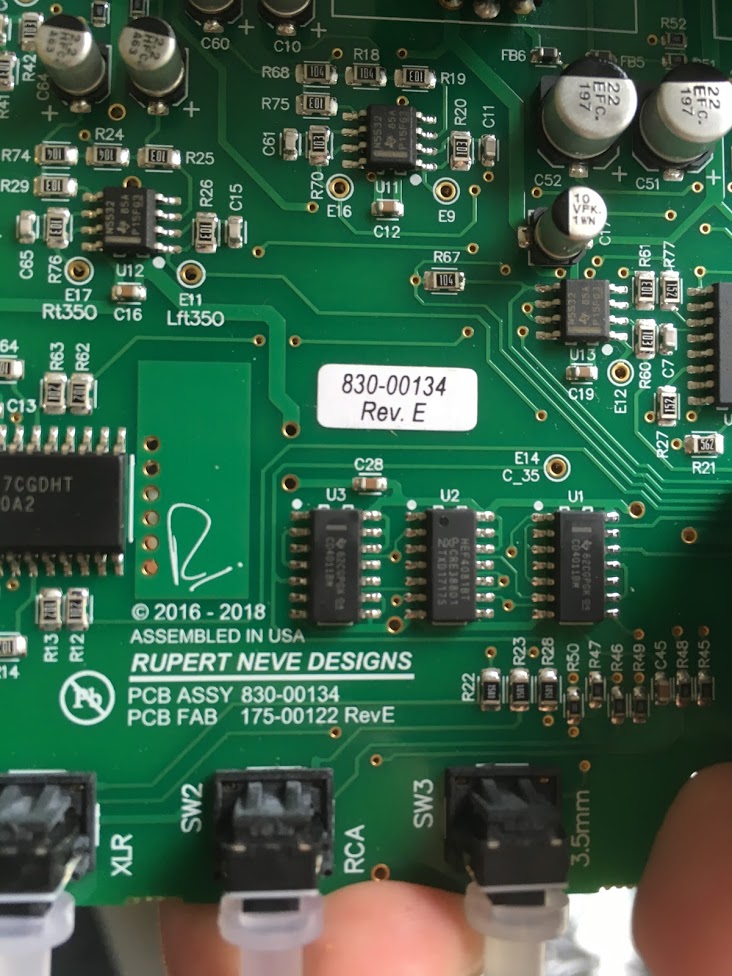

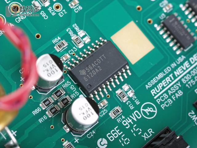

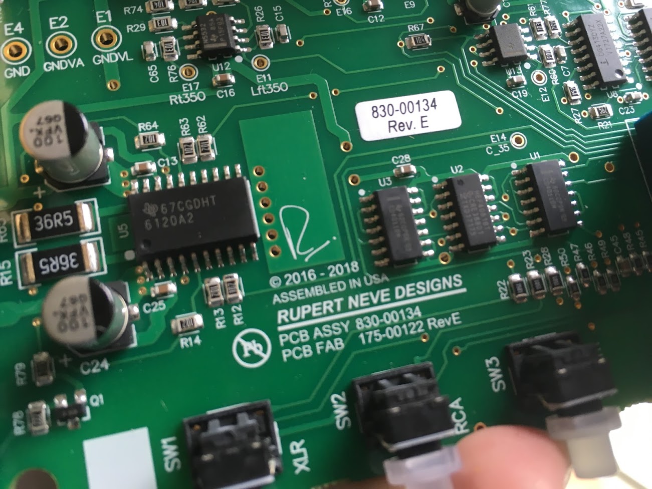

Hi ! i see a socket on the back for a single +24VDC power supply ... do you mean that from this they make a dual supply for the circuit ? i am very interested how they have done this Do you have any idea of the actual circuit ?
By the way ... the parts used have very high specs I mean already reading the datasheets the potential can be clearly seen Of course one thing is the limit and another thing to reach it
