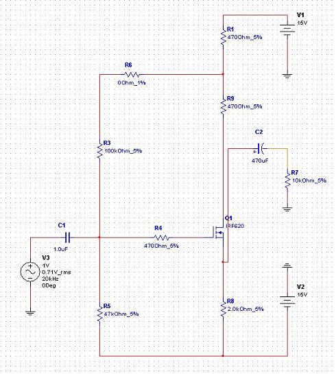

Discrete MOS-FET buffer
I am using the AD825 as follower.
How could I build a single stage MOS-FET follower?
Output from the DAC is voltage and with an off-set DC of 1.5VDC.
I am running through 3.3uF cap and 1M to ground and then to AD825...(+/-15V)
How shall I connect e.g. IRF620 as an discrete follower?
I built this as a pre-amp (gain about 2) but with a slight modification (moving the output pickup to the source of the mosfet) it also works as a follower as well.
the advantage is that it is very independent of supply voltage and transistors used (I have tried it with different mosfets / bjts).
it simulated to about 0.016 - 0.017% thd 1k - 20k, and has flat frequency response through mghz range.
