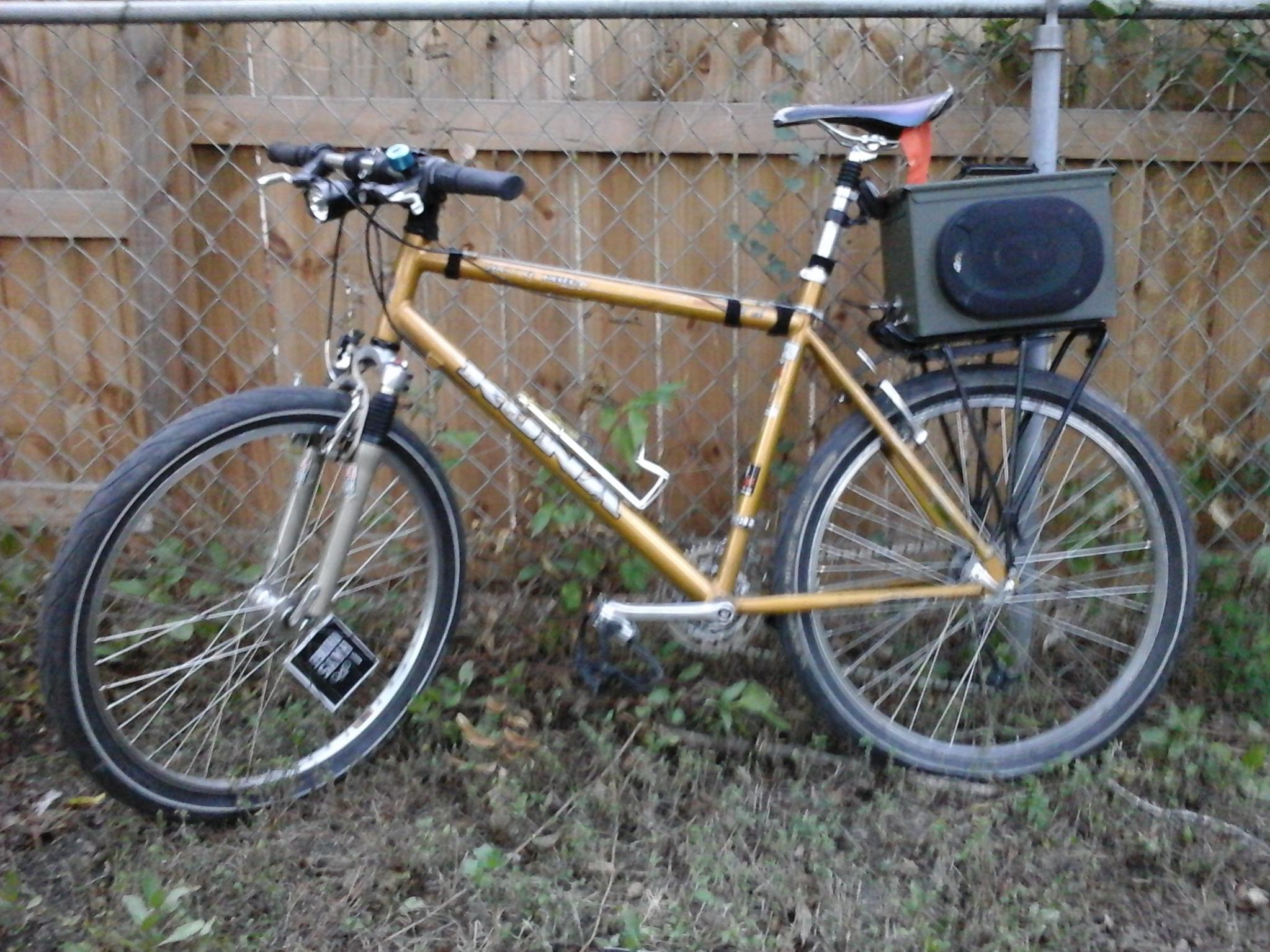

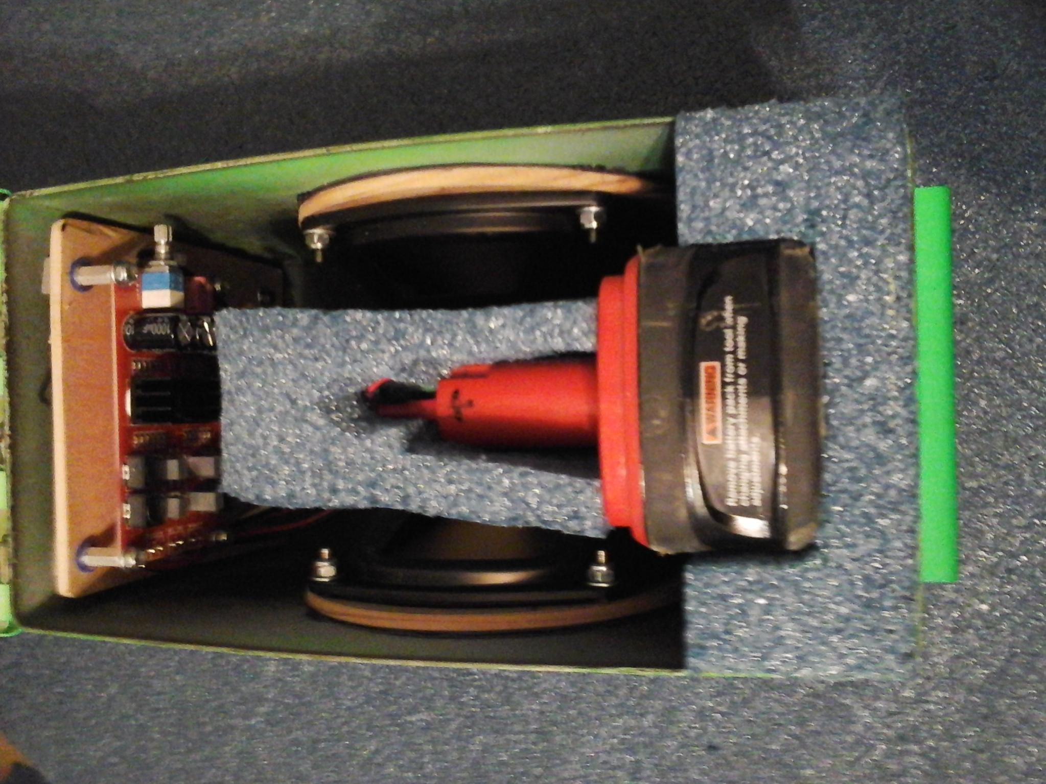

The amp idles at 90mah and begins to clip audibly at 4000mah.
A customer has one my ammoblasters and plays electronic dance music at full volume through 2ohm polk 6x9 speakers. His experience is that a 12v7ah sla battery will last three hours and the 19.2v4ah lithium ion battery will last six hours. He just plays his full blast until the music stops. Only issue is that he cooks the .250 faston connectors every few months and they need to be replaced.
I try to swap batteries before they are more than 70% discharged. Which is six hours on average. The sound quality and quantity is startling.
I find the sla batteries provide more heft in the bass range and the lithium ion batteries provide more punch everywhere. With or without extra stiffening capacitors.
