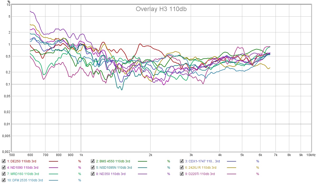

Seems to handle even 110 db at 600 Hz on the Dayton H812 so I can't imagine it being an issue in a domestic setting:
https://www.justdiyit.com/grand-comparatif-de-compressions-1-pouce/5/
In fact, all of the ones in the above test seems to be fine (with the odd exception of the ND350)

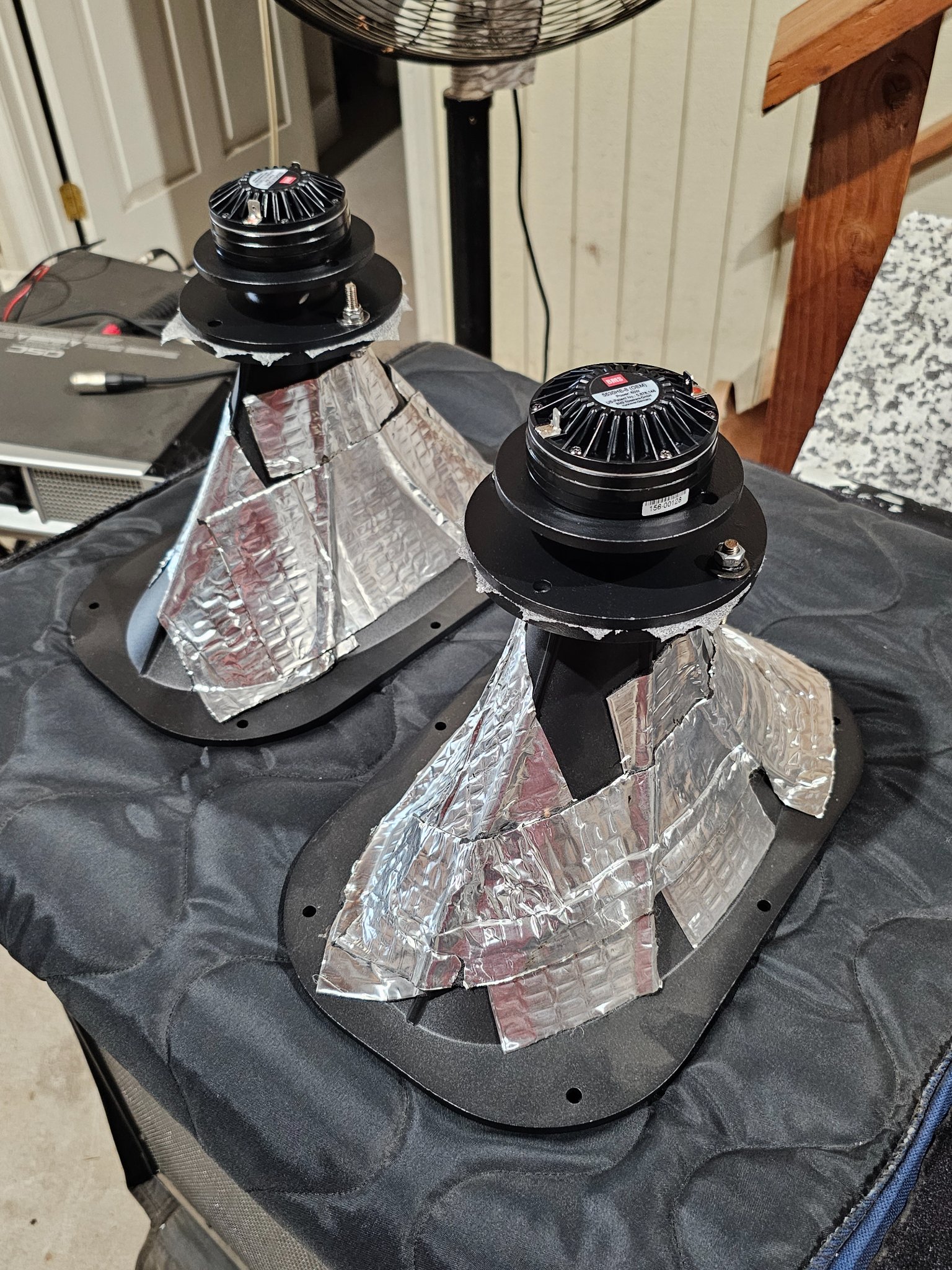

I have a pair of 5530HE's & PR614's. Just need some adapters to try this.
That's actually the exact horn I'm curious about trying the 5530 in. Was looking at the Eminence HA1-14 adapter. Curious as to how the angles match up.
Ordered a pair of the Eminence adapters last night. I'll try them next weekend.
Ohh! That's exciting 😀Please post the results

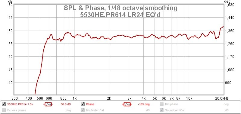

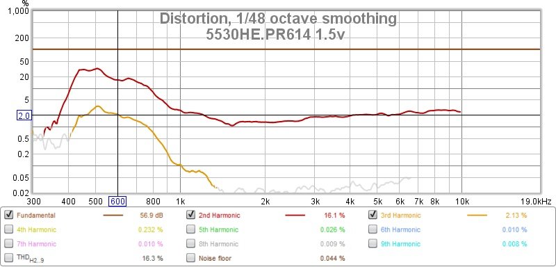

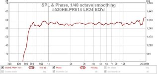

LR24 @ 600hz and 4 bands of parametric eq for this response. Listening test with one horn on top of 2x15's.
This combo did much better than I expected! I pushed it to shouting levels at the listening position 4m away.
These can definitely be used down to 600hz in typical domestic settings.

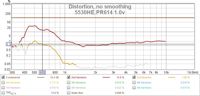

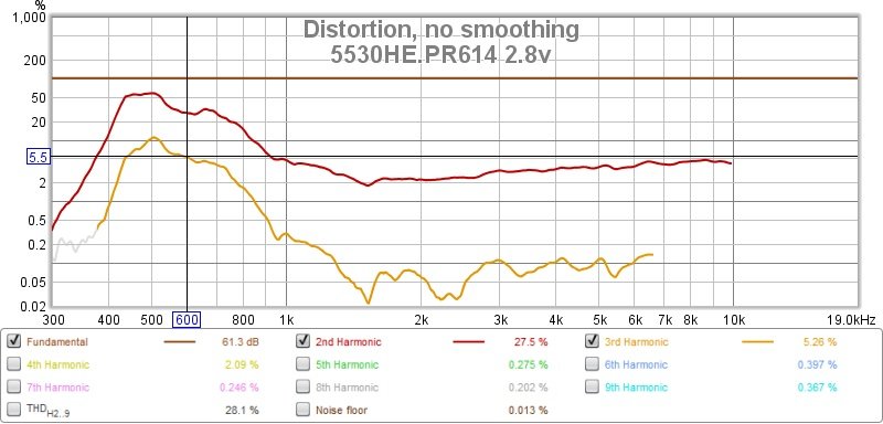

Thanks for the measurements! Quite the rise in distortion below 900 Hz. Strange though, since the same behaviour isn't observed in the test on the Dayton H812 horn in post 1. Which also loads down to ~600 Hz same as the Ciare.
I think we're seeing the advantage of the exponential flare in the Dayton. It will naturally load the low end better while narrowing high frequency dispersion. It took a lot of eq to push that low in the Ciare.

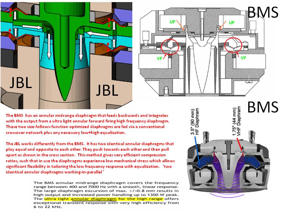

The Faital HF1440 or JBL D2 are probably the best bet for clean low end and top octave extension from a single diaphragm on a constant directivity device.
That being said...I was surprised to prefer a 600hz crossover vs. 1khz. I was expecting the rise in distortion to really present itself at higher listening levels.
I see that in the Voice Coil test but it doesn't show up in this test by audiohorn. I didn't no notice any objectionable resonances.

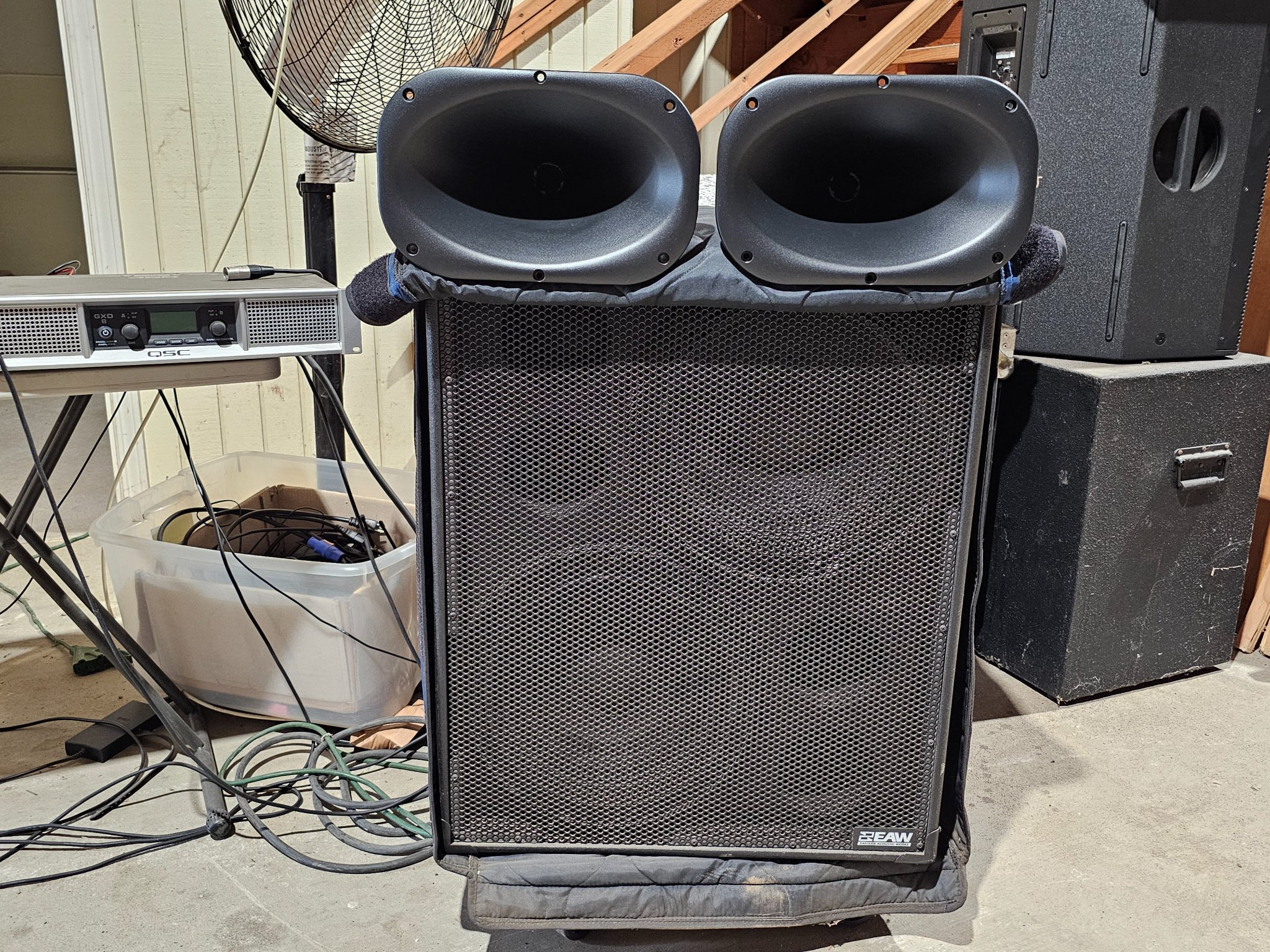

Replaced the battery on my spl meter this afternoon. 80-85db average with peaks reaching around 95db at 4m...at least with this driver.Curious, what listening levels do you find acceptable when crossing a 1" compression driver at 600Hz?
55 - 60dB ?
I've certainly heard worse from other 1" drivers crossed on octave higher.
That is impressive. PR614 seems like a legit combo. Did you try any other horns with the 5530HE ?80-85db average with peaks reaching around 95db at 4m...at least with this driver
It's very good...for prosound use it'll do 1khz all day long.
I will be trying the seos 12, QSC waveguide, and the Eminence WG10 over the holidays.
