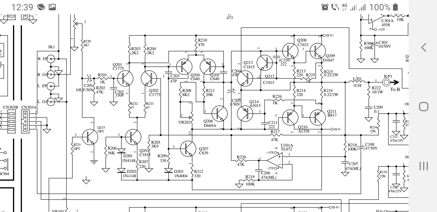

Judging by the internal schematic of Parasound Z3, if I had 4 of them and no possibility to upgrade to a biamp system, I'd do a bold move : change the symmetrical supply to single supply(simply use 2 rectifier diodes of the bridge and no negative) , bias the amp's input at 1/2 v supply, change the input capacitors to nonpolar ones(that depends on the type of bridge type of drive) , probably dump the dc offset U101 or work around r219 refference .... and make it bridged .
That will get you almost the same theoretical output power, but better thermal management and transient power delivery in the low register, also colder amps mean less offset so less need for dc offset compensation. You could even make use of a higher bias approaching class A operation so less crossover distortions if carefully biased . Input stage slew rate doubles, but the final transistor Early effect worsens so you don't really get better speed unless you change the final transistors with faster ones ,but that's gonna be rather difficult to do as 2sa1047 with just 20Mhz ft actually has 120pF BC capacitance, 50pf less than 2sc5248...so the final stage is already pretty fast at lower supply voltages making it good for lower supply bridged operation.
