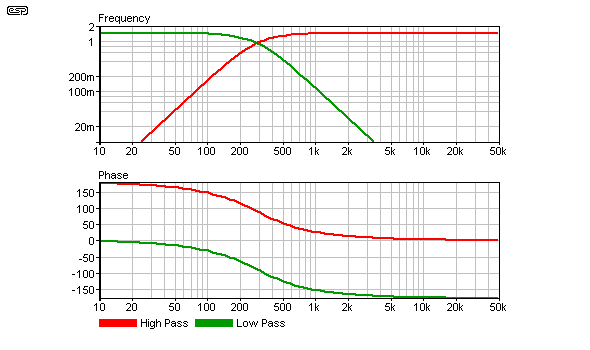

I found the site that convinced me of the idea – BiAmp (Bi-Amplification - Not Quite Magic, But Close) - Part 1 – and that I should prefer active line-level crossovers & bi-amping outright.
"...with 12dB/octave filters there is a phase reversal between the low frequency and the mid+high frequency outputs"
...but also...
"Note that 24dB/octave crossovers not not suffer a phase reversal."
I attached a graph from that page, captioned "Figure 4 - Frequency And Phase Response of 12dB/Octave Crossover", it is the first google image result for "passive crossover phase".

and the first reponse was:
Assuming an analog circuit, there will always be phase shift at the crossover point. I don't know that I would go so far as to call it 'distortion' though.
so what are you referring to?

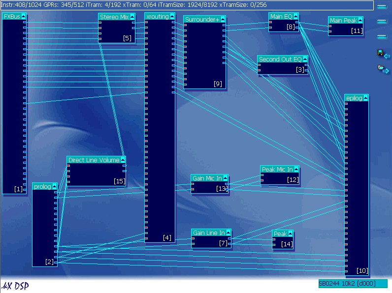

Sorry... to explain the idea behind the post — it is a cost saving idea — suppose I have two amps and four speakers – a pair of subs, woofers, mids, & tweeters (after my new pair of tweeters arrive because I fried my other ones I will have exactly that) & wish to create custom software crossovers, equalisers and volume levels for each speaker with a soundcard that can output 4 channels, but don't want to buy four amps... with this method I could do it with two channels and two amps & could still tweak the individual speakers in software (within the constraints of the passive crossovers). I spend months tweaking xo & equaliser settings, I couldn't really imagine doing it without software.
The kx driver is wonderfully intuitive & flexible, image attached (from google, not from my setup which is currently a M-Audio Delta 44, I will have to buy another second hand Creative Audigy 2 ZS or E-Mu card to finish this project if I can't find similar software that will work with a wider range of soundcards).
