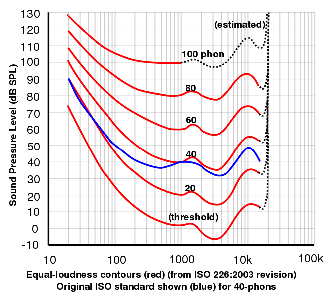

Moreover, the physics of moving that much air at 20 Hz is truly forbidding... if we were really honest about it. Most profound speakers are giving us lots of second harmonic that we readily hear (and love) as super-low because a little 40 Hz sounds far louder than any wee 20 Hz we could generate.
Well yes and no.
Most subwoofers are not up to the task. Take a good look at the threshold levels for the low end. 16 hz is at 85 db. You need to be moving 2.89 liters of air to get that loud in a decent sized room. Most subwoofers are not up to that part of the task. They simple don't have enough woofer area and linear throw to make it happen.
But when you puirpose design a subwoofer then there are areas that can be tweeked and well engineered to get exactly what you are after.
So when you comment that most systems are only giving us loud harmonics. I have to agree. But I don't listen to most systems. I listen to custom designed system. Mine. And I hear the fundamental. Pure clean and with very low distortion levels. Hence the latest and greatest behemoth subwwofer I built. Specifically to create all and sundry away down low so that I could hear it in all it's glory.
The graphic I post below is the best sorted out loudness contours that are available. The old Fletcher Munson curve is there for reference. The gist of the reasoning is better speakers lower distortion and therefore beter acuity in hearing the tone in the first place.
To get the 108 to 110 db at 16 hz on a few of the recordings that are available you need to be moving 4 liters of air. That is 4 15" drivers of normal capabilities or two hum dingers.
Or you could horn load a driver and get the low down loud. The expense is box size. The downside is that a proper horn will have greatly reduced distortion compared to a direct radiator.
