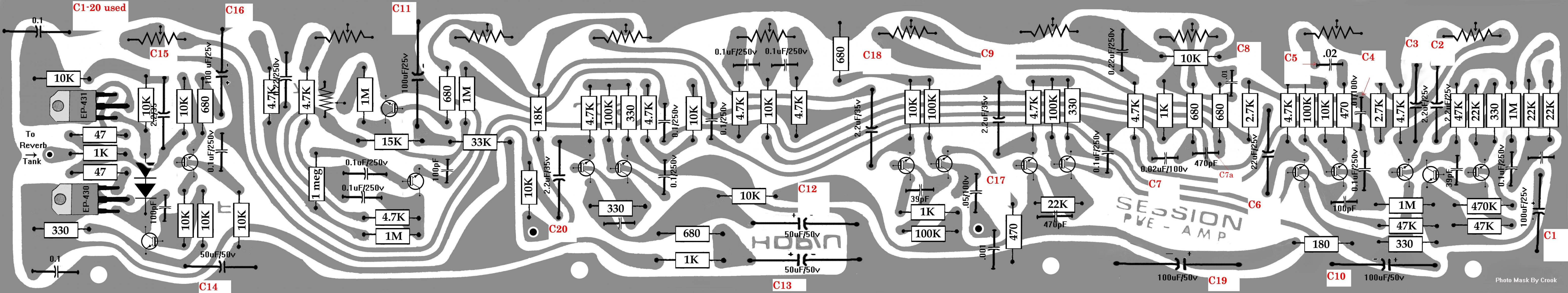

I'm getting back to this. I finally figured out how to upload a photo.
Would you conclude this was laid out with tape on mylar?
broken track just below c20
Someone stuck a label over it.

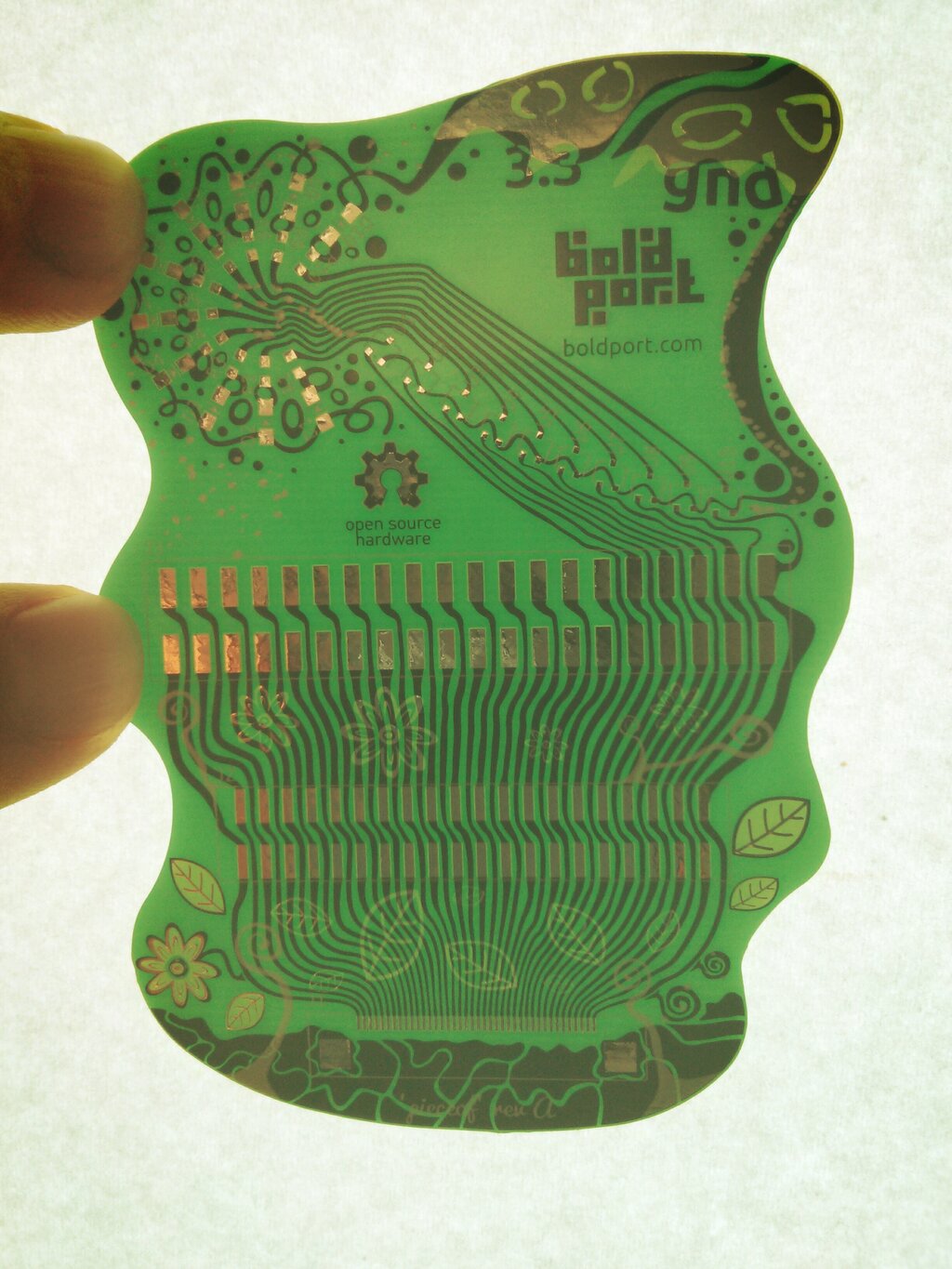

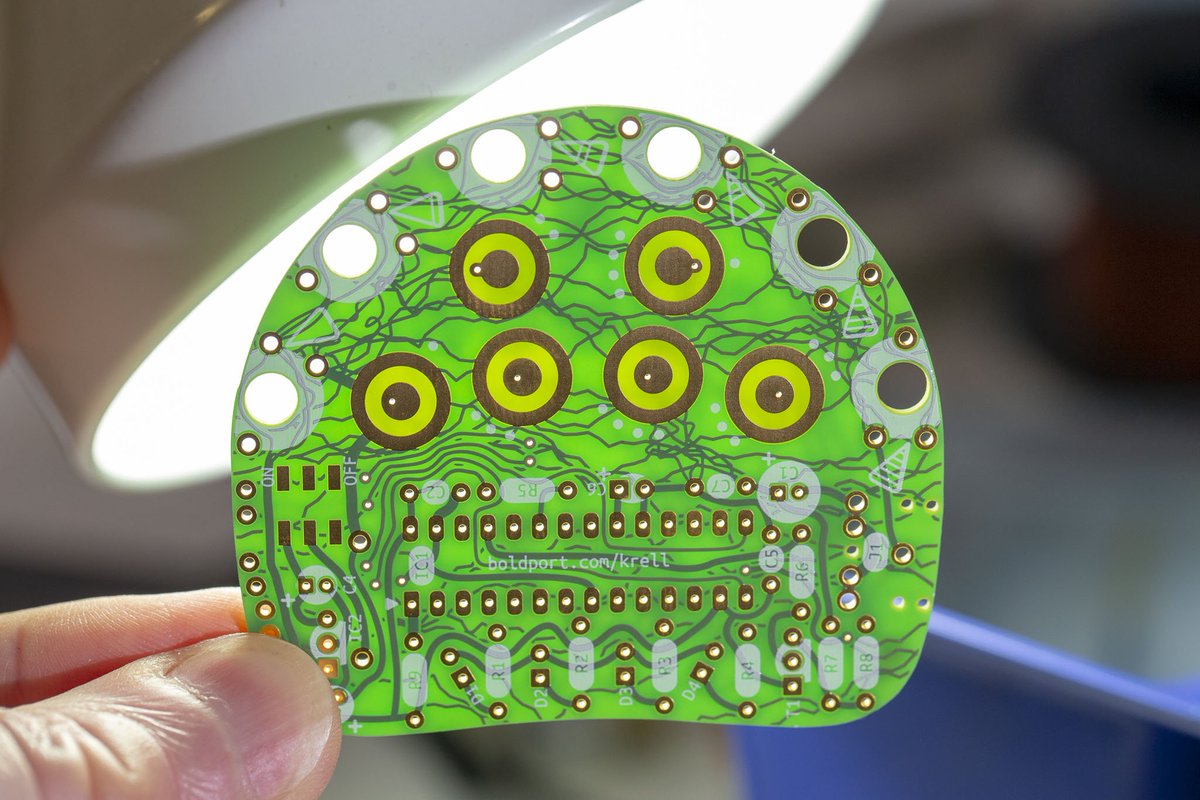

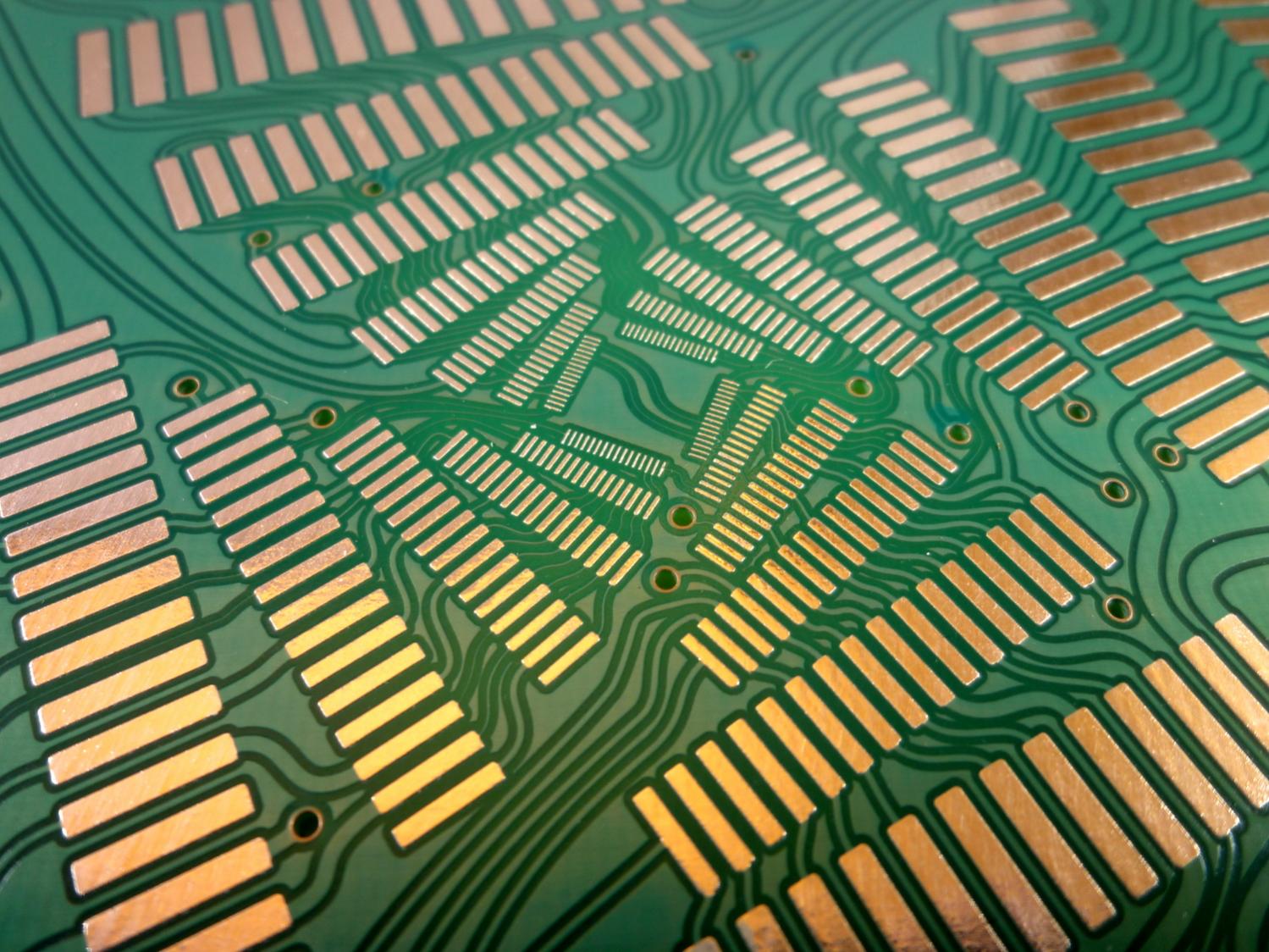

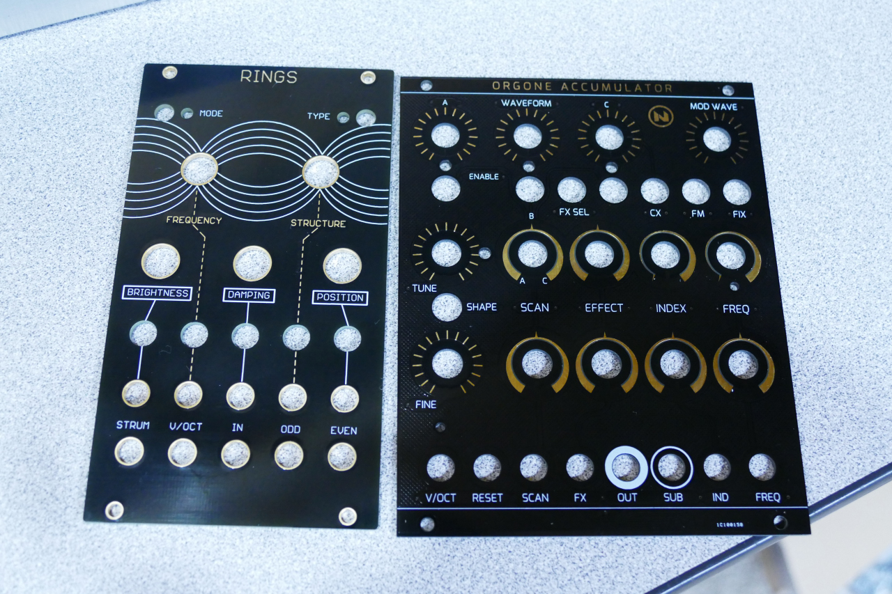

People are doing some really amazing stuff with PCB art these days. These are all from BoldPort:
They use their own EDA called PCBmodE which is aimed at the unusual. Check it out: A circuit board design software with a twist | PCBmodE
I started doing tape ups many years ago, CAD was a life saver.
The corner structure for digital or analogue dosen't make much difference up to low GHz, when a signal goes through a via it is an orthogonal corner. Curved looks pretty but for most stuff not required and most microwave I have done has a 90 deg corner with a bit of the corner shaved off.
Those PCB's above look horrible as a PCB, yuk...
