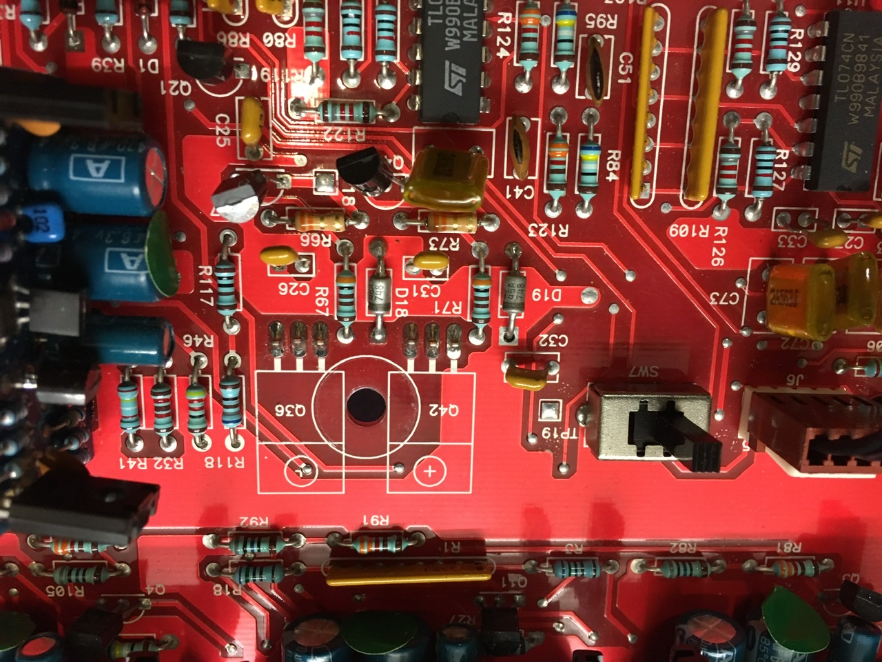

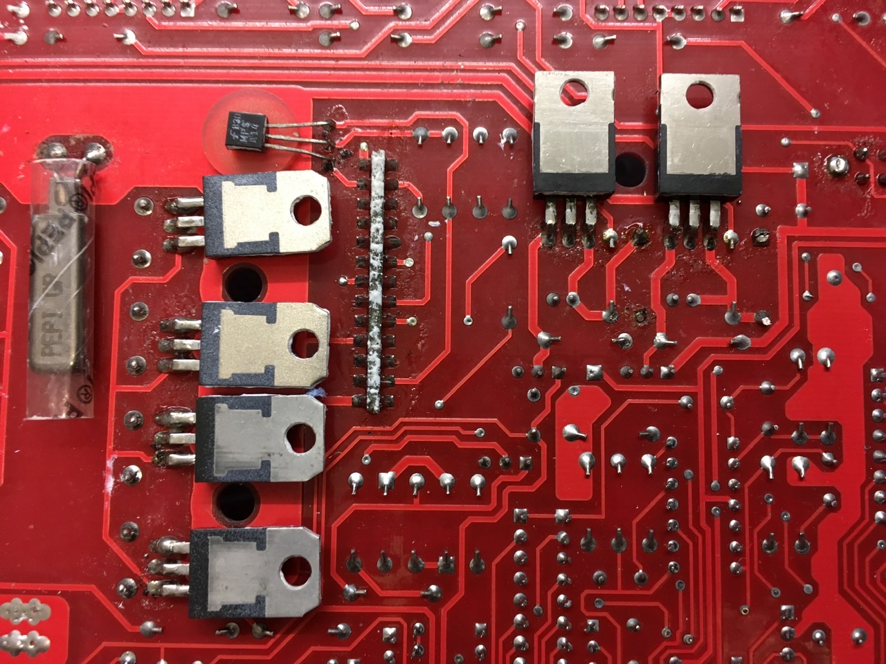

It looks like q36&q42 have been replaced, somewhat badly by the look of it, as well as the Zener diodes in the Op Amp power supply.
Those transistors should be TIP102& TIP107
Am I ok to briefly power up the board without the heat sink attached to check the Op amp Psu?
Power it up for a few seconds and check the temperature of all heatsink mounted components. Do this several more times with slightly longer times until you can see if anything is going to heat up.
They are likely OK. They are voltage regulators which will run warm (in some amps so hot that they will fail off of the heatsink).
Ok, that’s good to know. I measured the voltages from the Zeners and they are within a tenth of a volt of each other. The noise on the OPamp power rails measures around 10mv p-p and around 5mV rms.
That’s higher than I would like, I suppose it is within spec for the application but...
Were you using a ground very near the op-amp for the black probe (scope probe ground)? When measuring critically, the reference is very important.
I wasn’t, I had grounded to a non bridging negative speaker terminal with an isolated scope. I’ll try again.

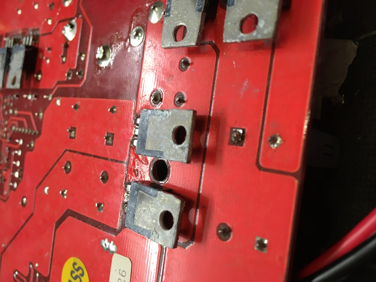

Did you repair the broken via? If it was partially displaced on the bottom, the connection to the top of the board was likely broken.
I don’t really know how to, I tried using a small piece of solid copper wire, soldered on to the top and ran through the hole. I then pushed the capacitor leg through and soldered it.
I’m not entirely happy with the repair as you can imagine.
Is there a proper way to do it?
There really isn't anything wrong with that as long as you had a long enough section soldered to the top so that it didn't come unsoldered when you soldered the bottom.
If both terminals on the inboard side of the caps goes to ground, you could additionally run a strip of solder braid to the other cap (insulated from the bottom traces, of course).
Ok, well the caps measure as being in the circuit they are supposed to be so I’ll call it a (messy) success.

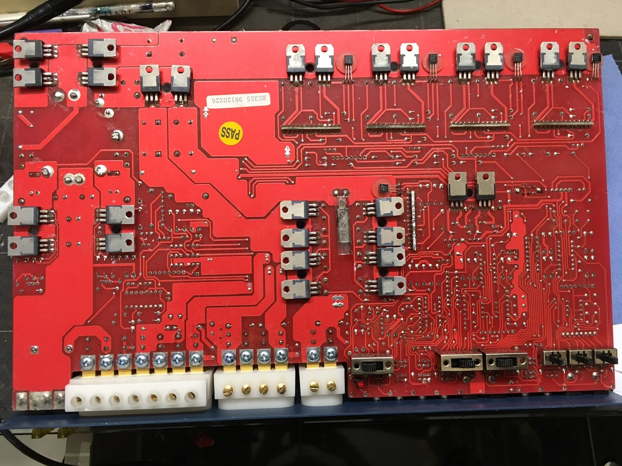

The amp is back together and in the test rig.
When I first powered it up it made a horrendous farting noise through the left speaker.
I pulled the wire in panic and checked for bridges, shorts, etc.
I cautiously powered it up again and it’s fine, been playing music through it for half an hour now.
It sounds good but... perhaps a little sloppier in the treble than I would have.
Is there a cunning way to test for high frequency distortion?

If your scope can analyze frequency drive a pure sine wave into it and see if any harmonics pop up. That would only be for the simplest type of distortion.
