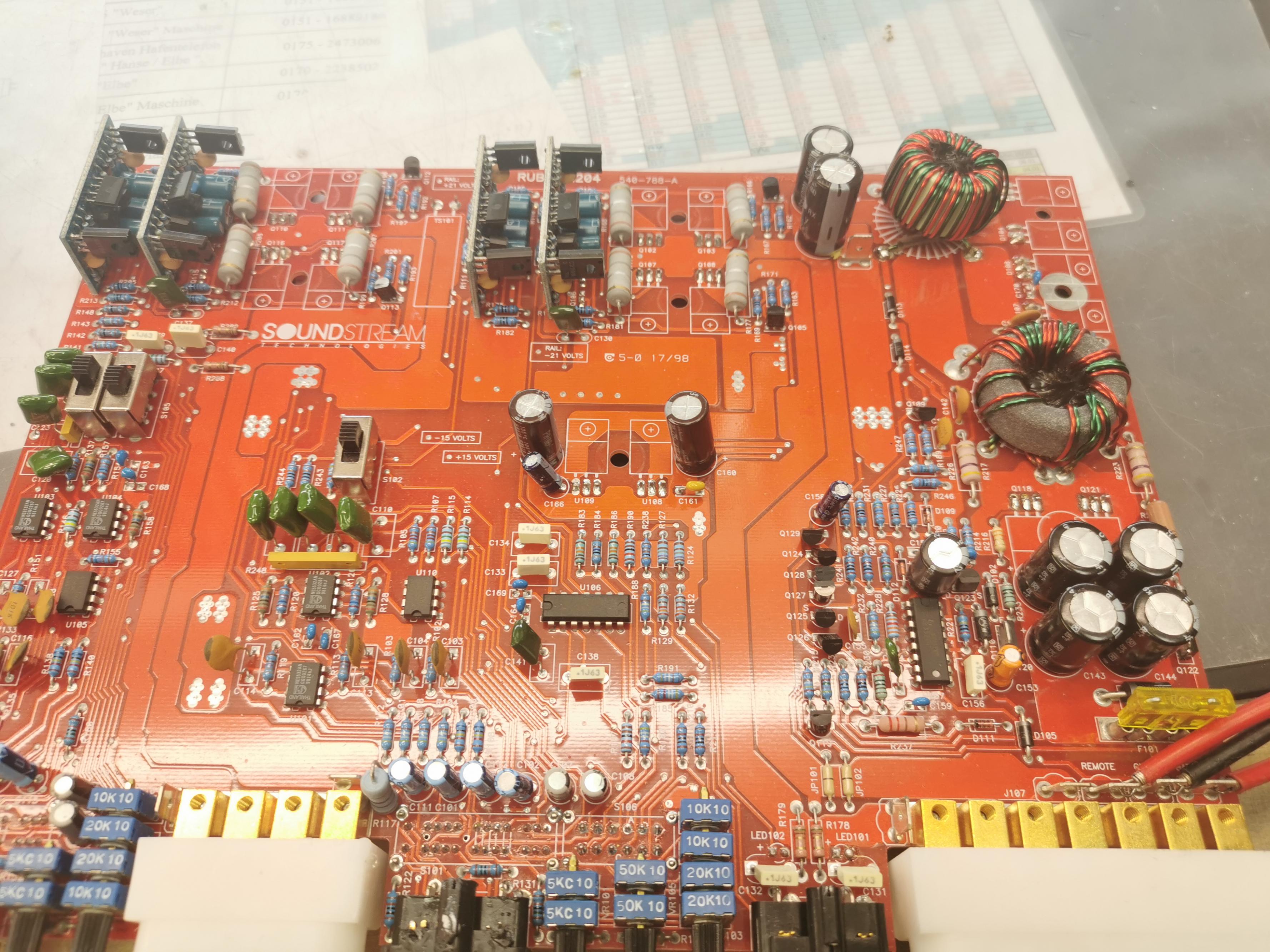

Rubicon 204 soundstream

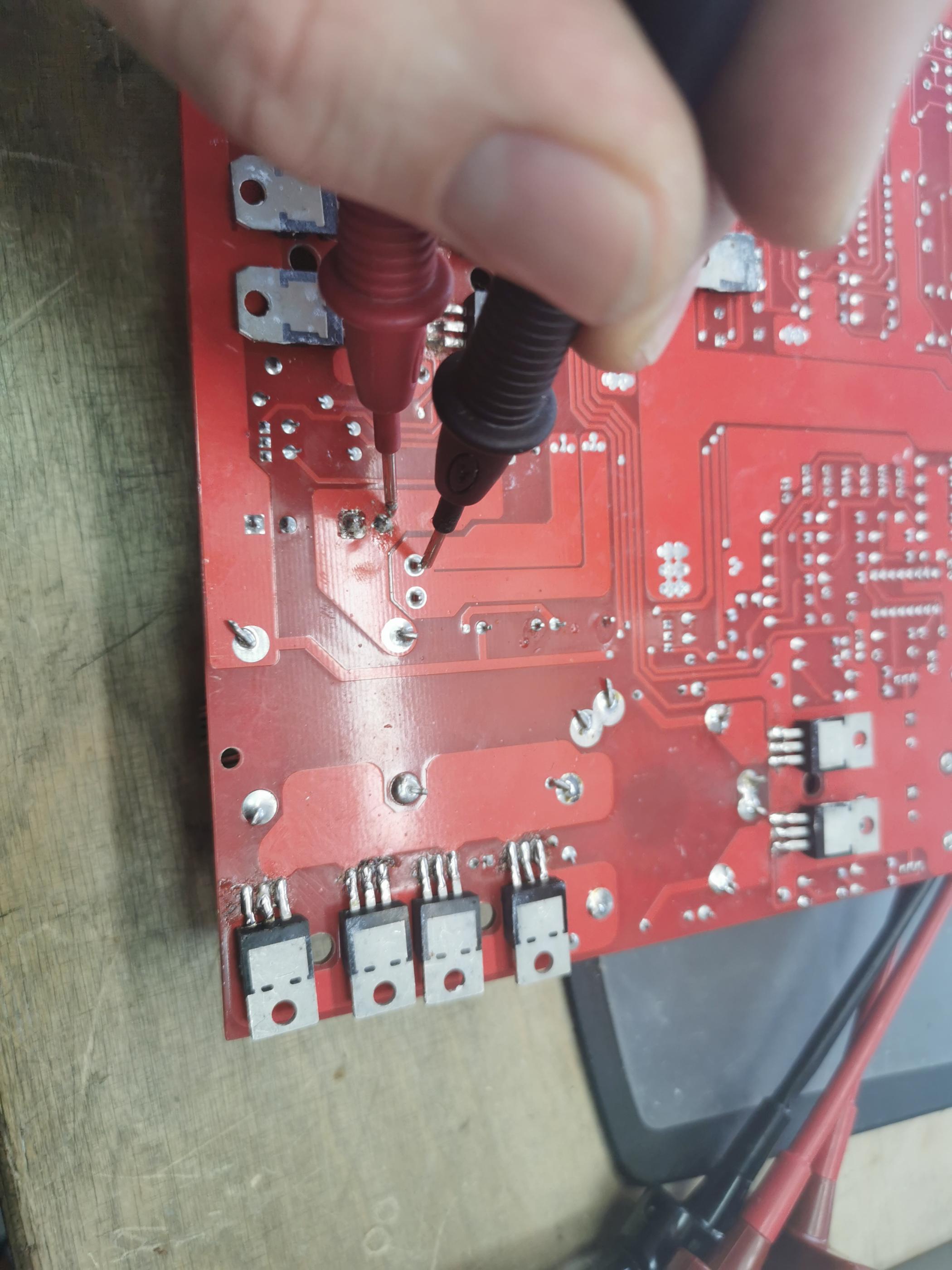

Have some issue with this amp. Can not find a real problem. Output produces some intervall popping noise. I have only positive rail and positive 15v. If I connect black probe on center between rail caps, on one cap I have+ 20.8v on the other +19.8v.
14v on the op amps between pin 4 and 8 on ne5532ap
