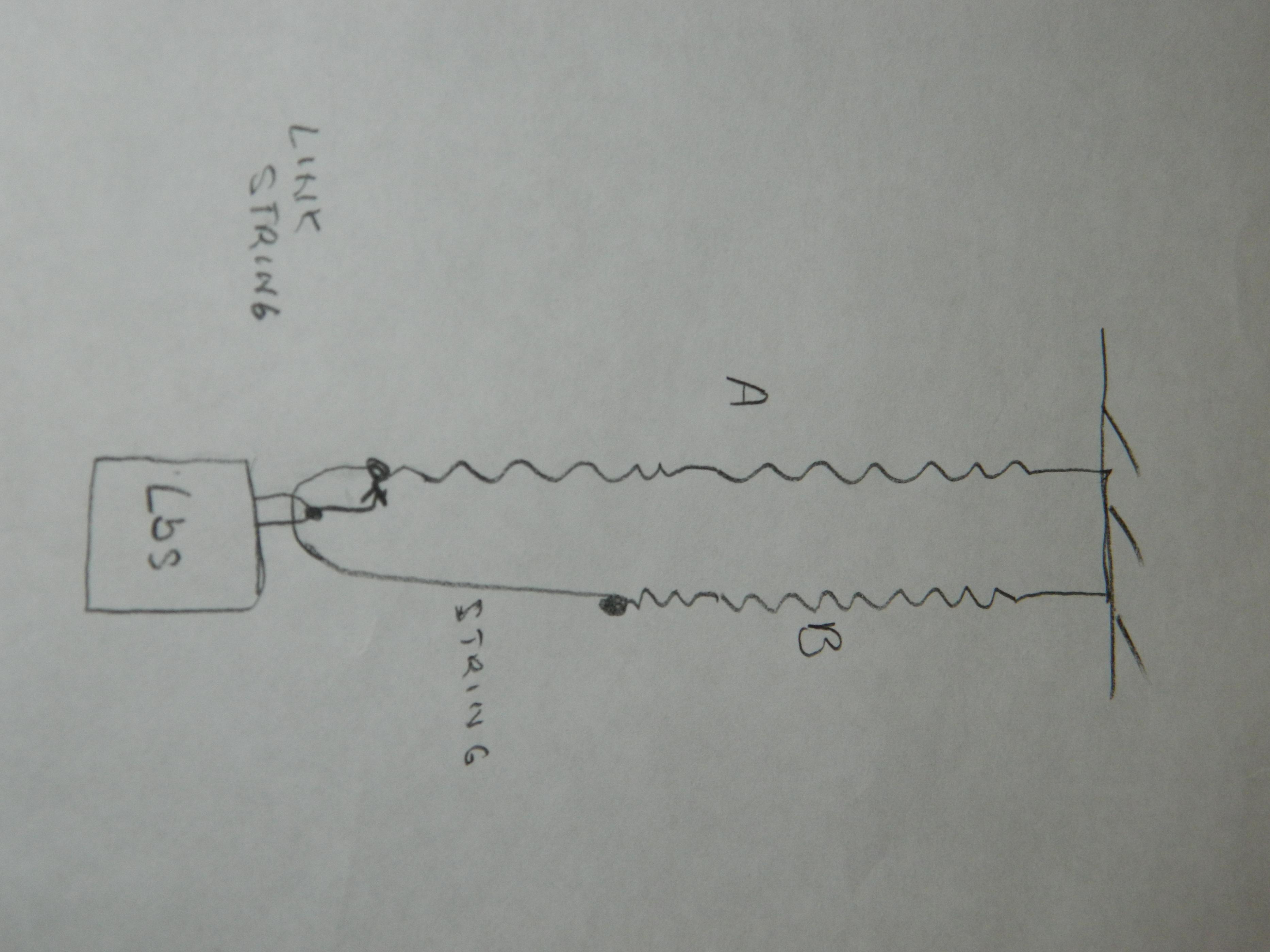

As drawn, spring A is bearing all the weight because I added a string from the weight to the A spring to string node.
Spring B is relaxed because the string from A to B allows it to relax.
Cut the link, and spring A will go up, it will pull B down. When equilibrium is established, A and B will share the weight.
If the string between A and B is sized correctly, the weight will climb exactly half the distance between the A and B nodes as drawn when the link is cut.

Are you sure? The sum of the forces seen by A and B is constant. If elasticities are the same, then any force difference will cause the same amount of contraction and expansion in the strings, therefore the height remains. You need stiffer right spring. The stiffest is the string. And this way one can easily see whats going on basically. The length of string has no role at all.
I assumed the springs are linear. 10 lbs will cause twice the extension of 5 lbs.
If I use 1 inch per lb as a constant, spring A will drop 10 inches under full weight. If I make the A to B string 10 inches long, it will just be straight, with no pull on it.
When I cut the link, spring A will rise up, the string will slip through the loop at the weight, and it will pull down on spring B. When both A and B have the same weight, they will be 5 inches extension each.....oops...
D###. I think you are right, I'm wrong..😱
But still, a nice puzzle...
John

I though you understood a steel spring in normal use is a torsional device thus reasonably linear force vs stretch. A rubber band gets thinner as you stretch it so it is not linear force vs distance.
So you are correct in asserting you erred. But it was not the solution's design, rather in believing it wouldn't work.
