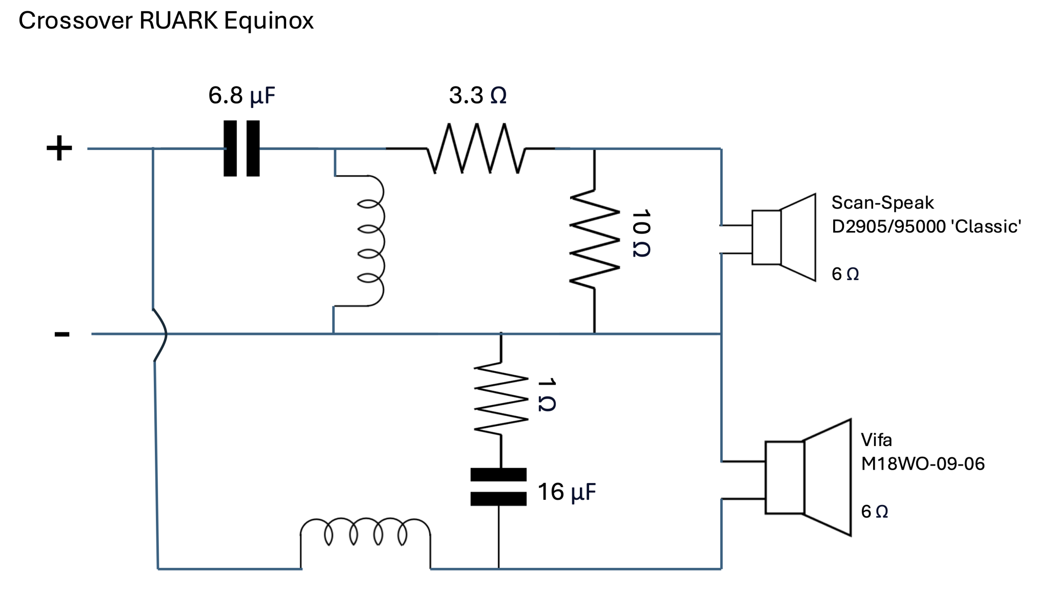

Hello there,
I'm reopening an old thread:
Ruark Equinox Driver Quest

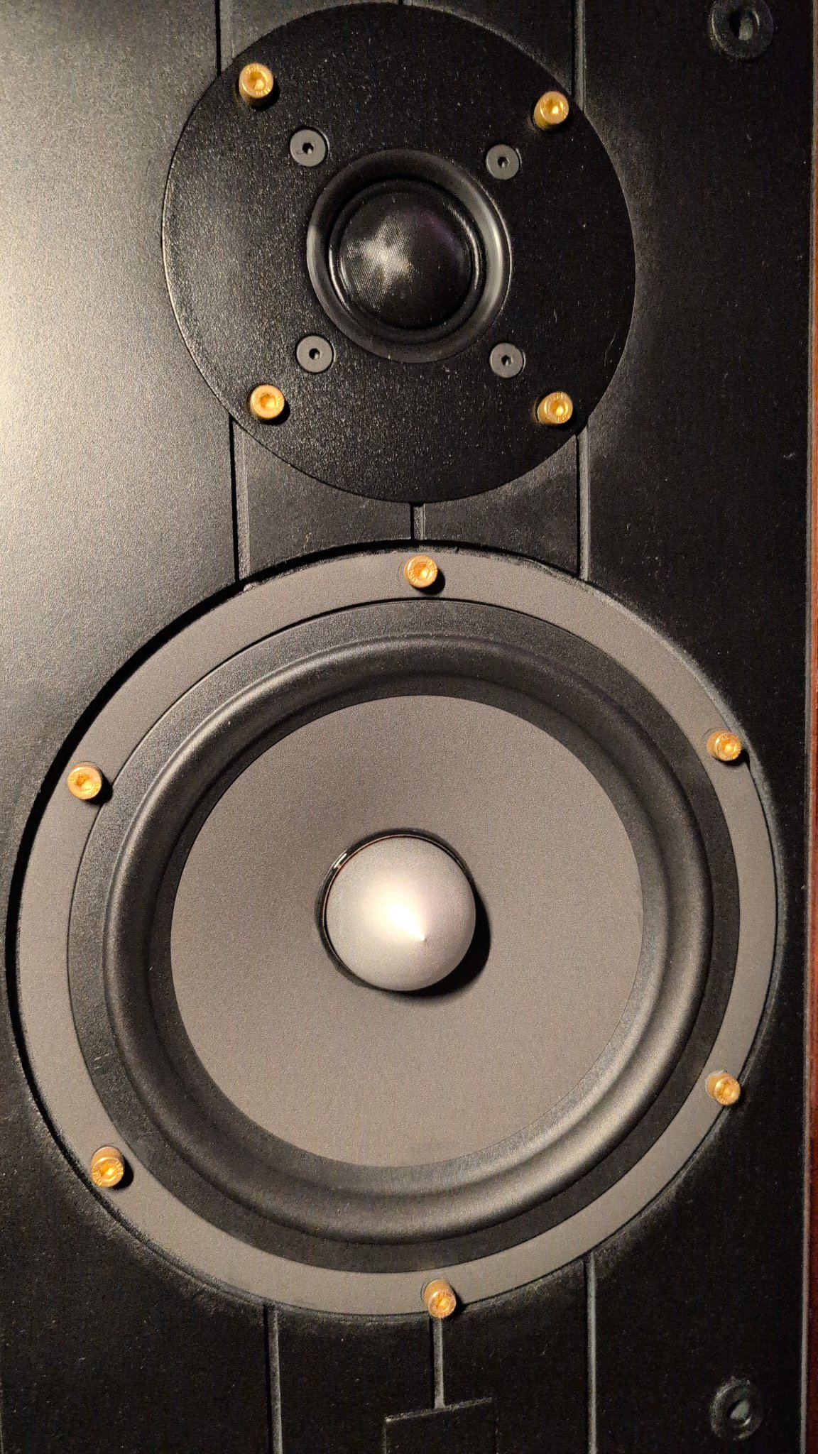

I've replaced both the tweeter and the woofer in my Ruark Equinox.
I'm now using:
Scan-Speak D2905/970000 'Classic'
SEAS E0042-08S (W18NX001) 'Excel'
They were the closest matches to the originals.

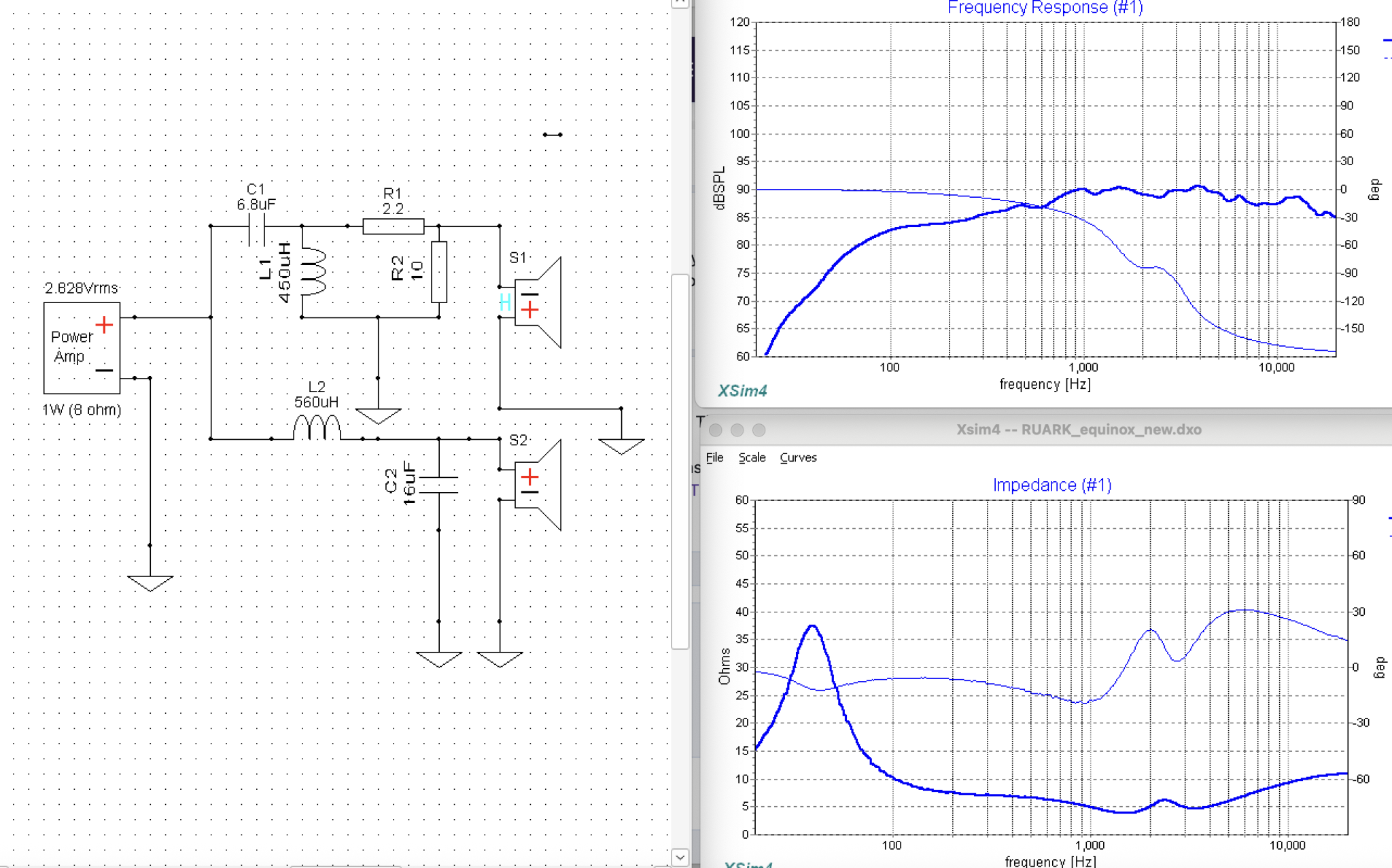

However, the W18NX001 drivers suggested in that thread are 8-ohm drivers, while the originals were 6 ohms.
I'd need to redesign the crossover to compensate the difference...
I will share the current design and would appreciate your input.
Also if anyone else has done this change on the equinox please share your experience
here the original crossover design : (I still need to measure the inductors to know their values...)
Then, I will see if I need to do something as I'm changing the tweeter and drivers to :
Scan-Speak D2905/970000 'Classic'.
Suggestion would be welcome.
but ideally, I would like to shift the Xover point to 3Khz..
I someone has any suggestions... without changing the impedance.. I would like to keep them for now, I'm fine to chnage the resistance and capacitors.

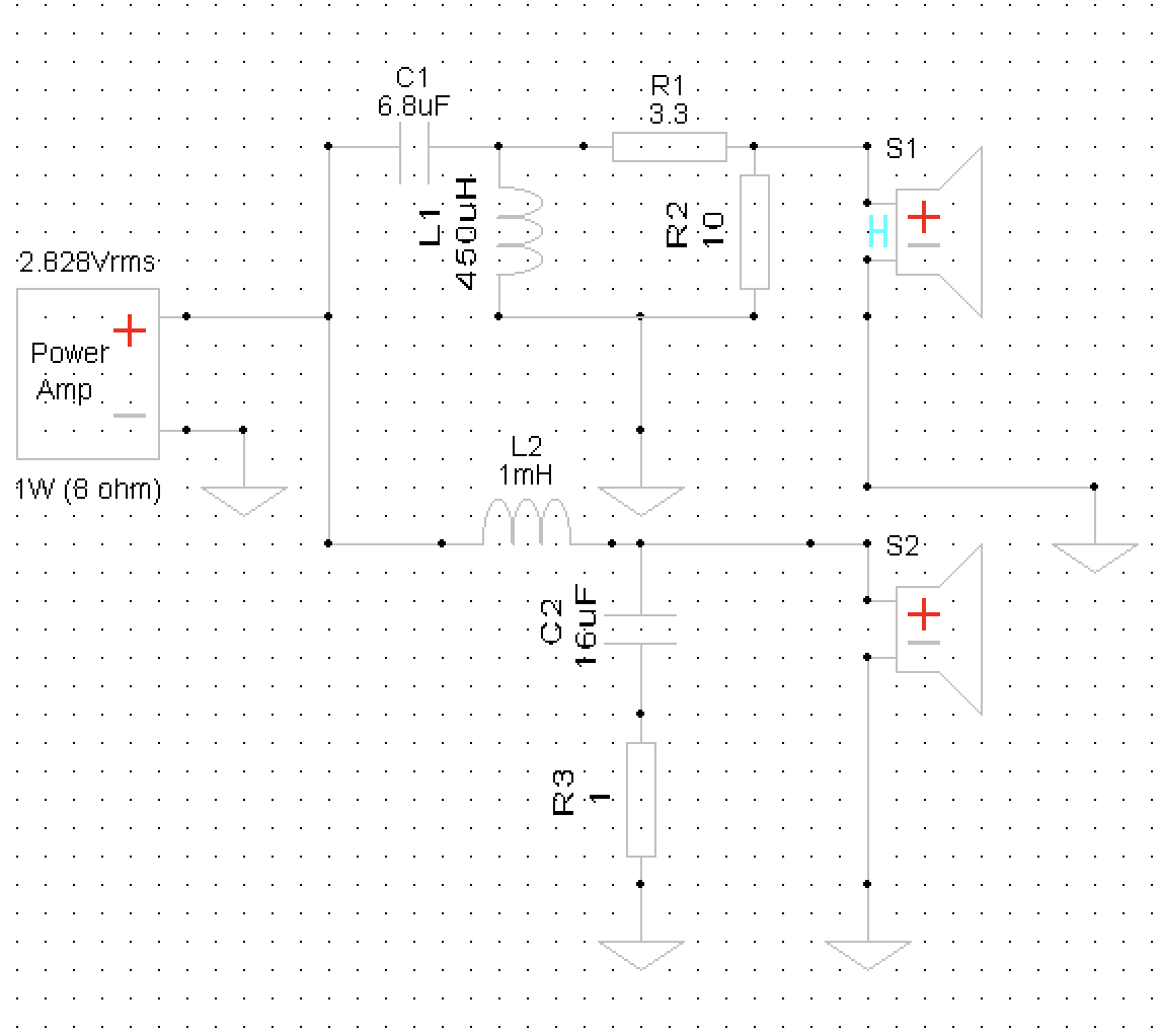

here are the XSim , FRD and ZMA files.

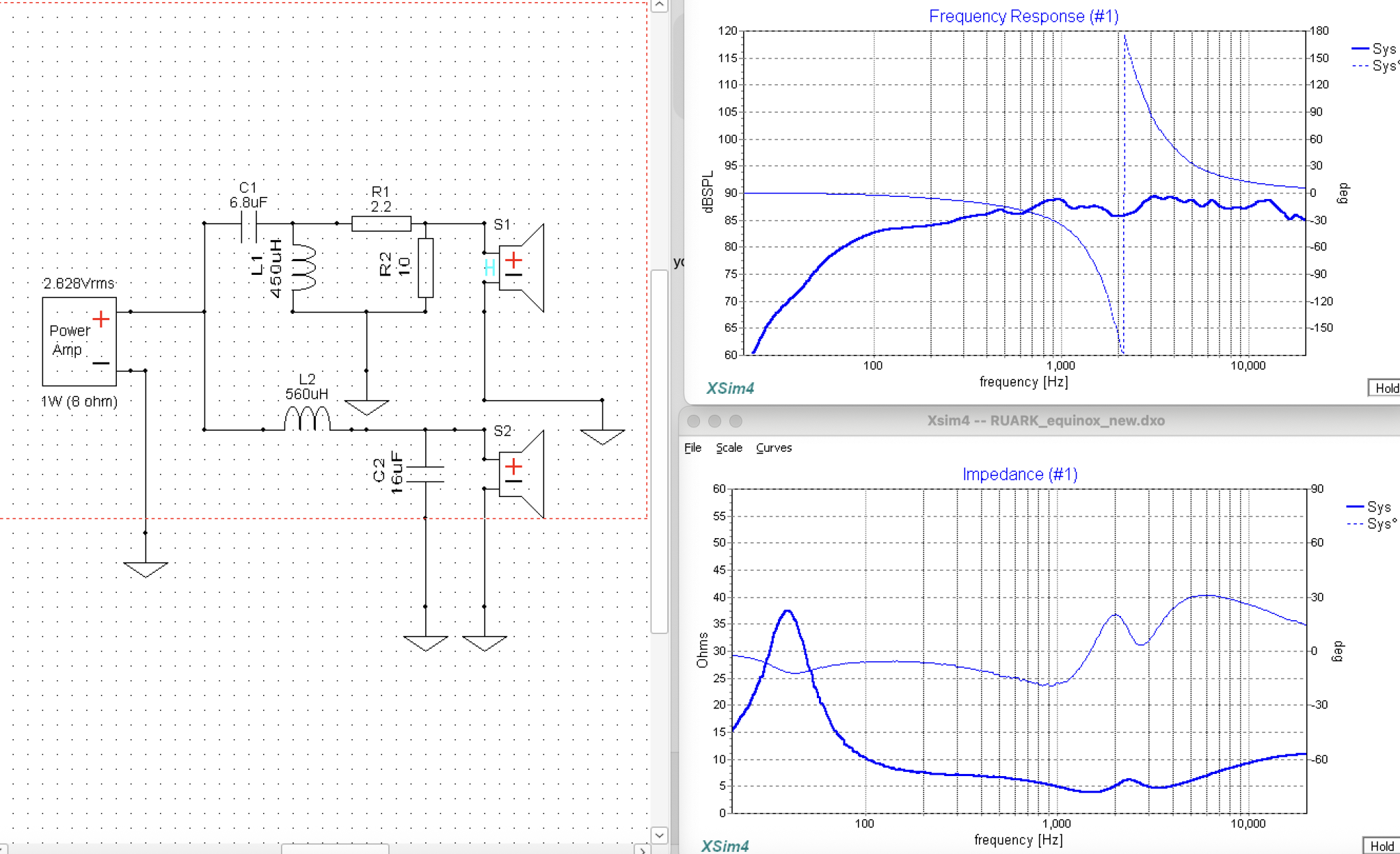

so I finally decided to:
1 .Remove the R3 resistor,
2. Replace the 1mH inductor (low pass) with a 560µH inductor.
I’ll run some tests over the next two weeks and keep you updated. If it works, I’ll likely invest in high-quality components for the crossover.
Try the woofer filter from this design as a starting point. That woofer is going to need a notch, and a larger coil.
Also, it helps very much to see the filtered driver responses. That is more revealing than showing the sum.
https://www.madisound.com/library/stacks/W18NX001_T25CF001.pdf
Yes, I saw that design... I see how it looks in XSim.. Keep you posted. Also I wanted to stay closed to the original RUARK design.
Thanks to both of you.
Sorry for the confusion. What I meant was to stick close to the original crossover, so I could make incremental changes and hear the differences.
But you are right, I should also consider other crossovers — we’re not talking about tons of components here.
I'm all new in this field, so I have quite to learn.
Indeed the word Design was wrong.
One element of the RUARK design (this time the speaker design, not the X-over design) is that the the crossover network is housed inside the heavy stand rather than the cabinet. the connection from the stand to the speaker is a speakon . the vibration inside the cabinet have no impact on the X-over.
For the rest, those speakers look good.
I'll be away for a week or so. More to follow in a week or two.

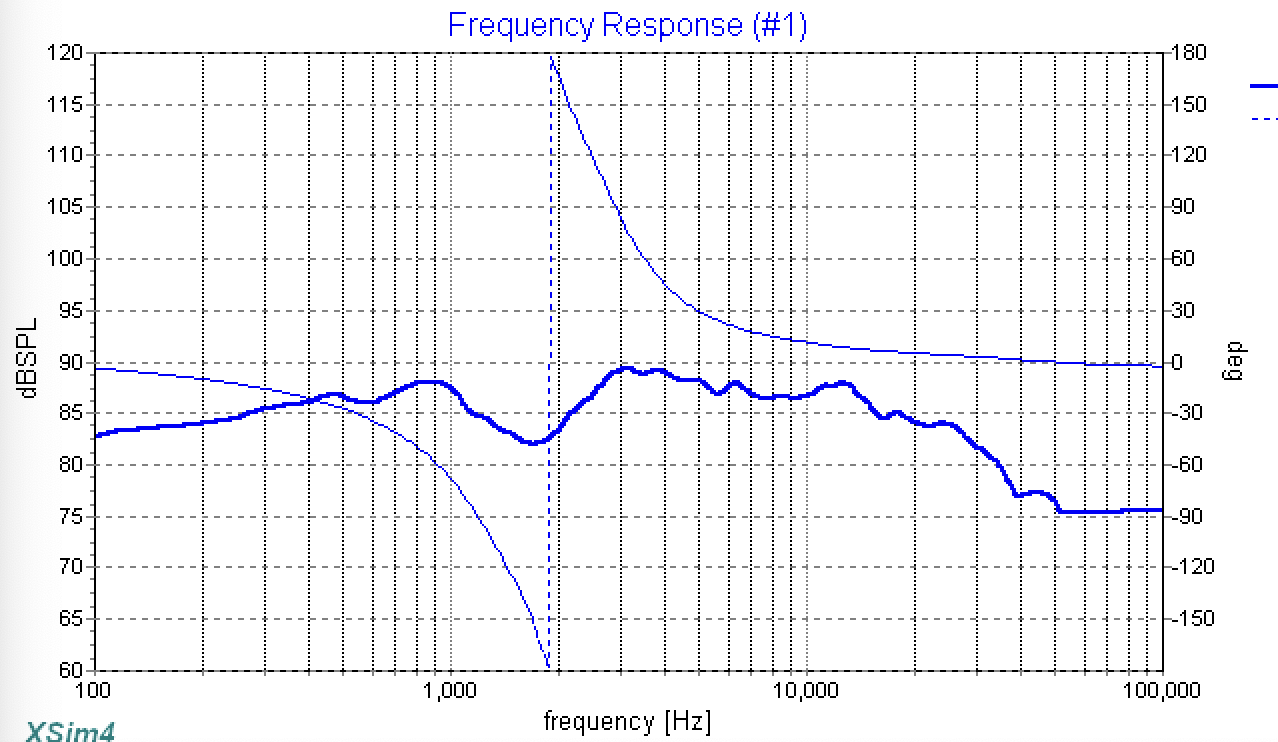

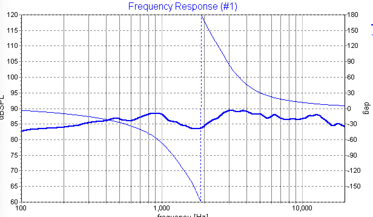

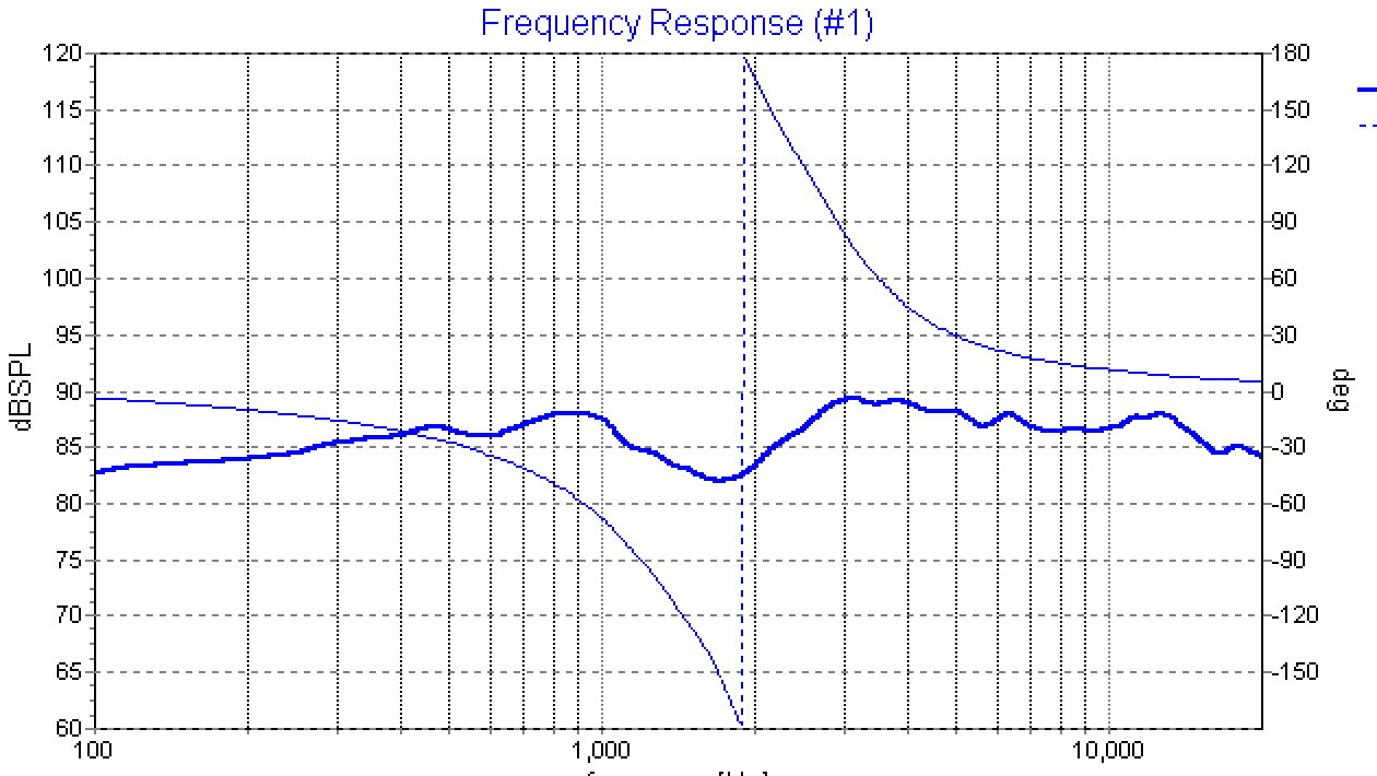

Take a look at your woofers raw measurements. There's a peak at high frequencies. That peak may not have been present with the original woofer. Part of the x-overs job is to correct things like that. You can sim a notch, and add it to your x-over. That should produce a substantial quality improvement.
I need to review my speaker raw measurement, you are 100% right. I've already noticed that the tweeter ima file was incorrect.... here the new one.
Now taking this in consideration and inverting the tweeter, I get already decent values with the original Xcross over. I need to look cat how it is wired, I have probably didn't wired it how it was originally.
