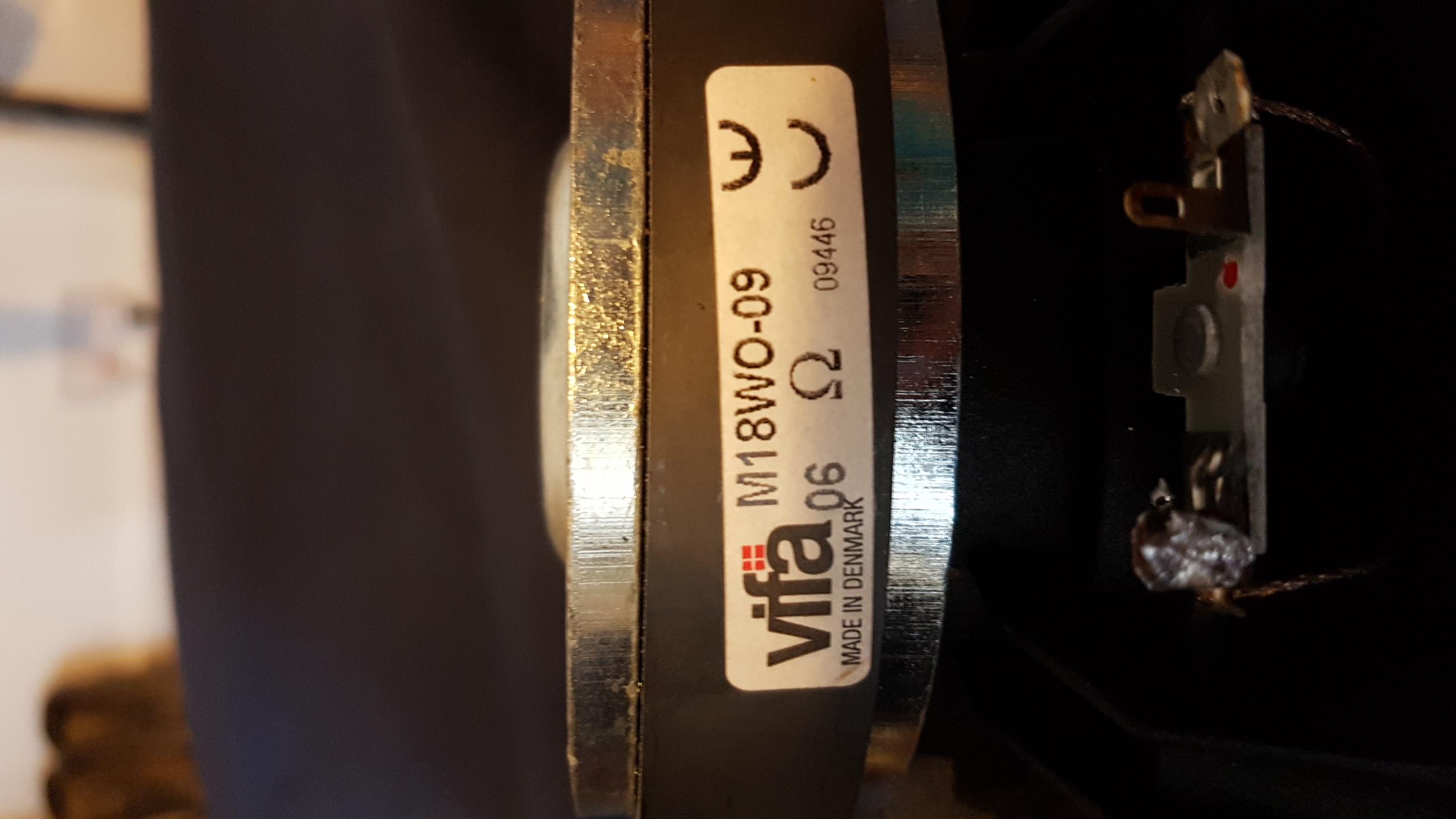

Hi all,
Saw a good deal on some Ruark speakers, was very happy with the great price I'd got, got them out of the car, picked on up by the rear port, plastic insert slipped out and the front of the speaker smashed on the tarmac. Luckily most of the speaker was saved by the proud cap head screws. Now the cabinets were a bit tatty anyway and I saw them as a bit of a project anyway so wasn't hugely bothered.
However, put them on and found the mid/bass woofer doesnt work... that is an issue.
It seems from my experimenting that the voice coil has come away from the diaphragm and from calling about fixing this isn't something many people are willing to attempt anymore. Unfortunately its a 6ohm driver and as a result replacements aren't exactly easy.
I found someone who actually would like to buy the other driver and since it looks like finding my own spare is next to impossible Im thinking it would be a good idea to cut my losses and sell it leaving me with 2 tweeters and a cab with a crossover which isn't exactly all that useful.

- The tweeter is marked as: Ruark Solus MDT 25S by Morel (believe hifi collective actually sell this.
- The driver in question is: Vifa M18WO-09 (6 ohm version) (falcon acoustics actually sell the 8ohm version but its not cheap)
- The enclosure is the Ruark CL20, seems well made, dimensions are 300x300x930 mm with a slight lean back and an interesting sort of curved mdf bracing around the outside but only on the section with the speakers installed

Have you measured it? Look at the voicecoil resistance. Should be 5.8R for the 8 ohm version.

Maybe Ruark had that version made for them, or he got a good deal on a batch of 6 ohm variants.
The difference from 6 to an 8 ohm version is not going to be big, it would probably need the designer or a skilled listener to know you had changed the impedance.

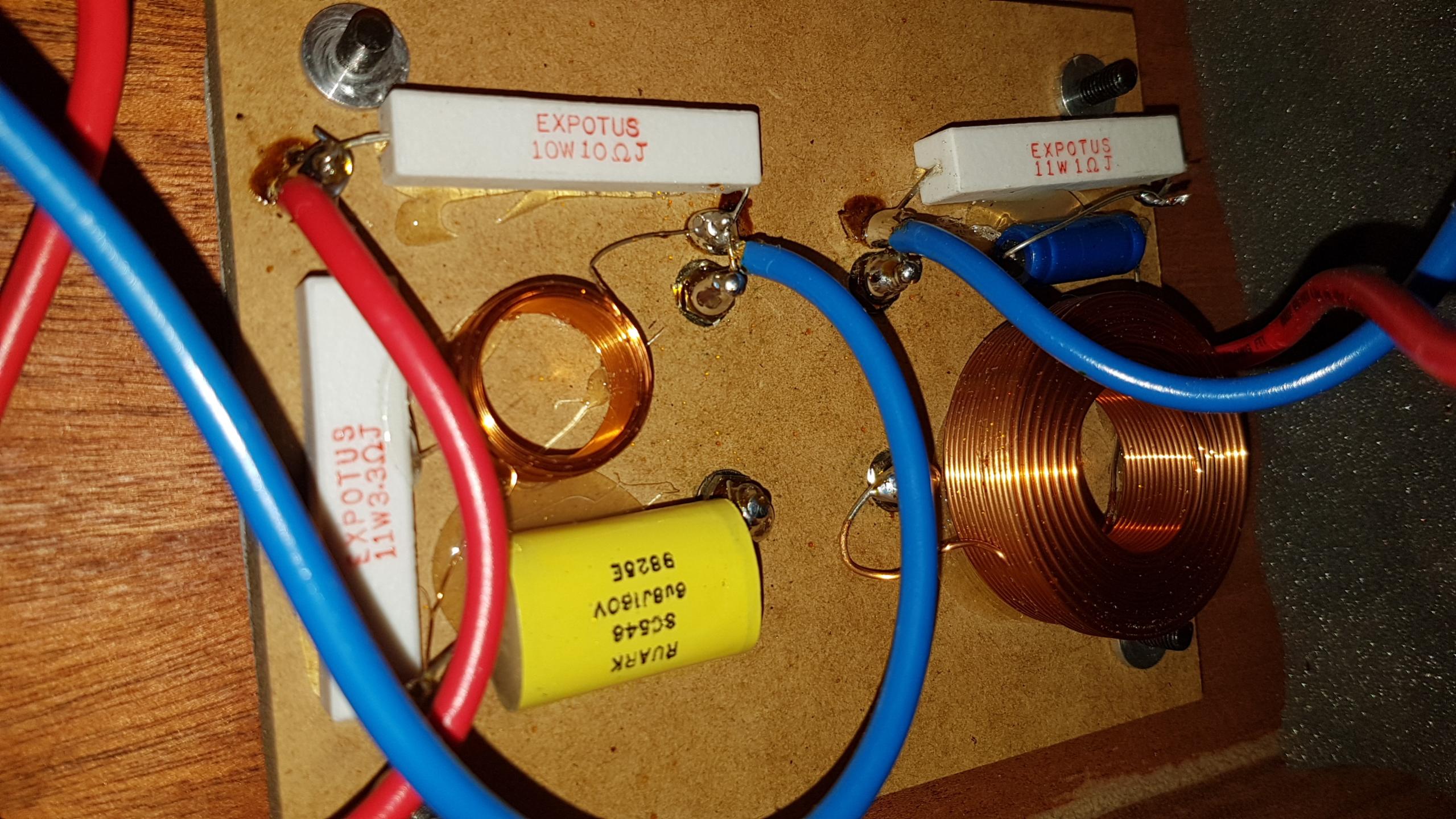

In fact can you get a image of the crossover or write down any values you can read.
That could help us advise you if you need to tweak the treble level.

The type number indicates it was a standard unit, but the 8Ohm versions were more common. Have you examined the Seas H1215 or H1217? Slightly smaller basket, about the same Le (I think) and slightly higher Rdc.Maybe Ruark had that version made for them
Looking at the image I guess that there is an L pad on the tweeter side, so a dB or two there wouldn't be to difficult to achieve without upsetting the general tweeter overall response shape.
