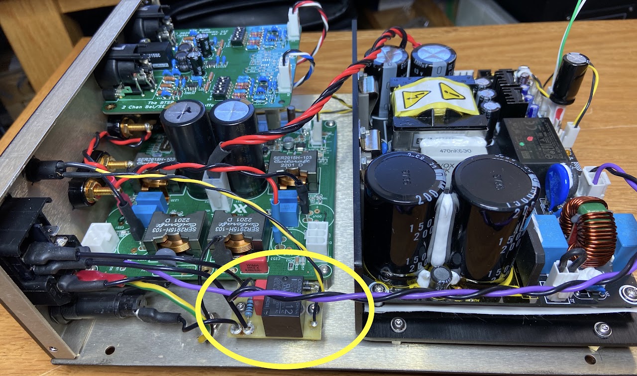

I thought you were referring to the SSR as connected to the SMPS situation as shown a few posts above. If you are referring to Mikebarney’s use of a mains relay to control power on/off of the SMPS 630SO, I think that may or may not work since the tpa3255 15v rail just needs to stay up longer than the HV rail to prevent thump. I do think it would be wiser to use a 12v external signal and relay to activate the “STDBY” logic pin for graceful shutdown.
No I have a pair of your RTR speaker protectors in a case I am repurposing for the Wolverine with Sami’s Cobra S2 power supply. I will be putting out multiple amps in my living room and was thinking of using a selector switch to control SSR’s for powering the selected amp.

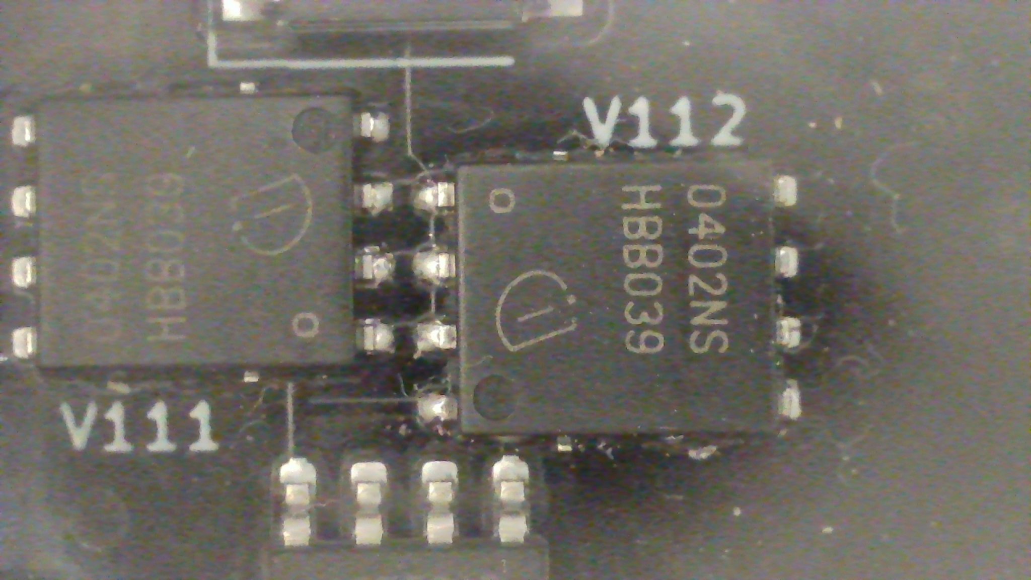

Hi X. it's been a while. I have an unused pair of your version 2.1 speaker protection boards - I'll need to remind myself of how to implement them and find the bonus low-cap PS boards, which seem to have gone walkies, but fundamental question first - are V2.1 boards OK to use in an amp with +/-150VDC power rails? I'm not sure when you switched to using the 150V mosfets and a search hasn't provided the answer yet. Cheers.
150V 80A MOSFET from Infineon.
https://www.infineon.com/dgdl/Infin...N.pdf?fileId=5546d462700c0ae6017015d4682a2212
Looks like you are ok for using it on 150Vpp or 53Vrms 350W into 8ohm amp.

The +/-150v supply means it is a 300Vpp application and the MOSFETs cannot take that. Jhofland, the designer said he wouldn’t recommend it.

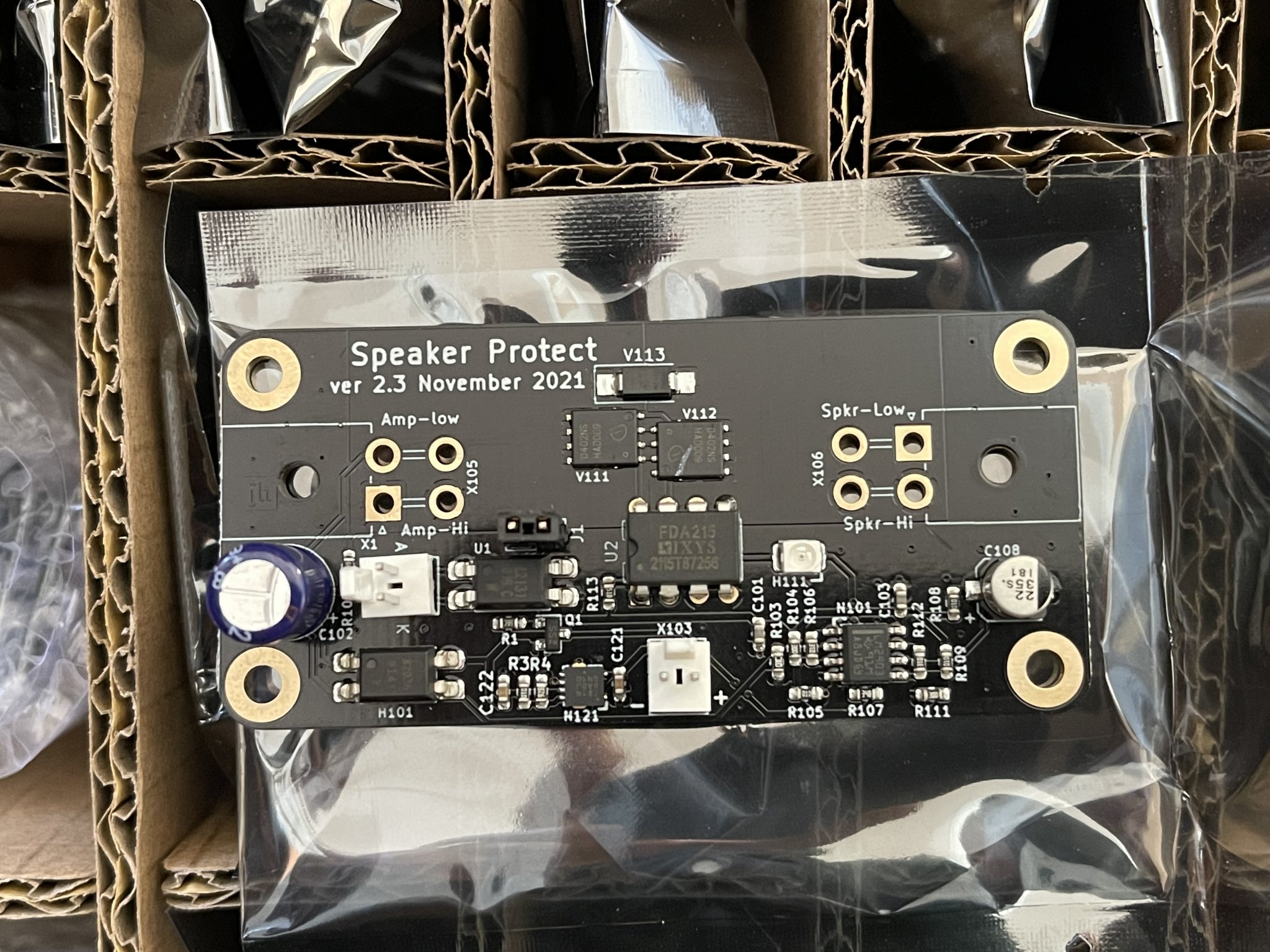

Hi X
I am confused
i have the SSR board in my hand with V2.3 November 2021. But you write at the beginning of the new version v2.2 and 18.November 2022.
please clarify
thx
Chris
I am confused
please clarify
thx
Chris
