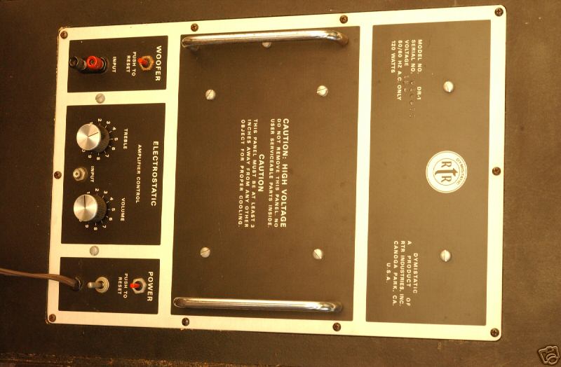

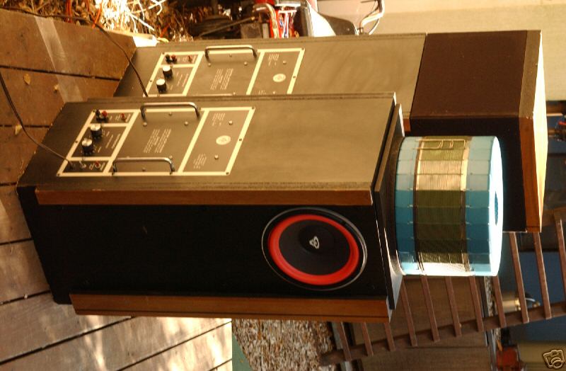

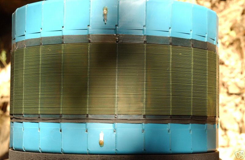

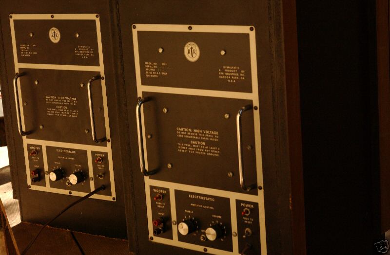

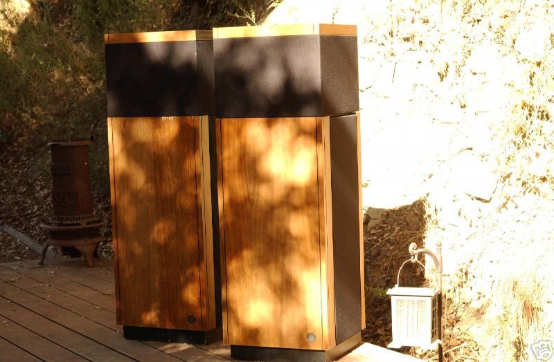

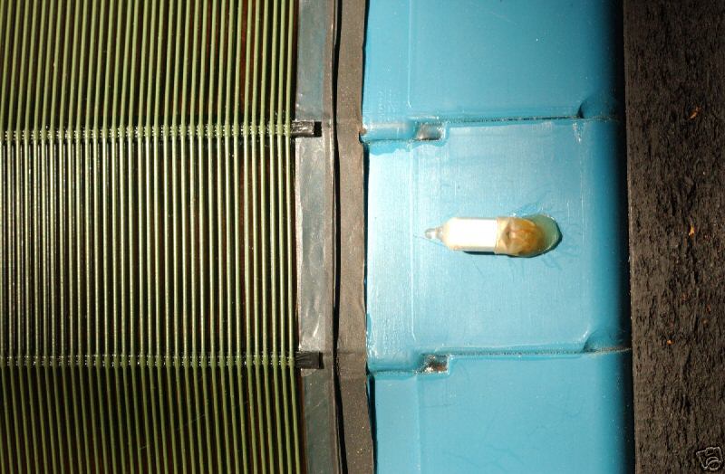

rtr dr-1 speaker

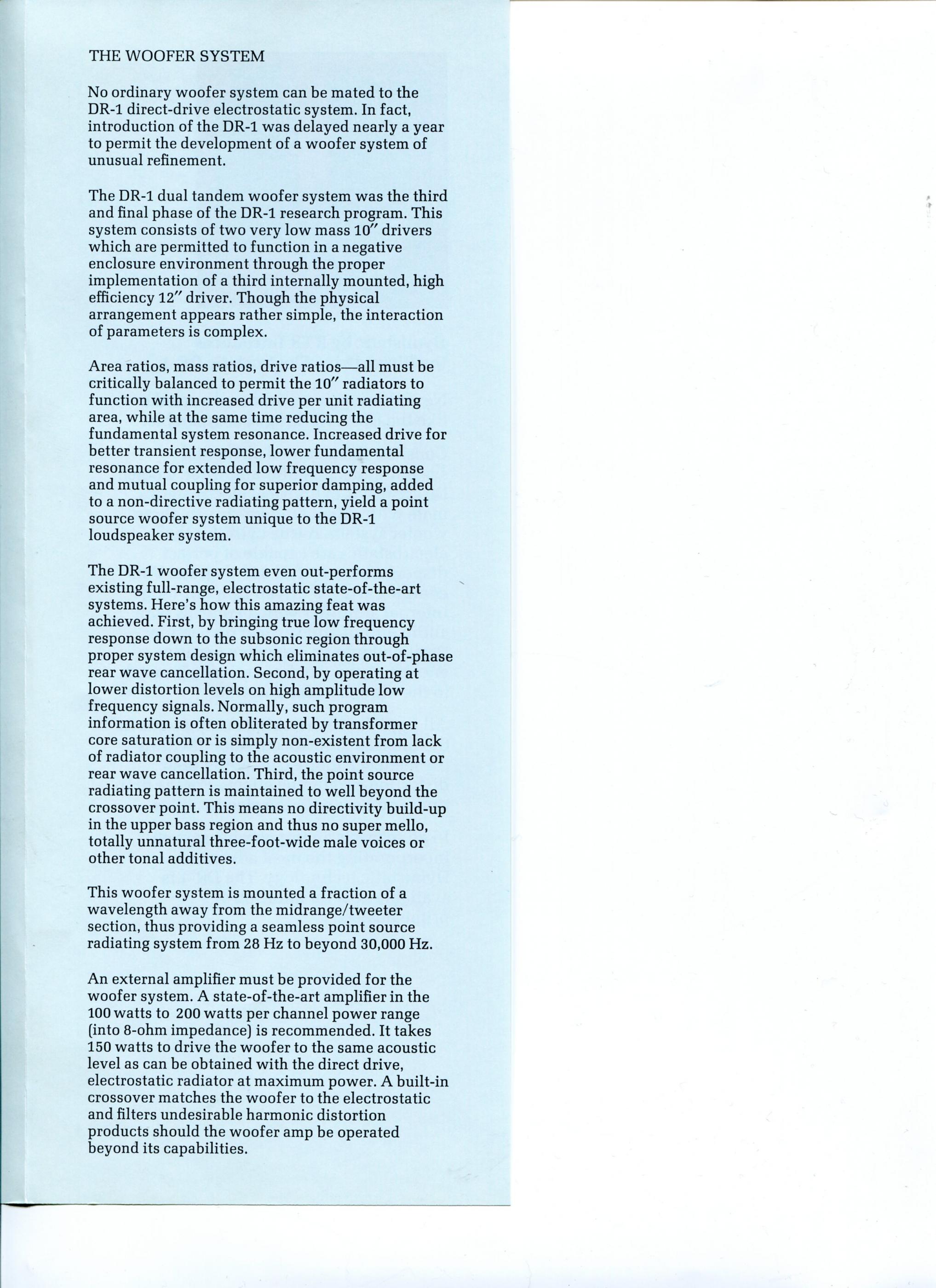

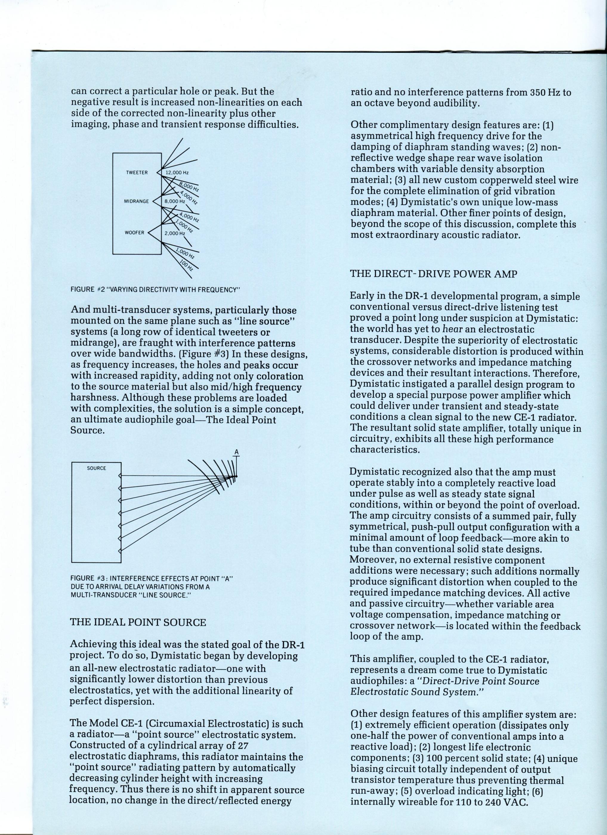

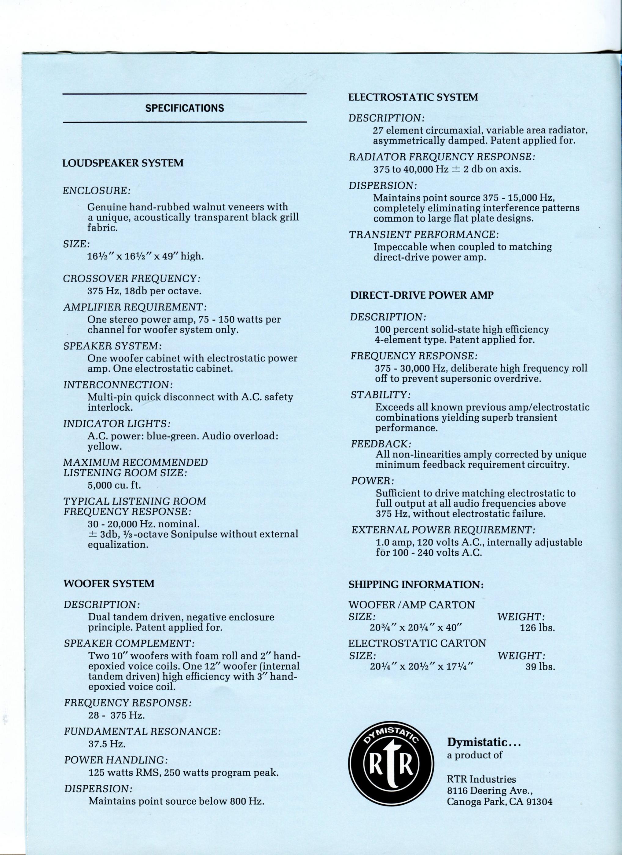

i collect exotic speakers and have 2 pairs of dr-1 speakers.
the dr-1 is not like the former rtr panels hf 150,hf 100, hf50
seen in most speakers like the crown,or infinity wilson wham or fulton j,or rtrs own esr-6 and 15
the 27 panels are made as one unit and cannot be separated into stand alone panels
each panel `s rear radiation is absorbed into a foam wedge, the center of the panel is segmented for higher frequency's
the direct amp is not class g but a combo of lower turns wide bandwidth transformer
and a voltage amplifier
i have the schematics of the amp
i will post pictures tomorrow.

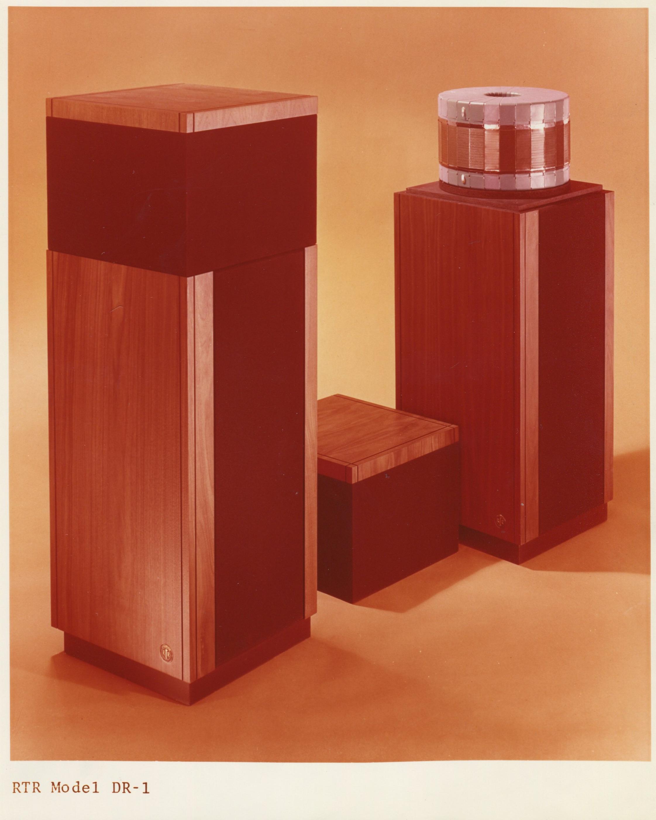

DR-1
There's a few out in your neck of the woods, I received 2 pair from different owners from your state, James
