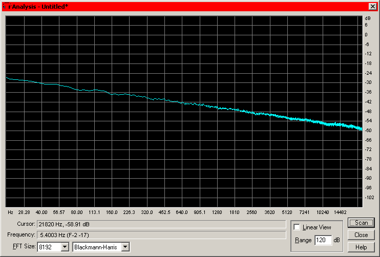

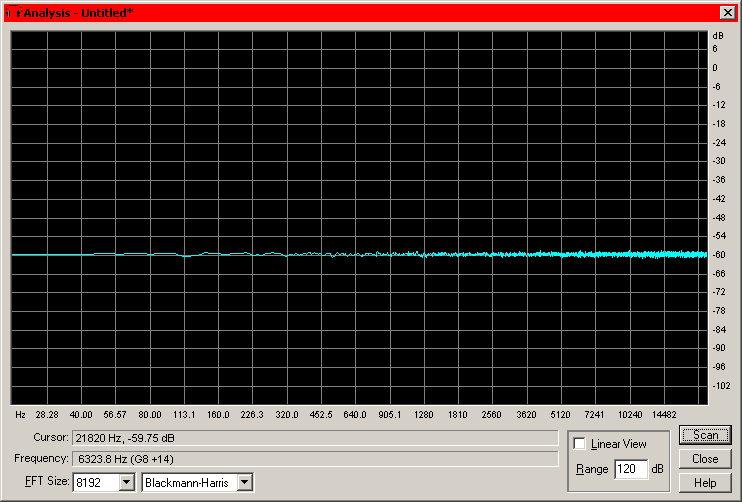

Basically, white noise has equal energy per Hertz, so if you measure it with a moving filter of constant bandwidth (300Hz, 1kHz or whatever), you will measure it as flat. This is how spectrum analysers measure a signal.
Pink noise has equal energy per octave (or fractional octave), so if you measure this with a constant bandwidth filter, (like an SA), then you'll see a response that falls of at 3dB per octave. On the other hand, if you measure pink noise with an RTA, which measures in octave chunks of the spectrum (or 1/3 or 1/12th octave as required: ie, the bandwidth of the filter increases as the frequency rises), then you measure pink noise as flat.
Your pictures show an FFT-based spectrum analyzer, which will show the same results (more or less) as a conventional filter-based SA, therefore it shows white noise as flat. You are quite correct in saying that if you used this noise as the source for an analyser that measures in 1/3rd octave bands (or whatever fraction of an octave you want to use), then it will show a 3dB per octave (or to be pedantic, a 10dB per decade) rise in response. To show a flat response on such an analyser when measuring a flat system (like a perfect amplifier, or the mythical 'straight wire with gain') then you need to use pink noise as a source.
There's nothing to stop you using wideband pink noise as a source to measure the whole 20Hz to 20kHz in one go if you have a suitable wideband pink noise source and an RTA that covers the whole band (like TrueRTA does).
