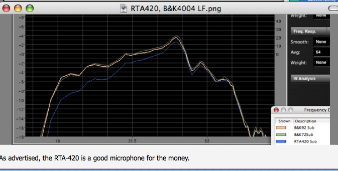

The SIA RTA-420 is a good cheap mic, I bought one used from Harry Brill of Tiger Audio,he sells them new too. Unit to unit variation is always a problem, even for expensive mics, but the RTA-420 is certainly good for the price.
The same element is used on several other test mics costing more than the RTA-420.
I have a pair of very expensive test mics, B&K 4004, some info about the RTA-420 compared here:
PSW Sound Reinforcement Forums: LAB: The Classic Live Audio Board => Testing the Test Microphone
The picture below shows the RTA-420 is 4 dB down at 16 Hz from the 4004s, the test source obviously is not flat, but both mics were placed as close as possible to the same position.
The B&K 4004 came with an individual test sheets, they are (were) +/- 2dB from 10 Hz -40 KHZ.
The B&Ks have hardly left the mic locker since getting the RTA-420, if I have a speaker that produces anything much below 30 Hz I can just refer to the comparison and add a few dB appropriately.

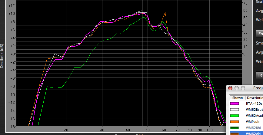

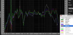

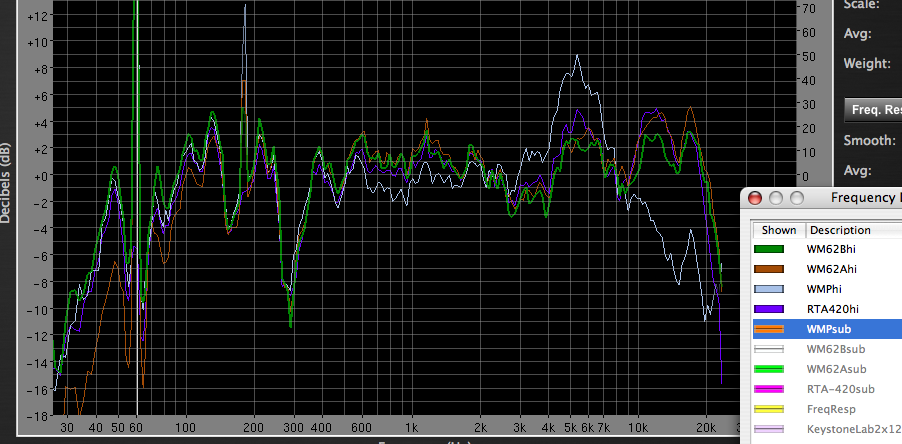

Back in the winter of 1999 I built some microphones like lilmike., housed them in male XLR shells.
I first used an electret mic element from a telephone, I was amazed that it had far flatter response than I expected.
Then I ordered several Panasonic elements, the pair of WM62 and a phone unit are compared to the RTA-420 below.
The phone unit has a midrange boost and HF rolloff.
One of the WM62 “A” has a reduced LF, even though the upper response matches the RTA-420 pretty well, and seems to be picking up 60Hz and harmonics.

I suspect most of these cheaper mics probably use the same elements anyway, the (working) Panasonic WM62 is almost a direct overlay of the SIA RTA-420.
