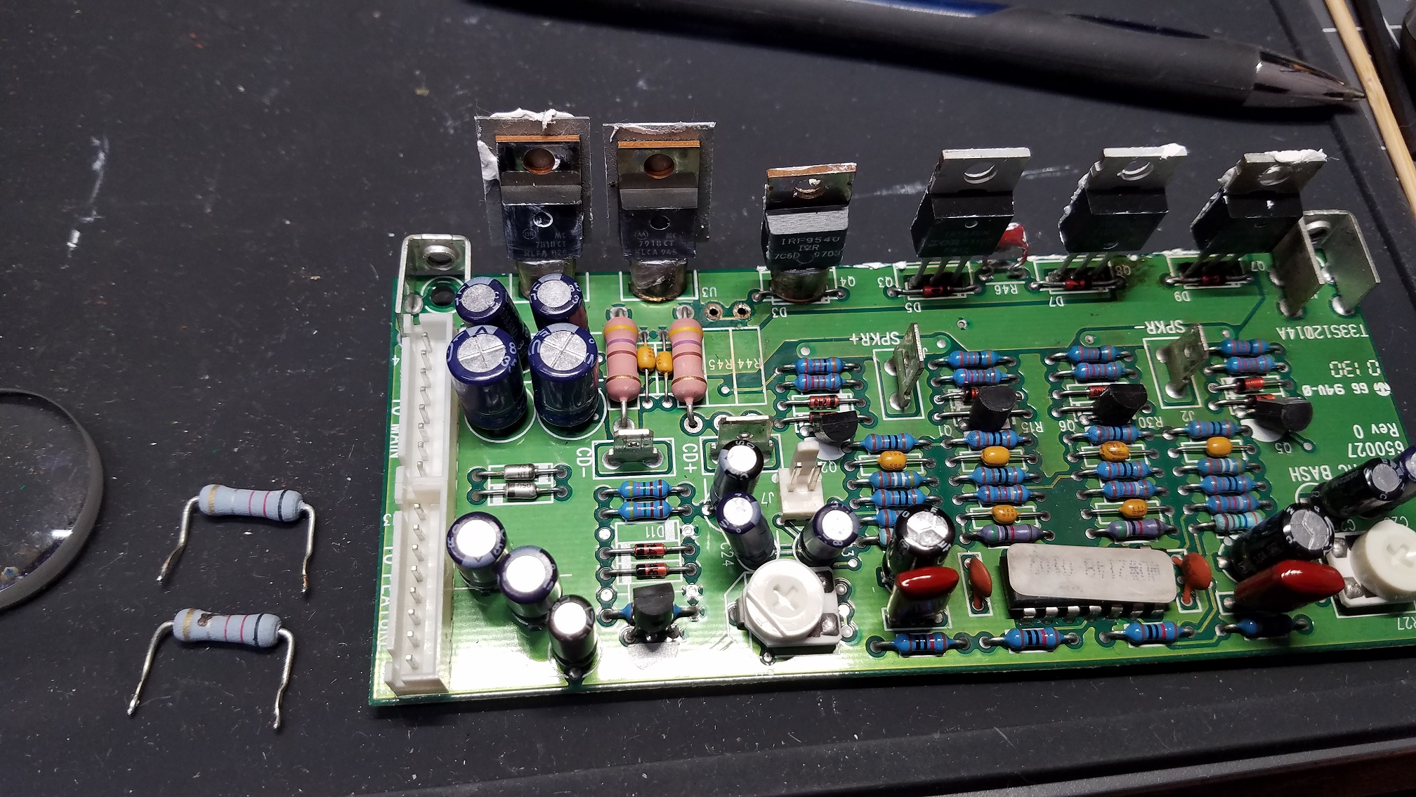

RSW-10 PLATE SERIAL ???
First up we have a RSW-10 and this one already is a challenge, because someone was already inside and changed parts. I have 2 burnt resistors that look to be replaced and might not be the correct value. R44 and R45 on the amp board. I also see that 3 fets were replaced. I need to confirm that Q7 should be an IRF640 and not a IRF530. The amp board is 650027 and it appears that SVS used this same amp in the 20-39PC. Oddly enough the Infinity IL60 uses the same amp board so I should be able to get a good parts reference from that. More to come tomorrow, I'm tired.
Update:1/18/20
I replaced the fets and have the resistors on order. The resistors are .1ohm 2W Wire Wound

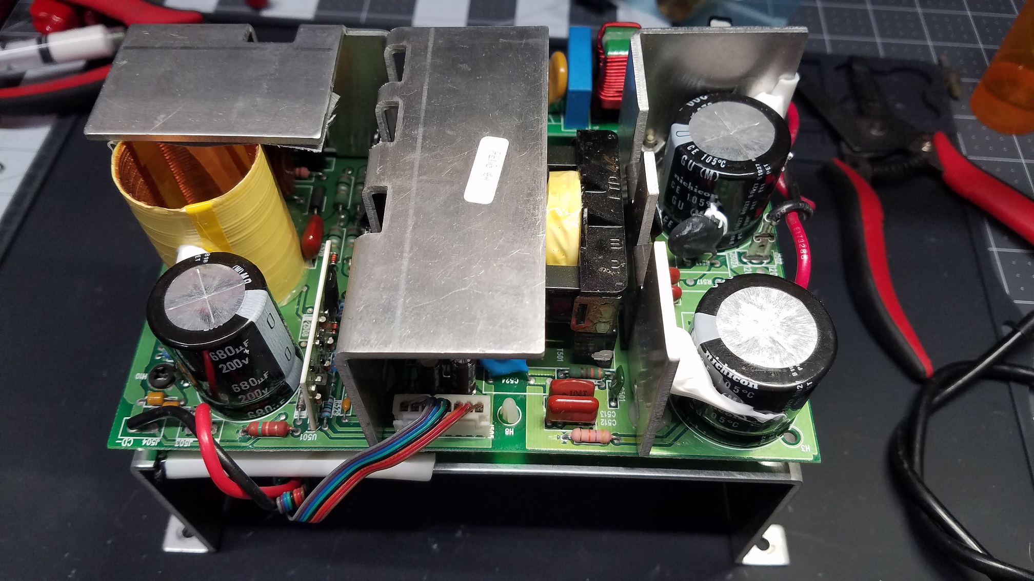

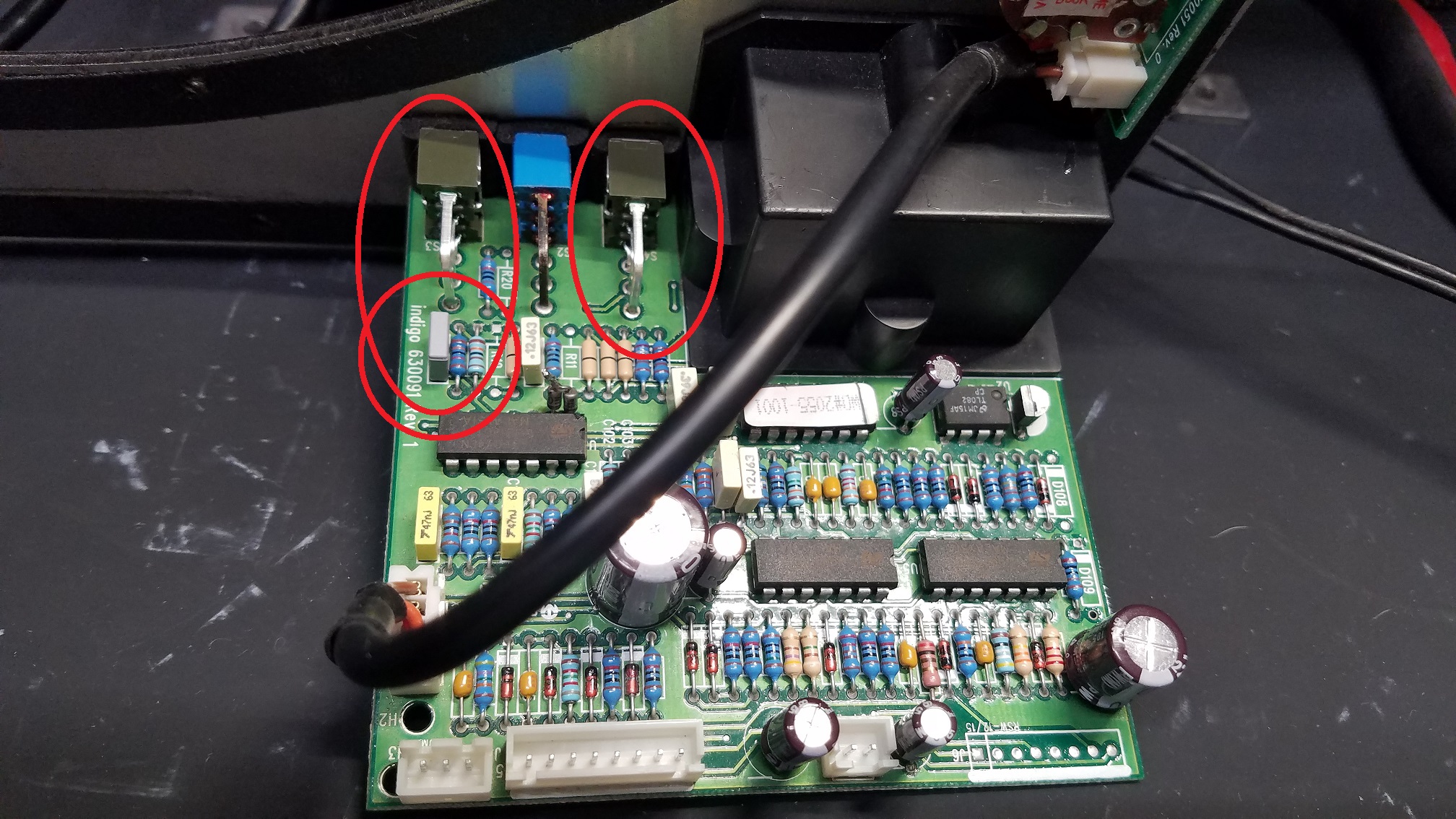

Finally found all the issues and completed this one. Full recap and repair. As well as the replaced parts not being correct, a film cap in the audio path was bad and 2 switches needed to be replaced.

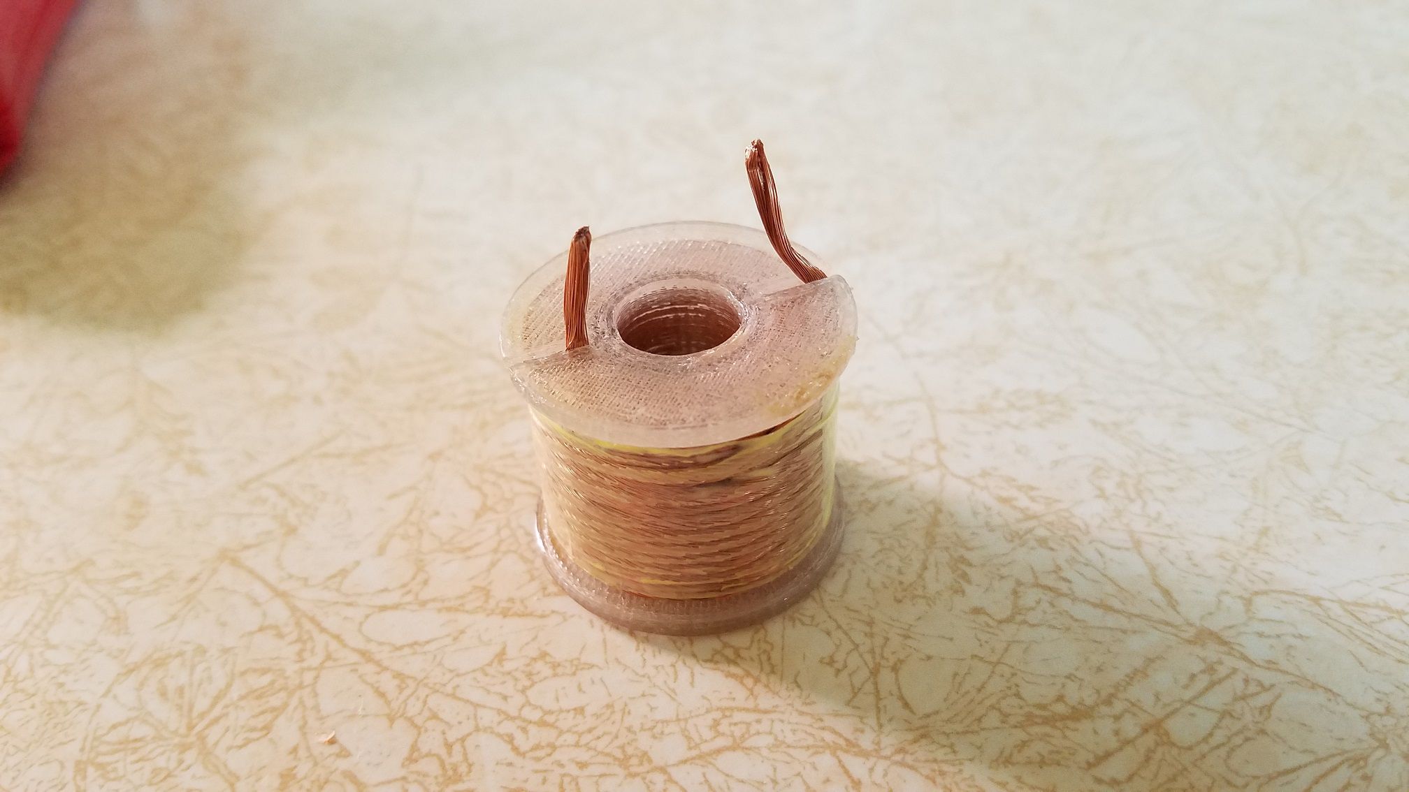

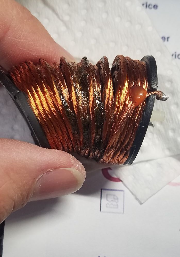

This is one that separates the men from the boys. This amp came to me a complete mess. It successfully achieved meltdown. The inductor on the secondary power supply overheated and was destroyed. I took some measurements, ordered the special LITZ wire and 3D printed a new bobbin for the coil. I then vacuum potted the coil with thinned polyurethane and let it air dry for a week. I still need to do more repairs on the amp, It has shorted fets and outputs and all sorts of other issues, but here is a teaser for this one.
One thing I learned, is definitely to tin the leads before starting the winding and before potting. It was not easy at all to clean them as they wicked up the poly.
