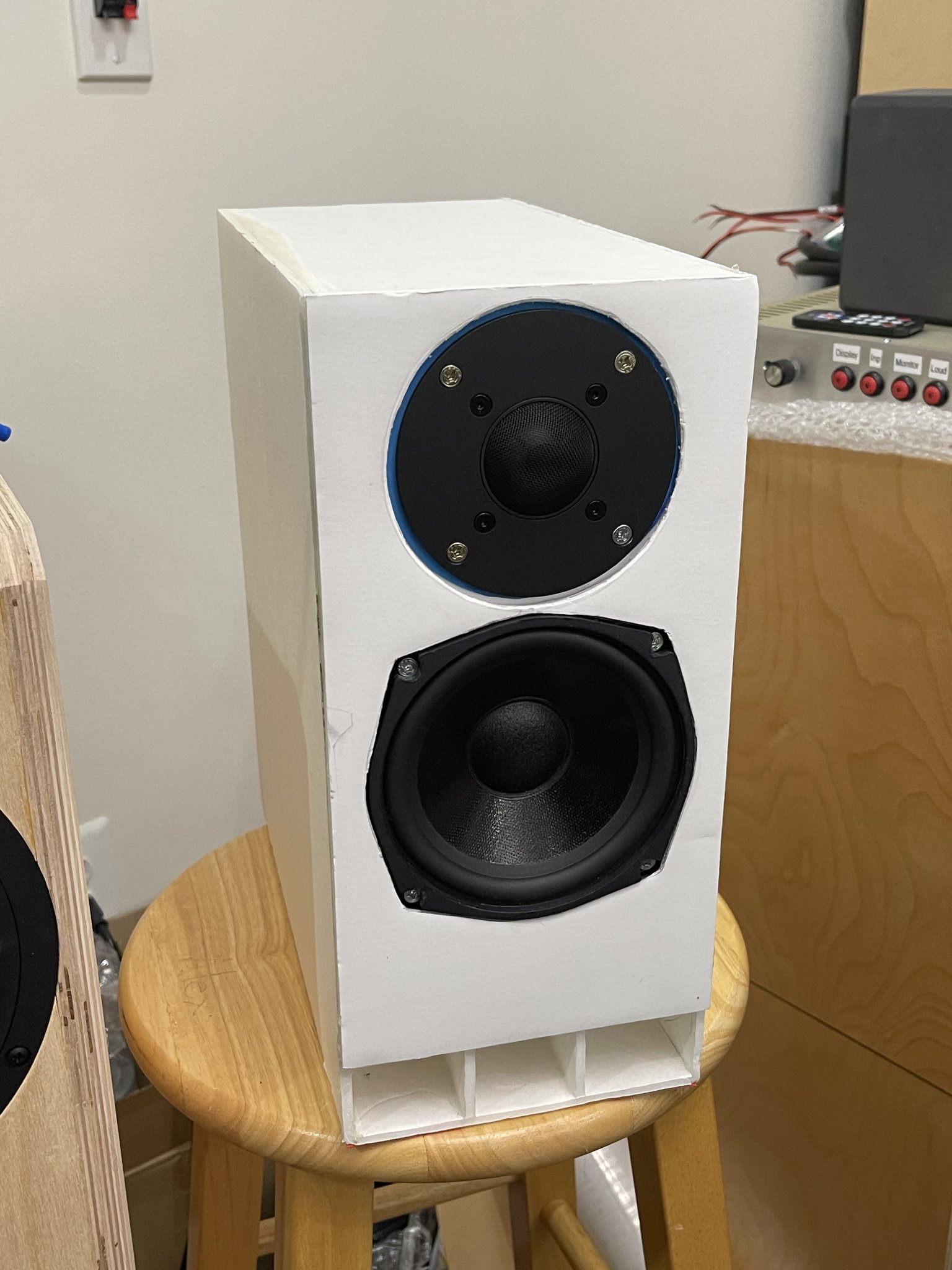

A nice TL version of this speaker by jmascreen.
From plans I posted on this thread:

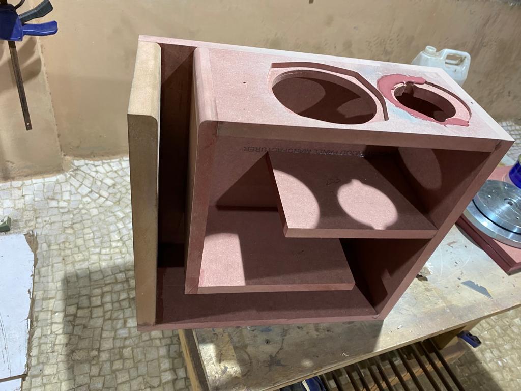

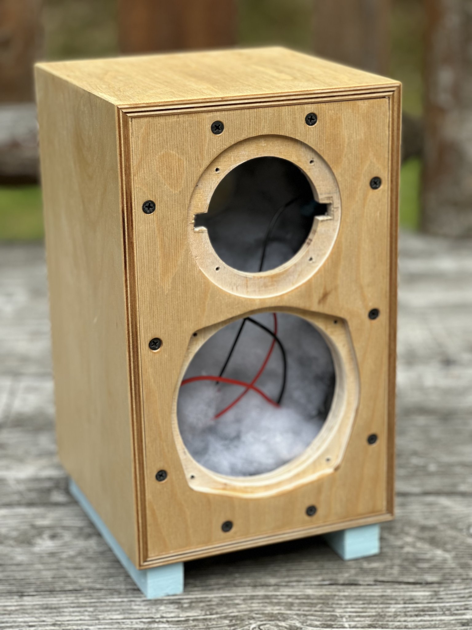

Finally made some cuts today for the Vanguard's I've been planning on making. I bought some BB cutoffs from an industrial workshop (they make PA speaker cabinets), 11.5"x60" pieces of 12mm Baltic birch for 8 bucks a sheet!
I think I got a heck of a deal, but those dimensions are a bit unfortunate.. it gets even worse though, because I used all of the sheets I bought on another project, so for the Vanguard's I have to use the cutoffs of my cutoffs!
It worked out mostly okay, but unfortunately I have to make the baffles and the backsides with the grain going horizontally... Will probably look wonky as heck, but oh well. I can always just paint the baffle black, but the back panel will stay unpainted.. good thing it's on the back 🙂

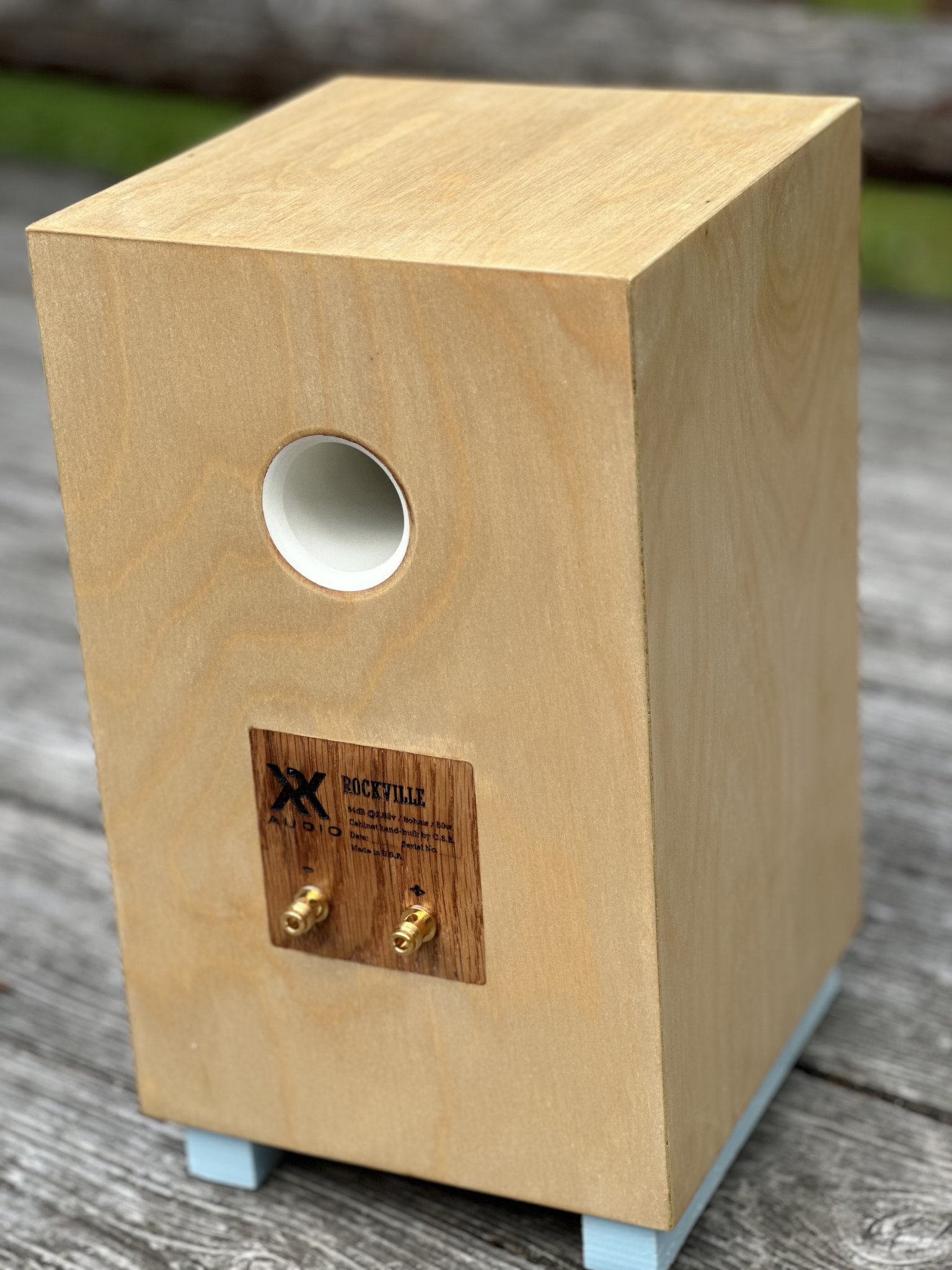

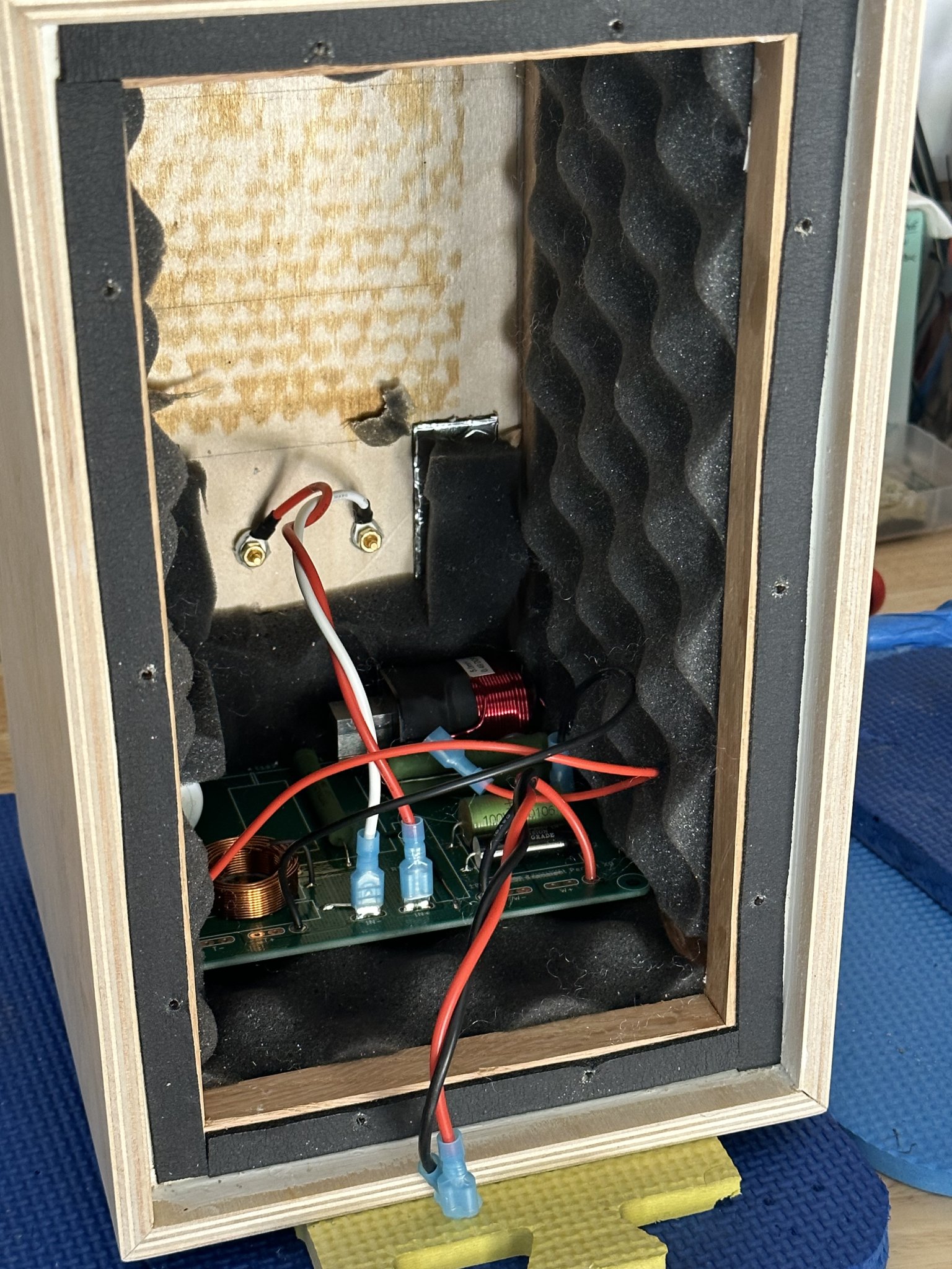

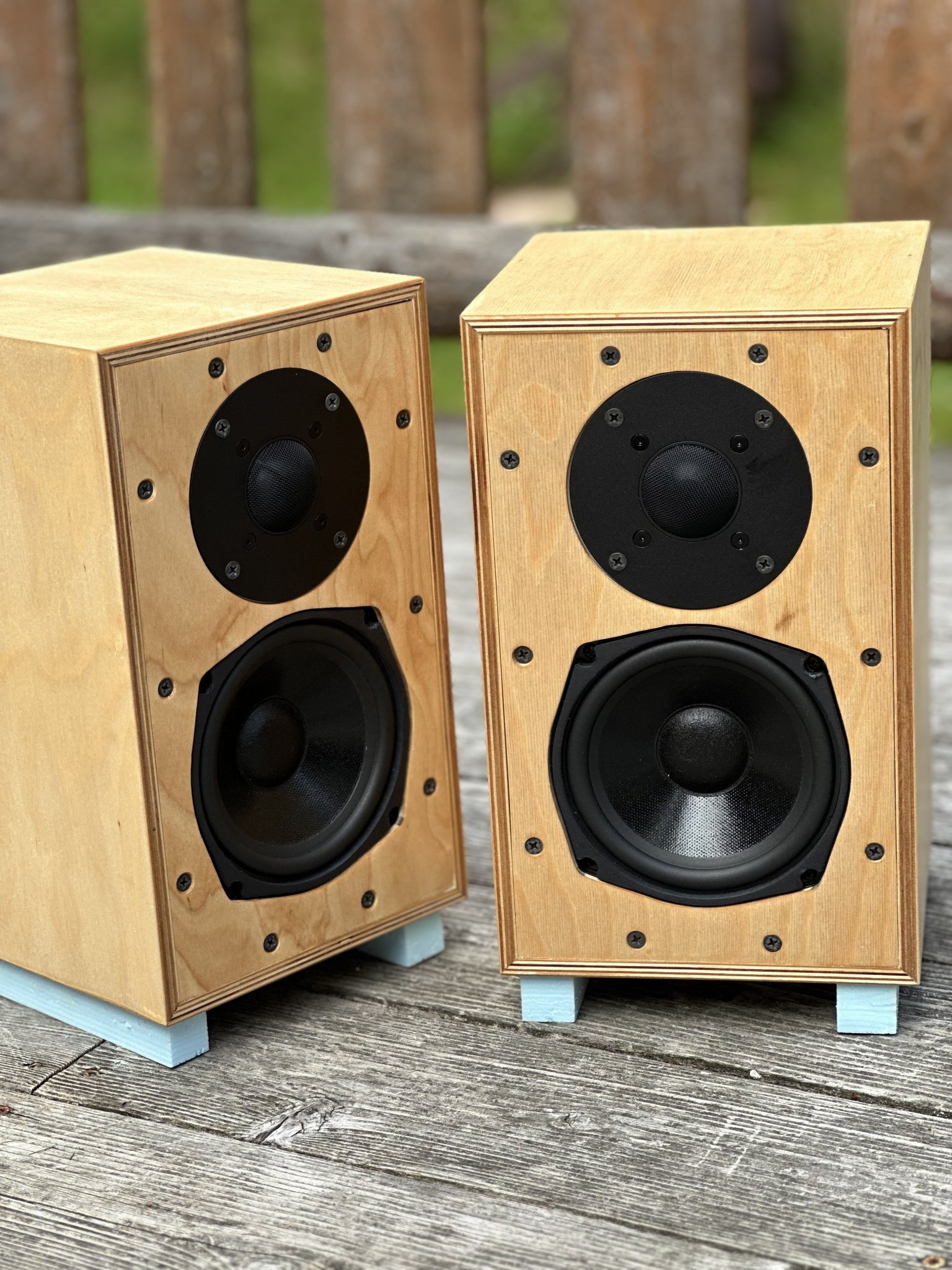

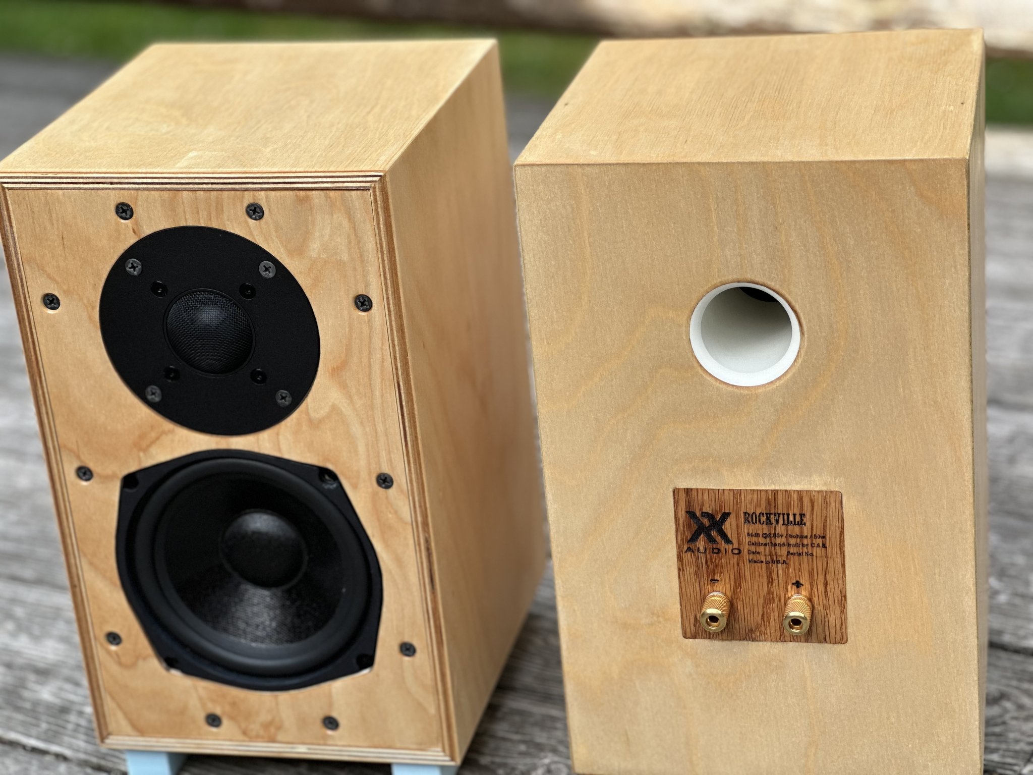

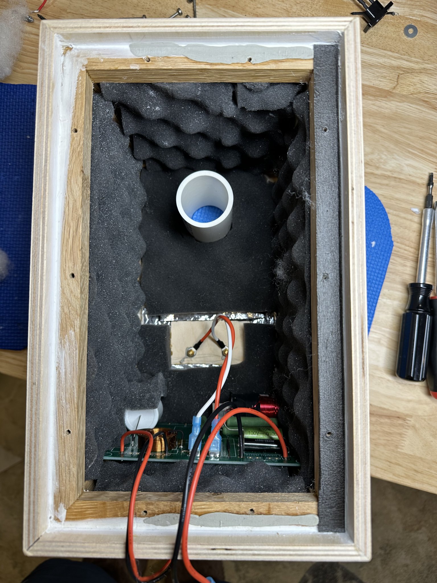

I just finished a modification to my Rockvilles (aka Vanguards) that might interest you....
I built these speakers a few years ago when X had a small batch of cabinets built. The speakers sound very good in the mid and highs but I need a bit more oomph in the bottom end to enjoy the music I listen to. So they were set aside and not used. Recently I've been looking for a small speaker to use at my workbench area and wondered if adding a rear port to the Rockvilles would be worthwhile. I asked X and a mutual friend about this thought and within the evening we had a plan to add a 38mm x 80mm port directly behind the tweeter. Checked the plumbing section in my garage and had a perfect section of 1.5"ID PVC pipe, time to get busy! Fast forward one week, mod is complete with final port length of 90mm, and cabs finally got sanded with multiple coats of tung oil and final buff with 2000 grit sand paper. Smooth as silk.
IMO, this modification saved the Rockvilles from becoming a listing on the Swap Meet. Very noticeable improvement to my ears, fuller sound without ruining the midrange. 🙂
Here are some basic measurements taken:
Frequency generator and Radio Shack SPL meter
..........Stock - Ported
70Hz - 77dB - 77dB
60Hz - 68dB - 76dB
50Hz - 65dB - 74dB

Wow, those are impressive figures. I actually have a pair of flared 1.5" ID ports just kicking around somewhere, so this mod would absolutely be doable for me. It's a funny prospect though, porting these speakers... Almost feels sacrilegious... LS3/5A inspired: like the LS3/5A, it is a speaker 😎
I do actually like the idea though. I am thinking it could be cool to install the ports, then to just fashion some port plugs to use or omit depending on room placement. Such small speakers like these move around a lot, at least in my experience 🙂
The Vanguard's will be going to my girlfriend, so I will consult her. I am thinking she will likely be placing them closer to the walls than most users on this site would ever dream of, so she'll likely get some solid room gain from that.
I'm definitely tempted though, especially since X approves as you say. If I were to keep these for myself, I think I'd just add a sub with the stock speakers, but for my gf (who is subless) this might be perfect. Thanks for the tip!
Gorgeous speakers by the way! Almost as gorgeous as your assistant 😃
X, if you're reading this: if I take Vunce's advice and install a port, would you advise increasing the dimensions of my cabinets slightly to maintain the original intended sealed volume, factoring in the volume of the port? The idea being that I could mostly return the speakers to their stock sound with the stuffing of a port?
Hi Bryguy,
Just keep the box dimensions exactly the same. The port when sealed with a plug doesn’t significantly change the volume (thickness of the tube is negligible). You are right, a stopper/bung placed on the vent exit will return these to original sealed alignment. Remove plug when extra bass is needed.
My Rockvilles are still unfinished. Maybe I should give them some boiled linseed oil now that they are really going to be staying in my office as near field speakers. The cabinets were made by my friend C.B., now retired but he used to be the carpenter/model maker for the Smithsonian. The oak used in the battens were salvaged from a razed civil war era barn near Rockville MD. Hence, the name. The same oak is used on the laser wood burned badge on the back.
Vunce did a nice job with the roundover radius on the vent. I like the white PVC color too.
