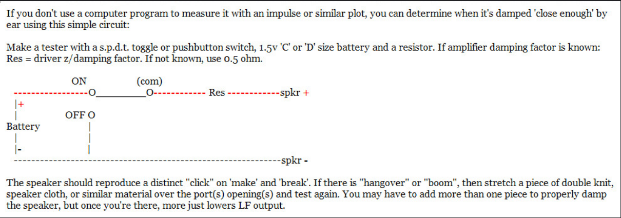

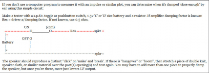

Damping/stuffing to 'taste' is best done using an impulse response measurement test or at least by ear, i.e. the DIYer's 'click test' (for best accuracy, 'sweet talk' a reasonably young female to do it since they have much better hearing in the critical BW); otherwise the pioneer's one of each parallel wall to start and go from there if need be, so typically top, one side, back at least as far down to a bit below the driver.

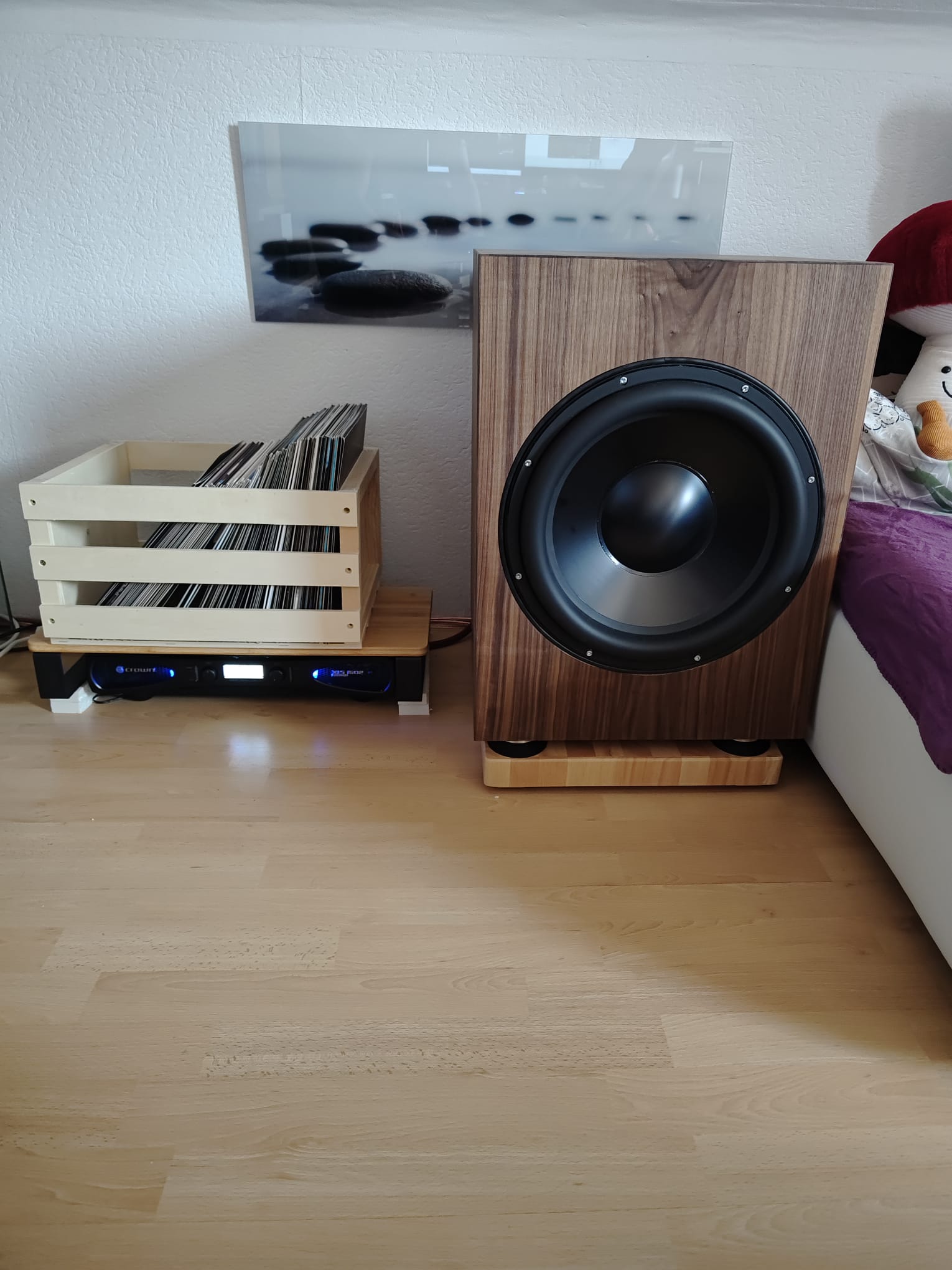

Hi

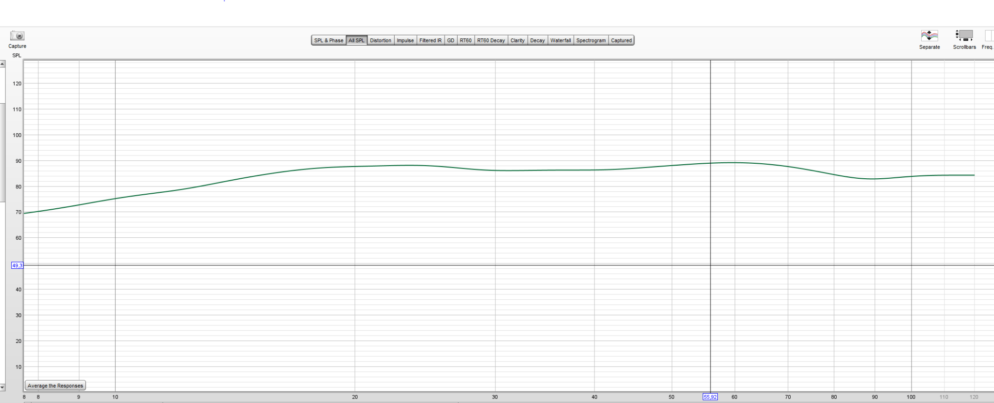

I am finished and it is buttersmooth. The big boy got 57 Kg in total and is powered by an Crown XLS 1502 in Bridged mode. The amp is silent and slim and easy to use for me and got enough Oomph to dig into heavy movies.
I tested it until 90 DBa at my listening position and it still sounds relaxed.
Xmax is no limit here because I use only around 12-14 mm at best.
The bass is superclean. It can draw and drag a bassline like a sharp knife.
I couldn´t find any bad sounding music.
The Project was a huge success for me.
