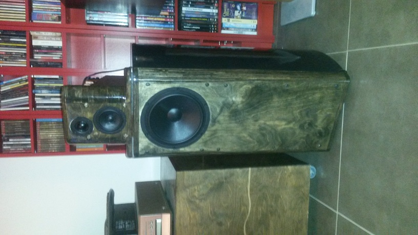

The RS4 Speakers
I'm going to dub these speakers the RS4s, apparently Infinity has a discontinued speaker called the RS-4, oh well I've got a good lawyer, gonna roll the dice
RS4 hearkens to two things, the first is that I'll be using mostly Dayton Reference Series drivers and it's a 4-way system, the second is that I am an Audi tuner by trade and the RS line of vehicles represent dynamically precisely what I'd like to achieve with these speakers acoustically.
The components I've chosen were based on many reviews and research I did, as well as considering this is my first set of speakers in 15 years, you gotta start somewhere right?
I don't know what these are technically classified as, but they are basically an MTM with an added mid-bass 8" and a 10" subwoofer. Since I talked the wife into giving me the Dining Room I realized the potential to make something bigger and not limited size wise, so at that point I stopped planning a separate subwoofer and decided to integrate the sub-bass into the towers.

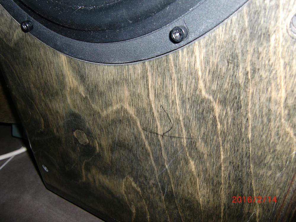

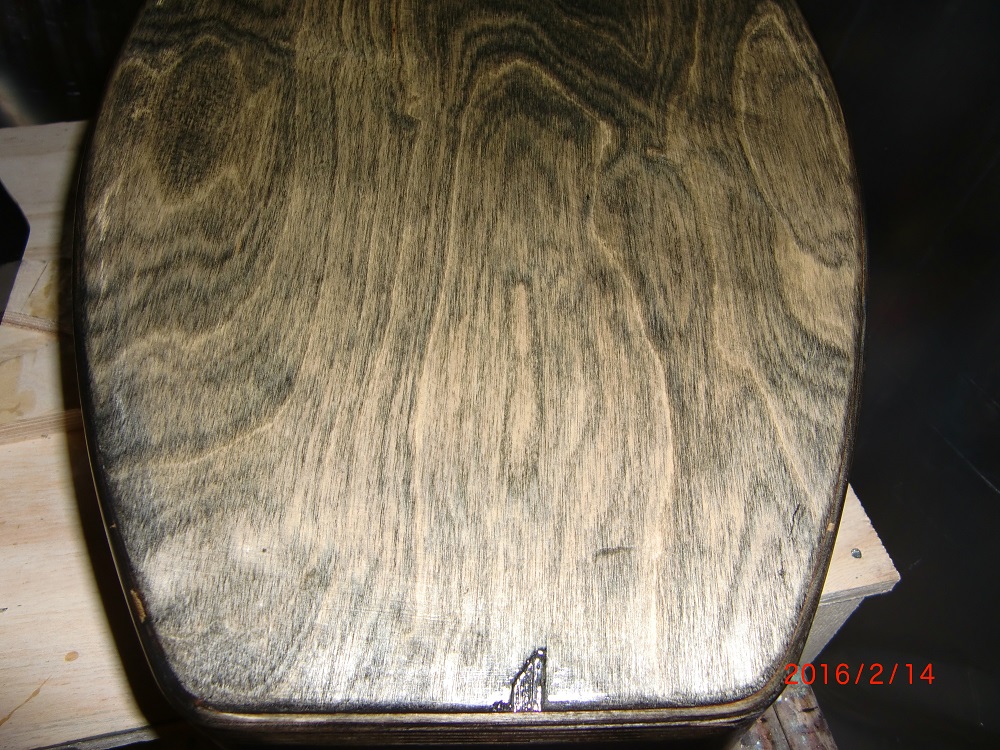

Your methods seem close to mine, except I used a PU floor clear coat. I put on 6 layers and polished to a mirror finish...
Was pretty happy with the results, until my enclosure cracked 🙁.
But what else to expect stacking 128 pieces of ply with ridged metal rods.
Anyway it's fixed but different now. I think I must have tried about 8 different recipe's for my stain/clear coat job. Never to be seen again 🙂.
