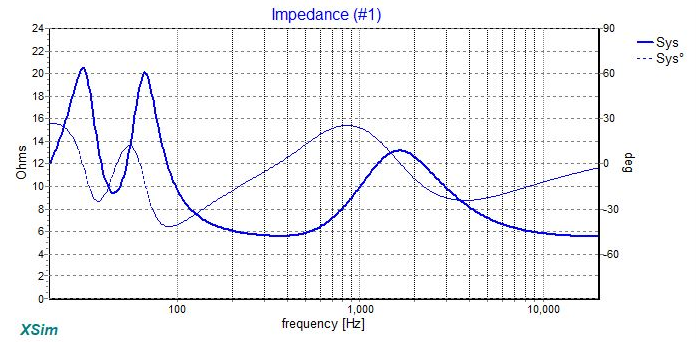

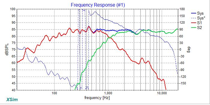

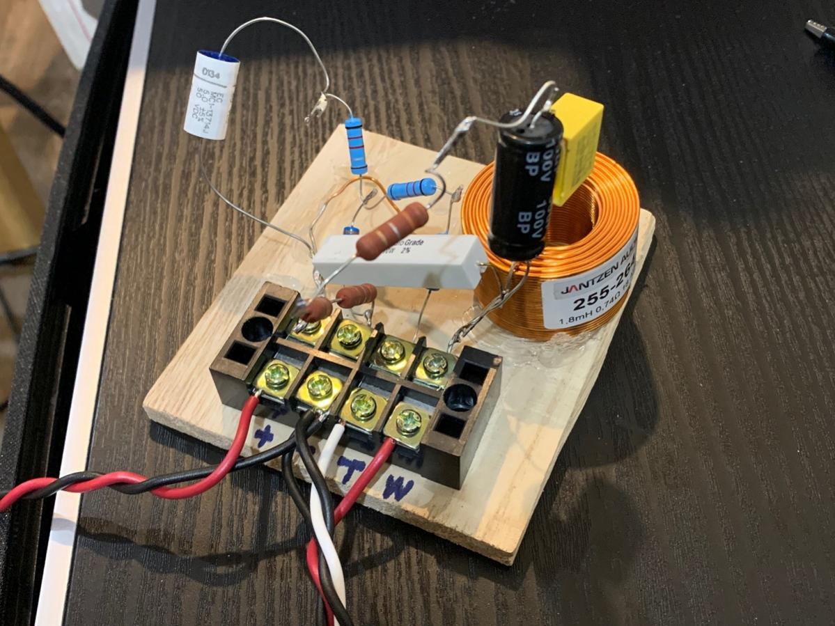

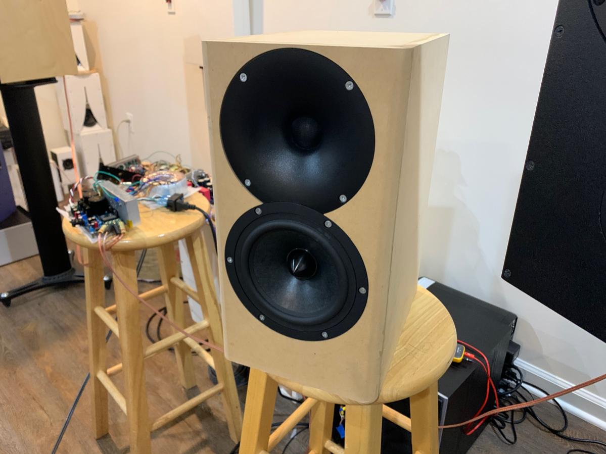

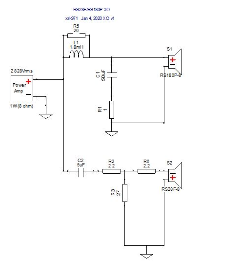

Hi folks, this project has stagnated for a while. I decided to make a quick passive crossover for a two way to get me going for fun. So I took some measurements and made a pretty simple crossover using XSim. I scrounged around my bench drawers and was able to cobble together a test crossover. Actually, the main cap is a 5uF polycarbonate - very good audio quality and inductor is decent too. The crossover measures well and although the tweeter is reversed polarity, the timing is very good.
XO design:
Yes, I know 1100Hz XO frequency. The waveguide seems to enable that. It’s still sounding clean.

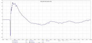

Predicted FR:
Predicted XO impedance:
Prototype XO:

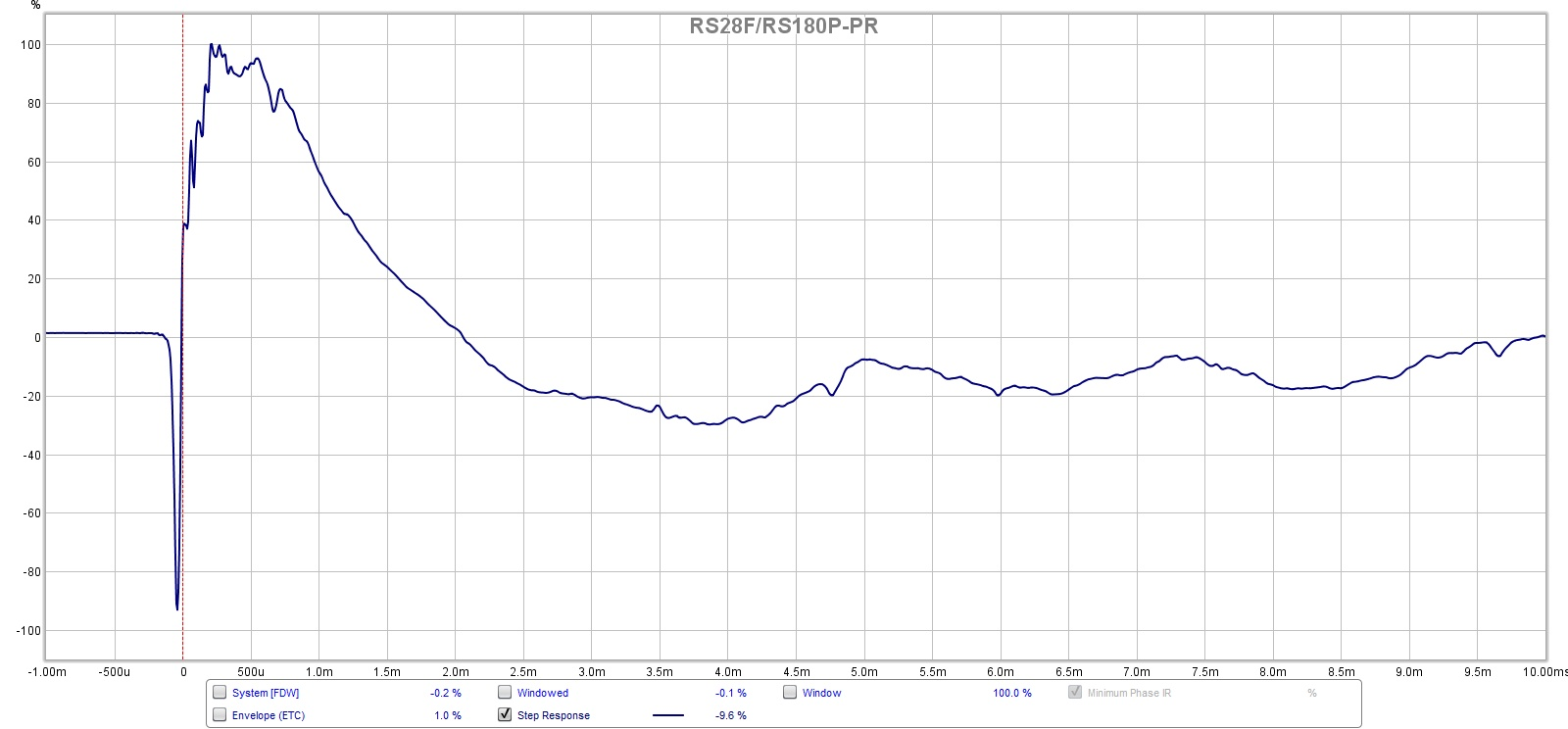

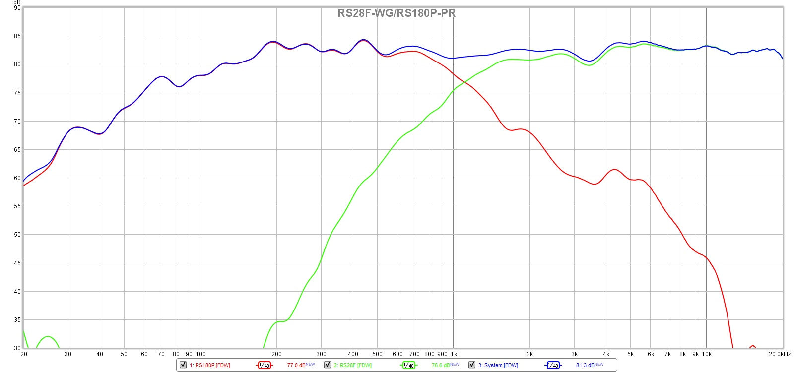

Measured speaker response:
Measured speaker step function:
I wonder if that small dip at 3500Hz is the cancellation reflection from the lip of the non flush rebate on the waveguide. It is about 1mm below flush. I could add a foam gasket to elevate it and see if it goes away. 3.5kHz is equal to 1.92in half wave distance.

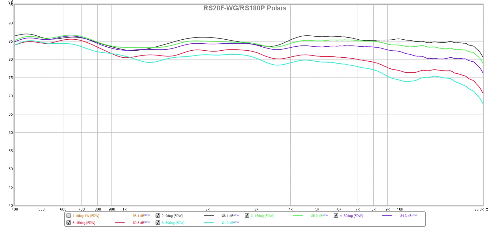

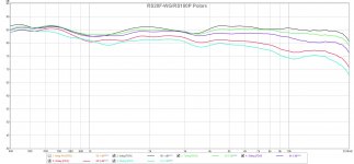

Checking performance of waveguide. Does appear to provide a nice wider angle of uniformity. Measured at 0.5m and 1.41Vrms. Angles approxiamted by eye so probably +/-3 deg.
Refresh your memory what the WG looks like - it was a Visaton unit modified to fit the RS28F with a 3d printed adapter plate.

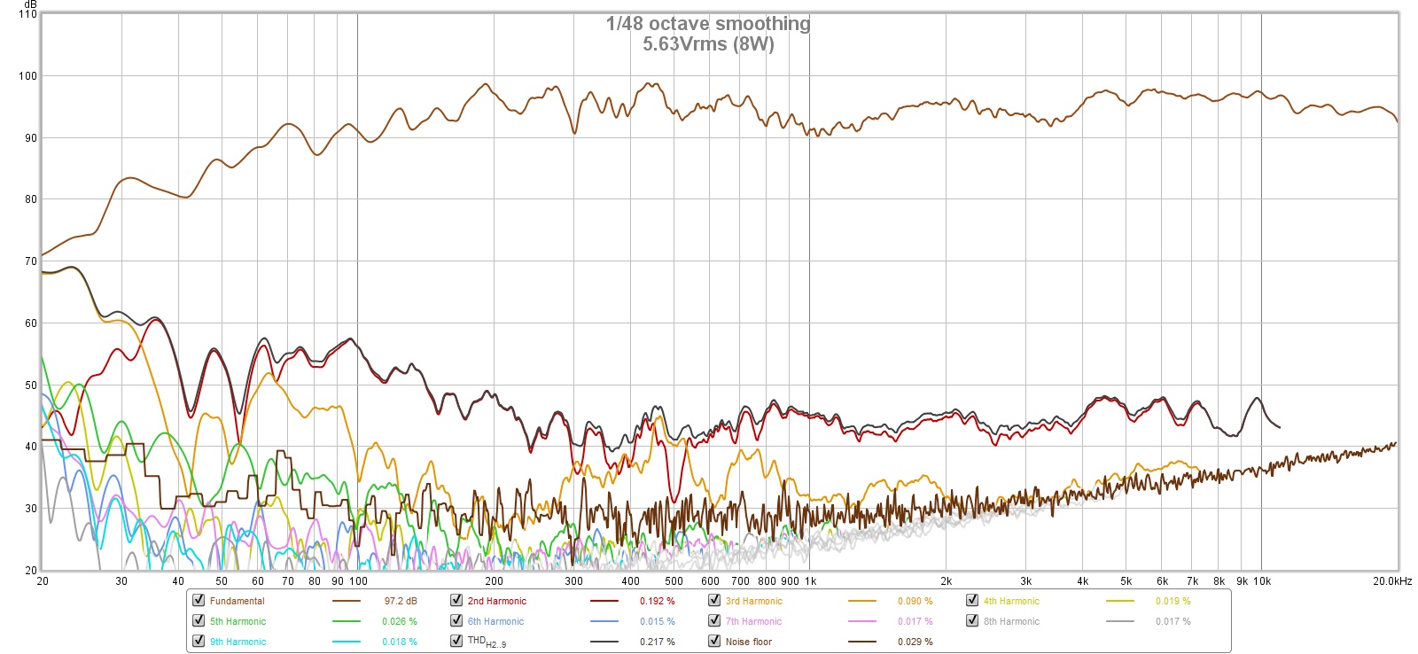

Here is harmonic distortion at 8 watts:
We can see some 3rd harmonic stuff from the RS180P start to rear its head around 300Hz to 800Hz range. But it is not noticeable at regular listening volumes of circa 82dB.
