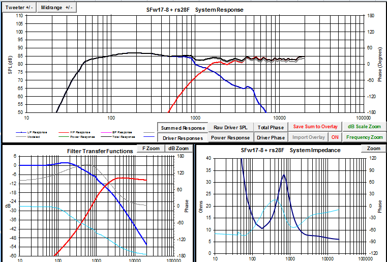

Need help with second order xo design. The plan is to cross them over 2,300 - 2,400hz. Checked some charts and on-line calculators; they were all over the place, but the general idea is:
C1 - 8.2uf
L1 - .5mh
I'll probably use twist type L pads for attenuation for now, but have section of resistor for l pad which I can slip in later.
Can anyone suggest a second order xo?
Thanks for taking a look Jay.
It's a MTM with 2 -6.5 (8ohm) in series - 16ohm. The front is small, only 1/2" on each side of woofer.

You didnt exactly give me the specifics for a completely accurate sim, this should get you very close to to good results. The nice thing about the RS28 is it can handle a low crossover.

Jay, Thanks for working on this, and apologies for beginner mix-up.
Although, before opening this post I was guessing that larger woofer coils may be needed, but never would have guessed 6.0mh.
I did try reversing tweeter leads the other day (Scanspeak tweeters) and not much sound loss when disconnecting them; so they must have been xo'ed way too high and acting like super tweeters.
In luck here, have parts, even a pair if 6.0 lam, 14gauge coils.

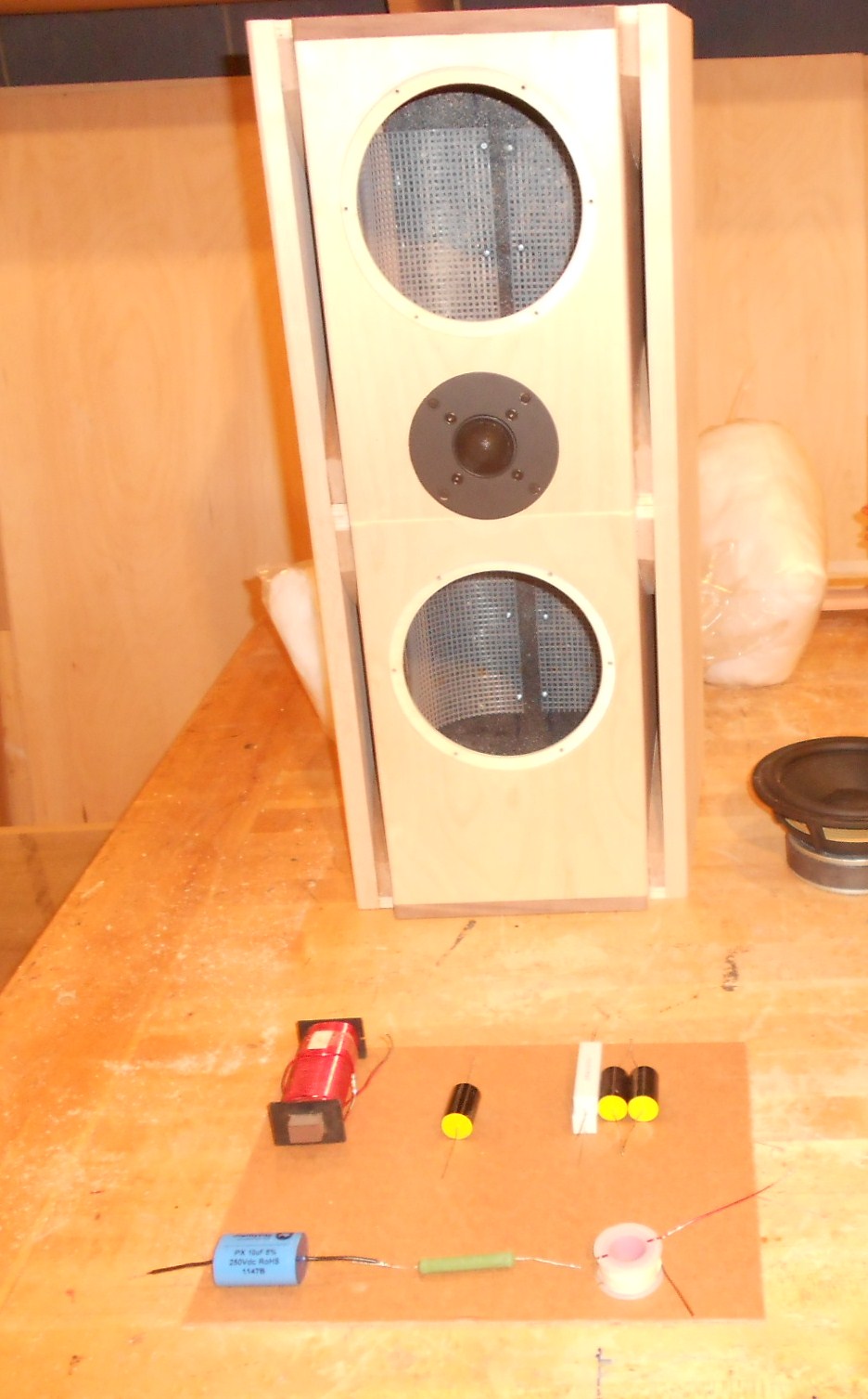

Any thoughts on MMT vs. MTM front baffle?
Might make another set if MMT is a better design. (or could fill holes and re-cut existing mock up boxes MMT)
TMM got it..no no don't want to try that again.

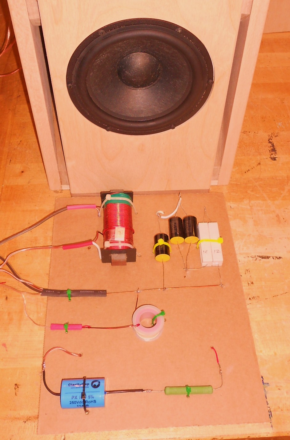

Have most of the parts; using 24R for the 20R.
Had to re-set the tweeters, which took a while since they were 1-2mm larger than existing recess.
Success! Well for the most part, had to much high end - tried many combination of resistors and ever a smaller 8.2 cap. The smaller cap left a very noticeable "hole" in the middle, so put the 10uf back in.
As you can see I did install a L Pad and only it only needed a 1/3 of a twist (which may be typical).
So yes very nice, good imaging, solid bass, a wide range of sound.
Will have to find a way to remove L pad - maybe two amps or something; passive bi-amp, but still would need a way to attenuate the treble.

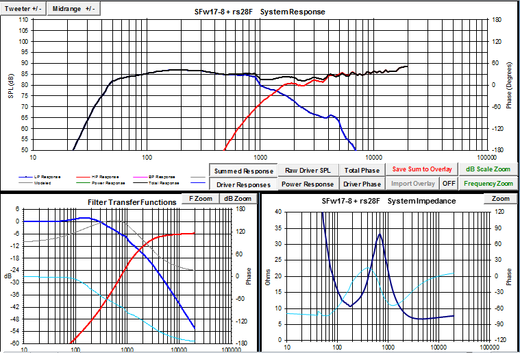

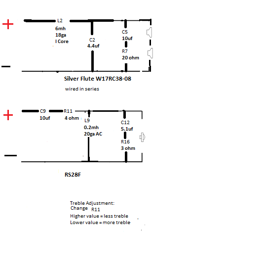

Usually yes. A zobel drops the top end of a driver by controlling the impedance. The 5.1uf, 3 ohm zobel I pm'd you will give a very slight droop to the treble response. You can also pair that with a slightly higher value for r11 until you get the balance you're happy with.
Here's what you should get with the zobel added. The gray line shows what changing R11 to 5 ohm's would get you. An adjustment of R11 in 1 ohm increments will change the treble by that much, up or down. Notice how the top of the impedance response is tilted downward, and the filter transfer function shows a downward tilt. This is the effect of using a zobel on a tweeter.
The only questionable part of a pure simulation like this is getting the phase alignment right, but the driver levels are going to be correct based on what you are seeing.

Will add Zobel today - sorry I missed that, but the L pad gave me an idea what they can sound like (when finished). I did have to tweak it several times, but they sound wayyyyyy bigger than they are; with a sub-woofer like sound.
This xo is 10x better than the one I had (post #3), e.g. I started to realize that the sound stage would focus 6' to the right (very strange). All that craziness is gone now.
Again Jay, thanks!
This sounds better every day; there were a lot of new parts and new drivers, so a few days of break-in is expected.
Also...switched to a Luxman M-117; best sounding amp here.
used 6.8 at R11, which also sounds very nice, balanced.
