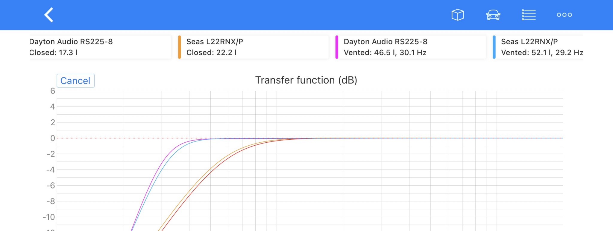

RS225-8 works really well if you need a smooth response up to high mids for low order crossover. In 24L sealed it reaches 50Hz, in a large TL it really opens up and can reach 30Hz. It’s a unique driver that I can’t find an equivalent in other brands. More on my use cases here.

Both drivers are similarly good ( enough ) , it just depends on your engineering skills and implementation goals…

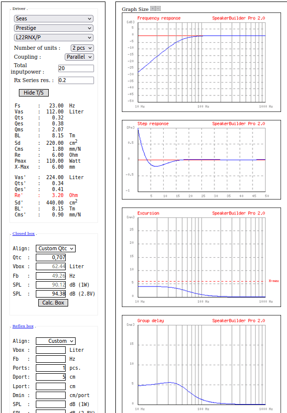

Instead of me trying. Is there a matrix, with the most important parameters for speaker drivers, where you can draw a line or chose which parameters you are willing to compromise on - and then build from there?

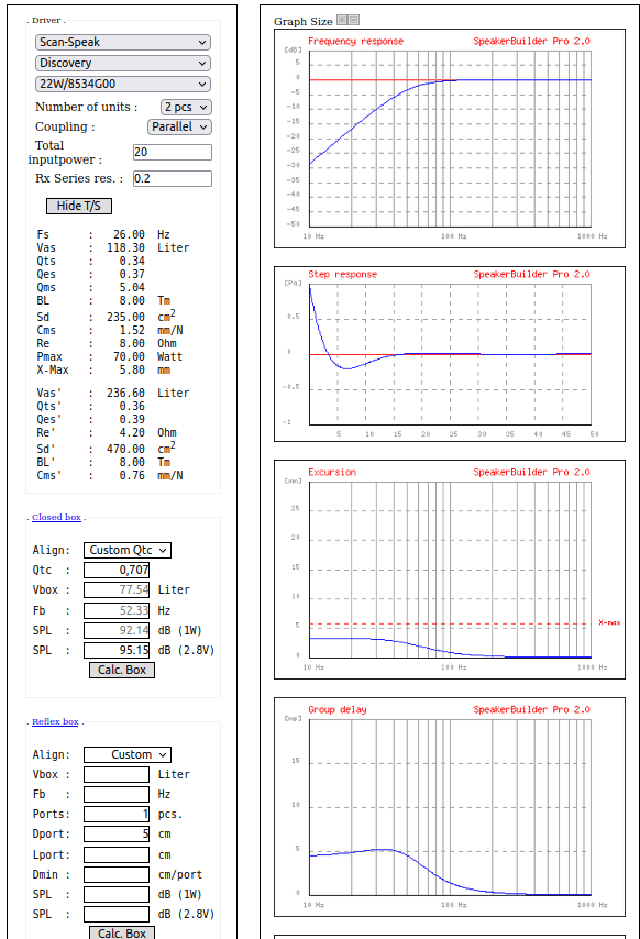

And what about the Scan speak 22W 8534G00 ?
When I put the Scan 22W against the Seas L22 - I get 15 liters less for a pair of them, but half the Qms and I lose around 1 dB of SPL. Anyone else see any catch? We're still talking about a driver that is going to be crossed max at 500Hz with LR24 filters. The Seas also play a bit deeper - but with more excursion.
Put in the SB23NRX too.... just more group delay and even bigger box - nothing that seems better - except the even higher Qms... which I can't find any good reason to "hunt".

T/s theory peters out at its upper mass corner (Fhm = 2*Fs/Qts), so the lower the Qts the wider its acceleration BW and the smaller its Vc the wider its pistonic BW, so guess this is what you want to figure trade-offs for the intended app.

Responded to (So - are all the bells and whistles all about the frequencies above 700-800 Hz, where we become more sensitive to all the details?) in that all T/S box designers only account for the ramping up of the low end (acceleration BW) and where its mass is increasingly slowing its acceleration down (flattens out at (Fhm)) with increasing frequency since its acoustic power is rolling off at 6 dB octave, so ignoring any added series resistance that would lower it, your box design only accounts for up to ~2*(30/0.39) = 153 Hz and if wanting it to be higher for a given Fs, then you need to use a lower Qts and vice versa.
The VC diameter sets the driver's theoretical pistonic BW upper limit, so ~34400/pi/3.8 = ~2882 Hz for the SS 22W, ergo the smaller the VC, the wider its usable pistonic BW and vice versa, which is close enough for XO design WRT polar response, though in reality drivers start losing pattern control (much) lower due to cone design, etc., as is shown in its frequency response beginning around 210 Hz, implying the specs might be off a little as its effective Fhm is the norm.
Anyway, was just responding to box design in general, which yours appears fine and assumed 'bells and whistles' were higher up in the BW, hence the mini tutorial about how to choose a driver for a wider box loading BW.

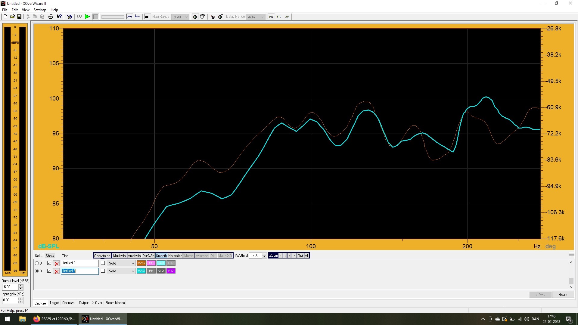

Tried again. The fullness, I referred to before, seems to be around the 60Hz area. Upwards 85hz the 2x4 ohm Purifi 6,5X just need a 2,5dB pump to match the 2x8ohm SB23NRX. It's lower in frequency, where a port or passive driver would give them more extension.

It seem then, that the RS225 is definitely a good candidate. It looks good, easy to work with and affordable. The Purifi's should maybe go to someone aiming for a 2 way instead. Then I could maybe look at the dedicated Purifi Midrange instead - if I don't find my current MW13TX sufficient somehow... or just got the "itch" 😊
