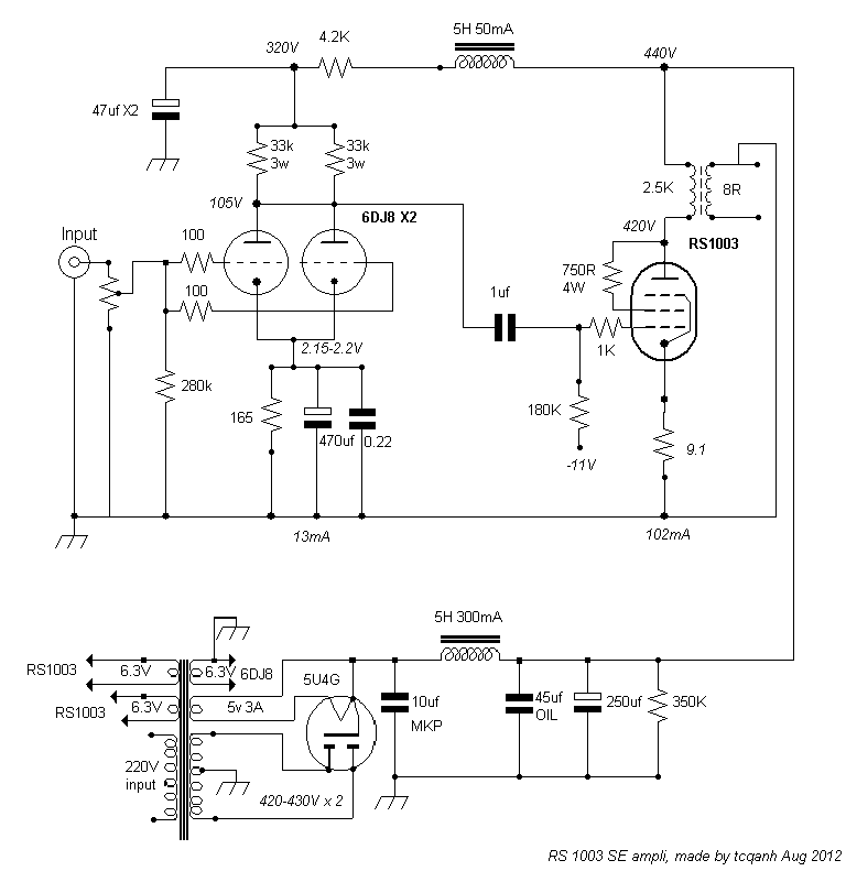

here is my schema. 1st stage has gain 30, Zout about 1.3-1.4K.

TC, I couldn't open your schematic, please post it on our server if you don't mind doing so.

I don't know how to post a pictue on this server. here the link :
http://vnav.vn/forum/download/file.php?id=418835
http://vnav.vn/forum/download/file.php?id=418408
The links don't work for non members. To post attachments go to "Advanced" then manage attachments - at that point it should be obvious..
Ok, thanks kevinkr.
Hi tcqanh,
Nice, simple design, can you estimate what sort of output power you are getting? The nice thing is that it appears that commonly available output transformers would be a good match based on your design choices.
What are you using for the -11V fixed bias supply? It seems like a 12V alkaline battery could be a good grid bias source if the 9.1 ohm cathode resistor were changed to 1 ohm. I used A23 type batteries to bias the 6V6 in a relatively recent SE amp, the holders are readily available from several eBay sellers along with the battery.

this OPT is made for RS1003, so you can see it how big 🙂 and power get about 11-12W
I use 1 small power transformer for bias with simple circuit: bridge diode-RCRC- pot volume 15K. this negative bias voltage is not presented in my schema.
I never try bias with a battery. Could you show me its advantage ?

for my opinion, the more simple circuit design is the better on sound quality. Negative feedback somewhat kills 2nd harmonic, so kill music too. Indeed, you can never see NF in my tube SE ampli 😀
I like very simple designs, mine generally are with a few exceptions.. I use no local or global feedback anywhere in the audio portion of my designs either and I would say for much the same reasons.
My power supplies tend to get somewhat complex, are tube based, generally regulated and obviously use feedback in such a case. (Low noise, low source impedance, relatively stiff and impervious to line born disturbances.)
WRT to the battery bias I am not sure it sounds any better than a very well filtered bias supply, but it is one of those silly things that amuses me these days so I do it. (See my Muscovite phono thread in analog source for how many batteries and chokes you can put in a phono stage. 😀 )

Could you share how to get it ? any schematic ?
Do you take a battery for gird bias in the 1st stage ? whith this, you can ignore a Ck (a bad Cka must worsen sound quality much).... so sound is maybe improved
