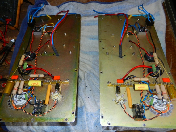

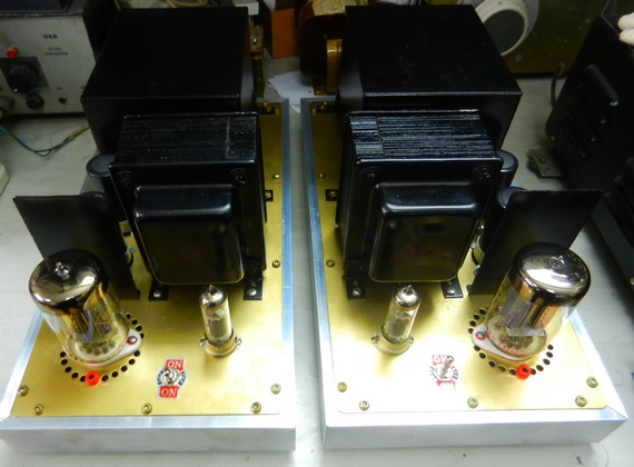

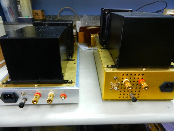

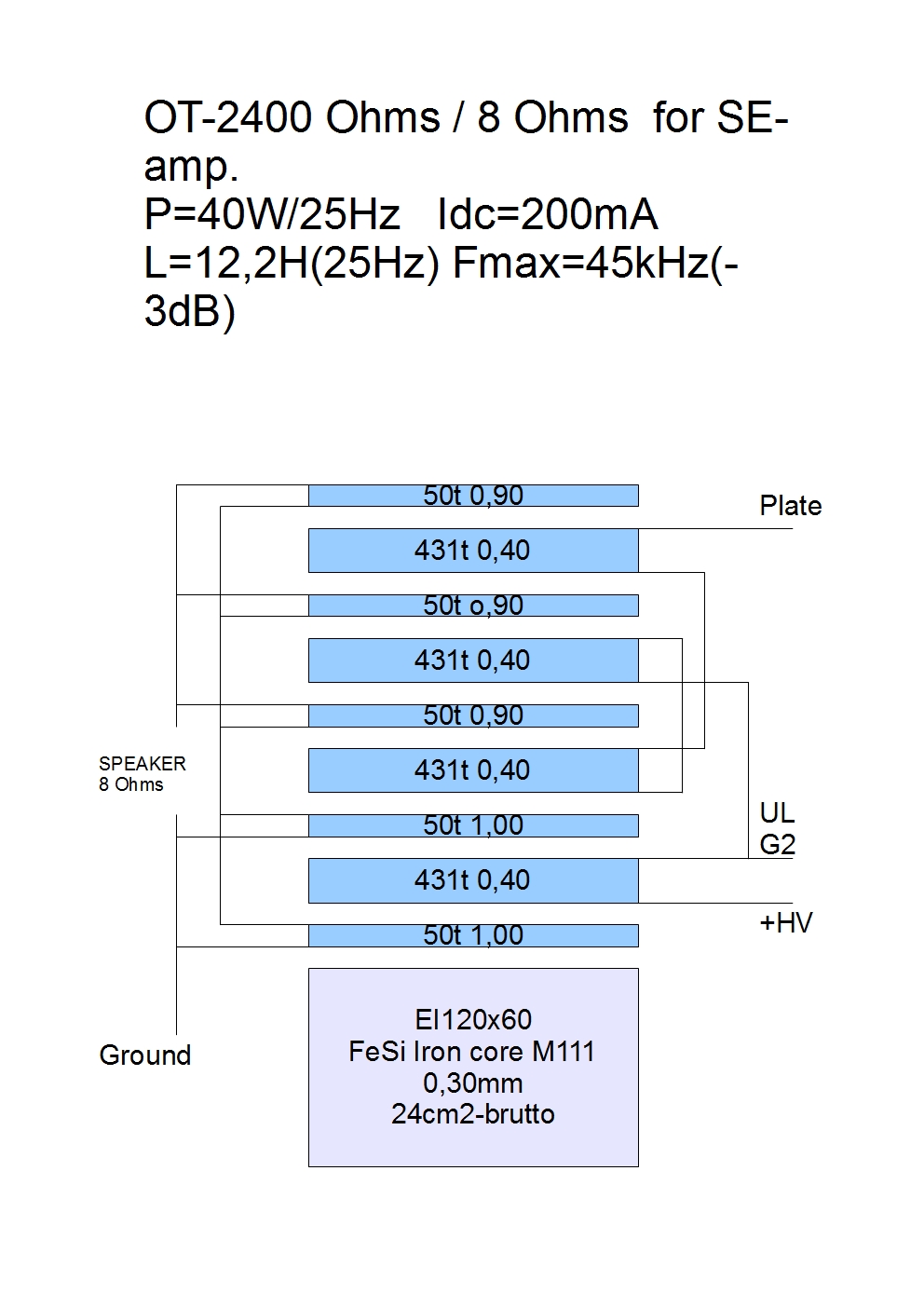

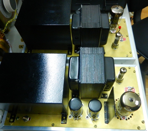

Just finished monoblocks with RS1003 ( SRS551) tube in SE-ClassA triode (option UL) connection. For drive tube I use EL803 (EL83 or EL803S) tube in triode connection. Also build in switch for LOW/HIGH output power for spare tube life time. Output power is 11W or 15W in triode connection, and 16W or 22W in UL connection. UL tape is at 25% turns of output transformer (closer to pentode connection), so I must use SHADE-feedback to reduce gain and distorsions.

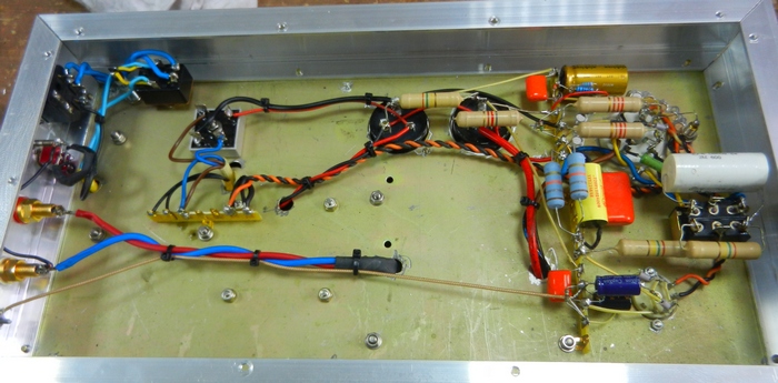

I notice you lift the connection to Earth at the chassis! This makes it unsafe,
If you want to break ground loops, lift the (-) on the input, nevet the Safety Earth!

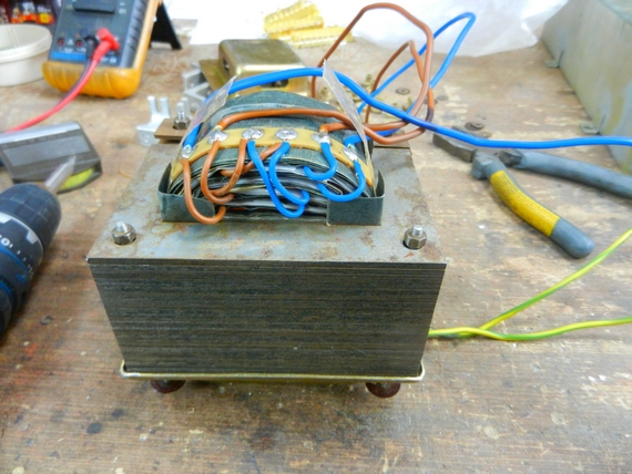

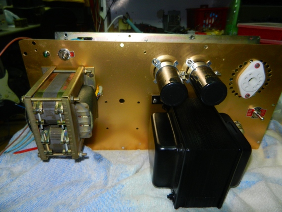

On the back side of chassis, there is terminal for separate wire for grounding.
Also, You can see previous version of frame.
Sonds very good, more like some other bigger transmitting tubes with direct heating, not like 2-3 paralell connecteed EL34, KT88 or GU50 tubes.
In triode connection sunds like 811A or 812A, but with less distorsion. UL-connection provide much more power, and can drive less sensitive speakers. Less detail than triode connect, but with BIGG sound for rock, metal and simphonical music.

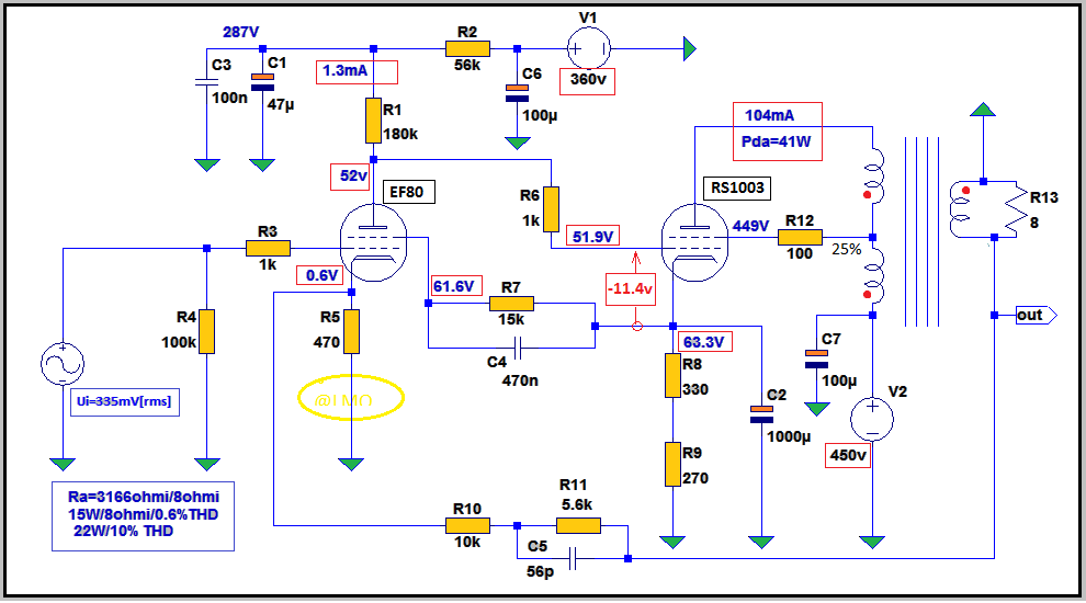

What about the scheme designed by me?
EF80 is galvanic coupling advantage is a very good response in low frequencies.
The disadvantage is that the anode voltage to be coupled after the tubes were heated

EF80 is good drive for UL connection output tube, but in triode connection there is much more capacitance (total input capacitance of RS1003~150pF including Miller) , and You need tube with less internal resistance for drive.Hello!

Gain of output tube in triode connection is ~20-21x, and for normal input sesitivity (~1Veff) You need drive element with total gain about ~12x(including SHADE feedback). You can use 1/2 double-triode tubes(6SN7, 6CG7, 6FQ7, E80CC etc.; russian 6N6P and 6N30P) and many tubes with single triode in sistem with same caracteristic like 6J5GT.
At first, I try with triode connection E80F(~EF86) and 5879 tubes with very good sounds at low power, but more distorsions at higher levels as triode conection output tube. Also try triode connection EL84(6BQ5) and 6BW6(noval version of 6V6). Booth have perfect caracteristic and sound, but too low gain (~6-8x).
You can try 6CL6, caracteristics in triode mode are near EL83, and any video output pentode/tetrode from old B&W-TV sets.

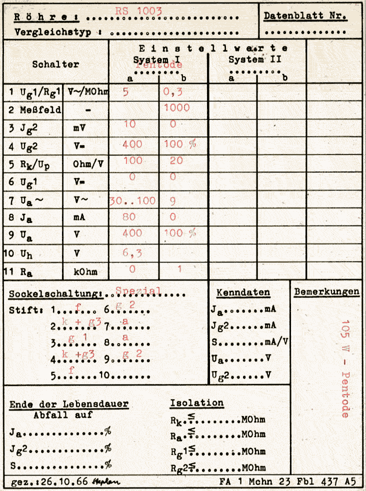

For RS1003 You can find data sheet at Frank's Electron tube Pages.these data will be helpful?

RS1003 need 2,3A for heating, SRS551 need 2,2A, and F3a need 2,1A. Other caracteristic are the same.

http://www.mif.pg.gda.pl/homepages/frank/short/054/4/436.pdf

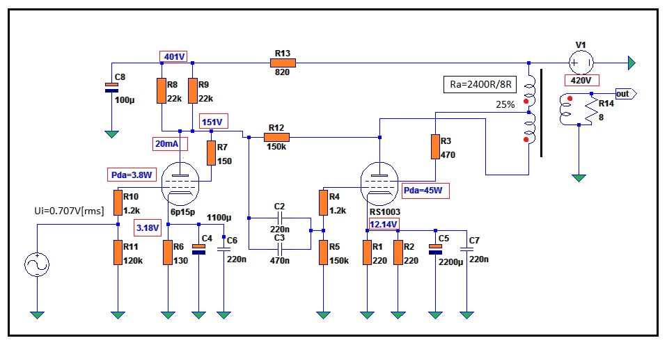

We made changes in your schedule for 6P15P and the simulation results are excellent.
Thanks for the advice and I hope to be as sound.
The scheme is this:
I prefer UL pentode configuration, I and some power
The scheme is this:
If You need more power, You can drop katode resistor to 90 Ohms (2x180 Ohms), and katode curent wil grow to 160-165mA, and outpu power to >25W!
At my experiments, I started with 220+150 Ohms in paralel (89 Ohms), and katode curent was 170mA, and output power ~28W!

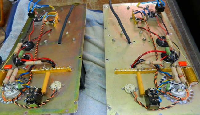

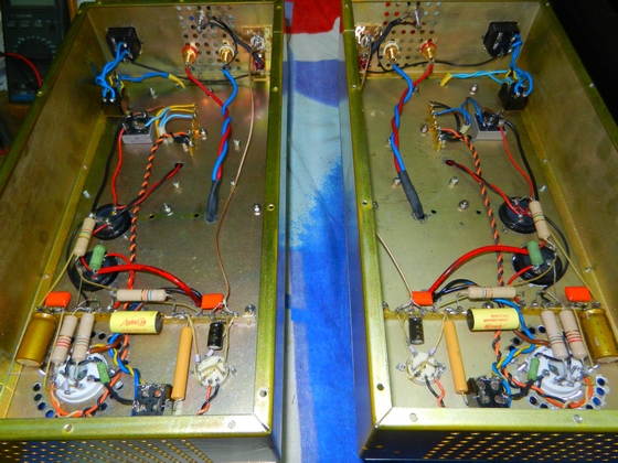

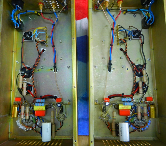

Some pictures from begining:
