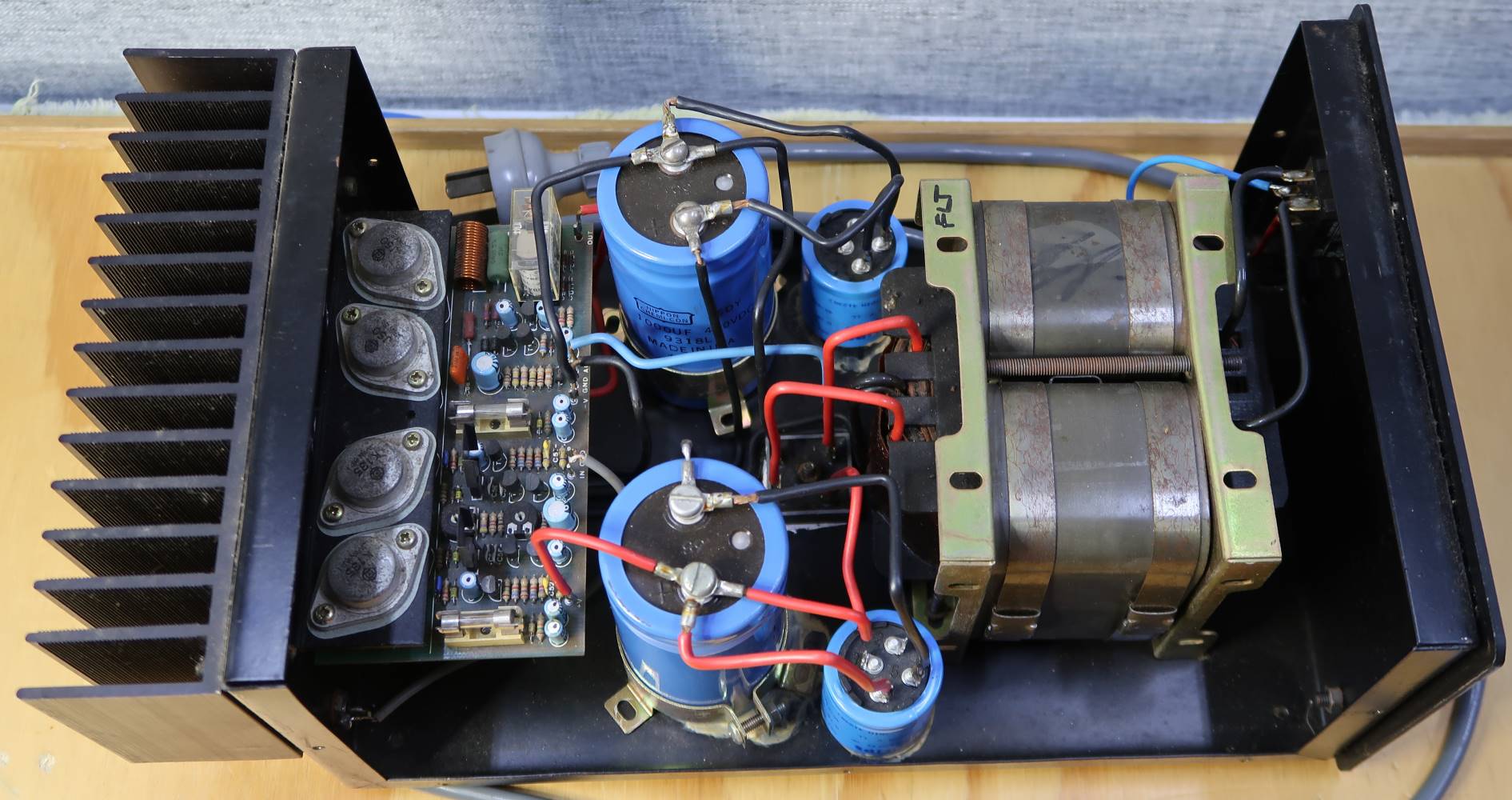

First turn P2 to minimal resistance (zero Ohm).Since there are no emitter resistors, how do I measure the bias ?
Swap the rail fuses for a pair of resistors ? (this is what Mr Tillbrook did on his aem6000)
Then connect 1R/2W resistors in place of F2/F3 fuses and connect the voltmeter across one of those 1R/2W resistors.
Turn on the amp and voltmeter shouldn't show any voltage.
Slowly turn the P2 until you read 300-400 mV on the voltmeter (that means 150-200mA through each MOSFET). Your pictures don't show the size of the heatsinks but that should be usual and safe value for those MOSFETs in class AB.
P1 sets the DC offset at the amp's output and it should be 0 V DC.
If it doesn't work like this, your amp is malfunctioning and needs repair.
If everything is OK and stable, turn the amp off, take 1R/2W resistors out, insert the fuses and you are ready to go.
Of course, feel free to change the caps that might get old and dry (after all, 1989 was 34 years ago)

I'm organising parts and instructions for the owner.
Trying to make it as easy/understandable as possible for him.
He's got the brains, so he wants to do the refurb himself as a fun project.
I'm getting him all new caps (including power supply), to-3 silpads, trimpots (never trust the old ones) hence the question about bias.
Offset is (almost) always universally simple.

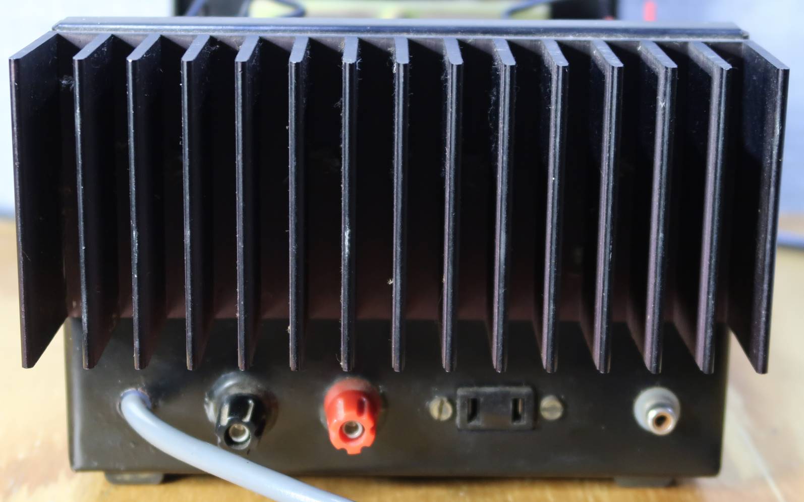

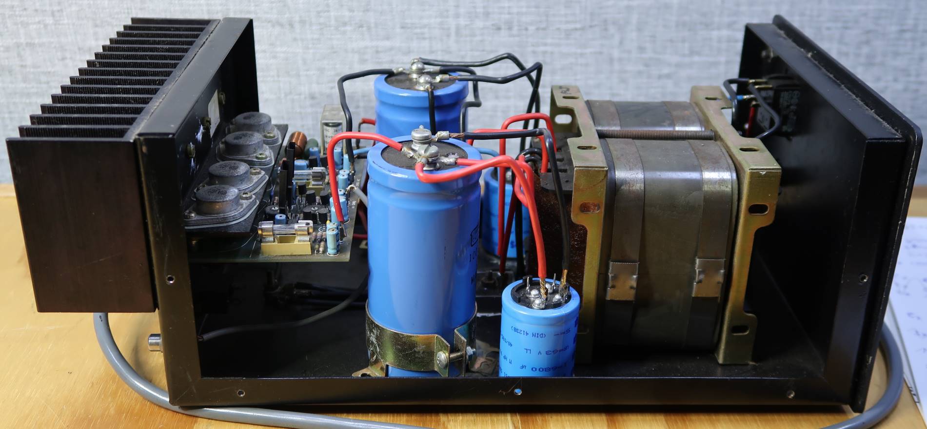

And yes the heatsink is, small.

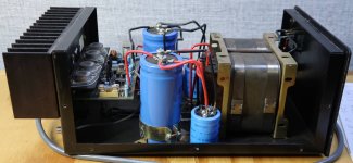

And yes, you see two power supply caps per rail. large one is 1,000uf, small parrallel one is 6,800uf. I've sourced some nice 16,000uf to replace these.
And bigger bridges to handle the increased start up surge.

Considering the amp is a mono-block, I guess I've seen worse heatsinks as well. If I was refurbishing these I guess I'd increase the bias until the heatsink get lukewarm even with lid on and leave it there.
Considering mosfets love bias to operate / sound decent, I'd rate these heatsinks as undersized.
Then again, to my untrained eye, the entire design is somewhat compromised.
