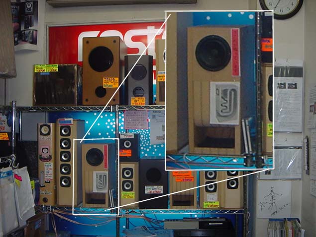

I don't know how it would work either but went I was in Japan last year I seen these little jewels.
