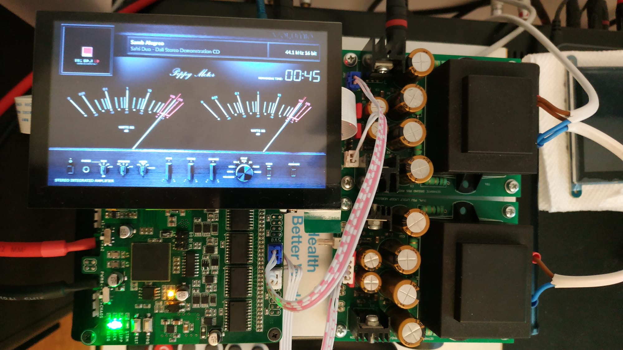

@JMF11 I think that considering RPi as starting point of your project is a very good choice. I would reccomend you not to give up the I2S benefit of RPi. There are not so many good implementations of USB2I2S modules on the market, and even if you will pay the price, you have no (easy) control over its firmware!
As a standalone network player project, RPI is unbeatable. Even as an USB player, it is a powerfull solution.
- you can implement a silent (passive) cooling system;
- you can reduce noie using a better power supply easier than for an HTPC/laptop;
- it has less noise sources (there are a lot of PMICs in any HTPC/laptop, a single one on RPi), so it is easier to filter/isolate it;
- it is easier to disable HDMI out, Audio Out, etc if you don't need them, to reduce power consumption and noise;
- it has many GPIOs, so you don't need an additional microcontroller for buttons/rot-encs/IR-recv, etc.
- it has I2S output/input pins, they are jittery, I agree, but it can be configured as a slave or as a master I2S; (an HTPC/laptop doesn't have it)
- it benefits of a huge software support, mostly open source;
But YES, you should take care about the issues Mark pointed of, but most of them are also valid for USB2I2S solutions powered by an HTPC. Maybe it is a little harder to do that for RPi, due to EMI radiation, but look at the advantages above!
