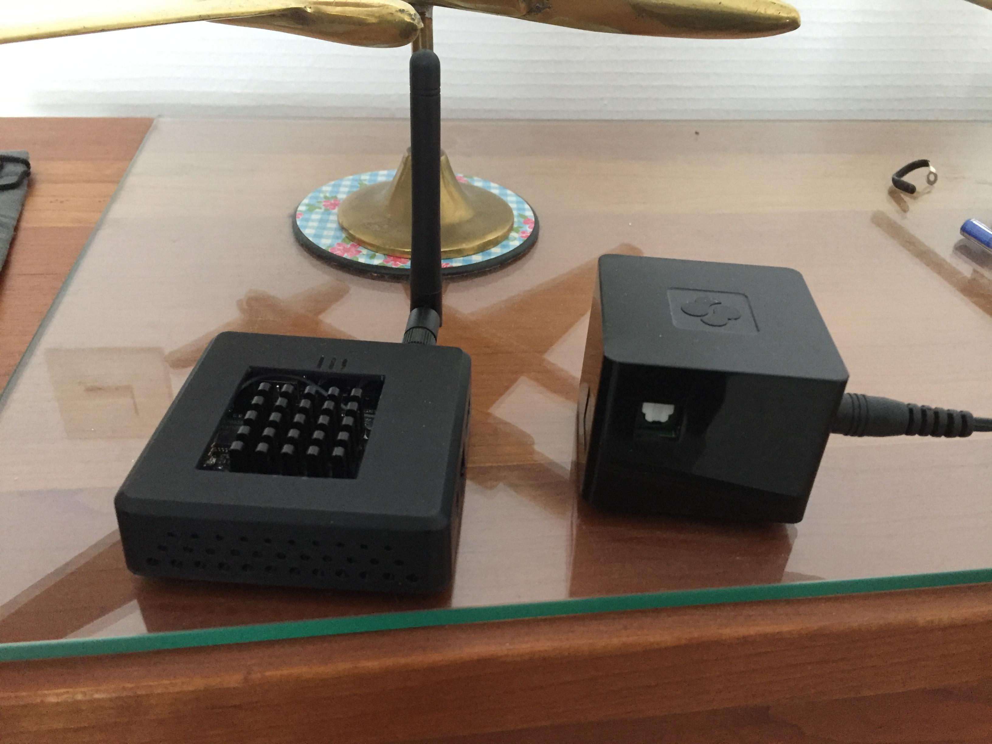

Video: yes, I modify them by better passive cooling and getting rid of the terrible Android OS. The devices are abandoned by their manufacturer. They run tens of degrees cooler with heatsink and Coreelec. Then they change from hot impractical devices to very fast and powerful H265 video decoders playing everything. Excellent video quality. IR remote also wins from an app IMO.
Audio: Volumio is a free OS for many devices. I paid less than 3 Euro for the app to control the devices. I use Cubox-i I4 Pro 2 GB as these are overlooked, fast, low power, small, look OK and have Toslink, USB, gigabit ethernet, wireless and what not.
In fact both are recycling projects reusing second hand hardware with high price/quality ratio. Both devices are among the smallest on the market and they are abandoned/less popular than RPI (although offering at least some better specifications/features) but both are still supported by alternative software. As I don't howl with the wolves I like to cherry pick suitable and overdimensioned hardware for specific purposes preferably using a free and easy to use OS that gets the maximum out of the hardware.
DIY part is modifying the casing of the Wetek Hub, removing the steel plate serving as bad heatsink, glueing a real heatsink, flashing the free Coreelec OS on the NAND thereby bringing Android to where it belongs: /dev/null. Both devices profit from DIY built linear power supplies 5V 3A.
