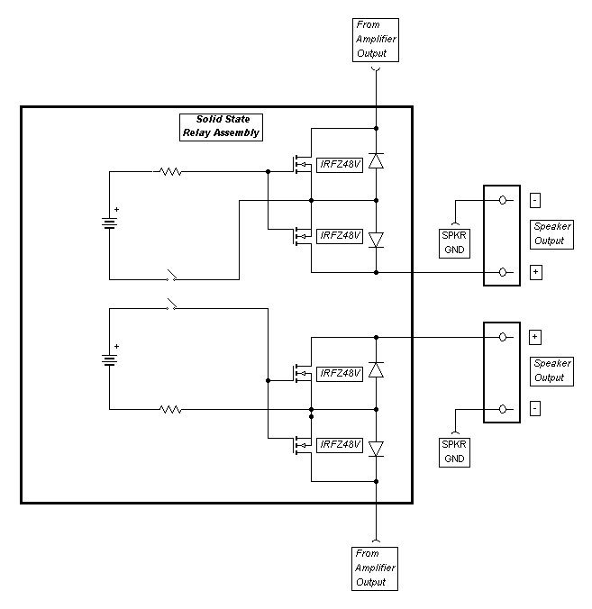

Keep in mind. I look for
* a DC output type. (AC-out SSRs can't handle DC-out)
* one that can handle 3A and
* won't become an auxiliary heater.
First of all thanks for doing the research and starting the thread - very useful.
As far as SSRs go i think your requirements will be met perfectly by a circuit similar to what is discussed under several SSR speaker protection threads: a photovoltaic optocoupler controlling a single low Rds on Mosfet. In the speaker protection circuit they use two but for dc switching one is obviously sufficient.
I have attached Michael Bean's version as illustration
