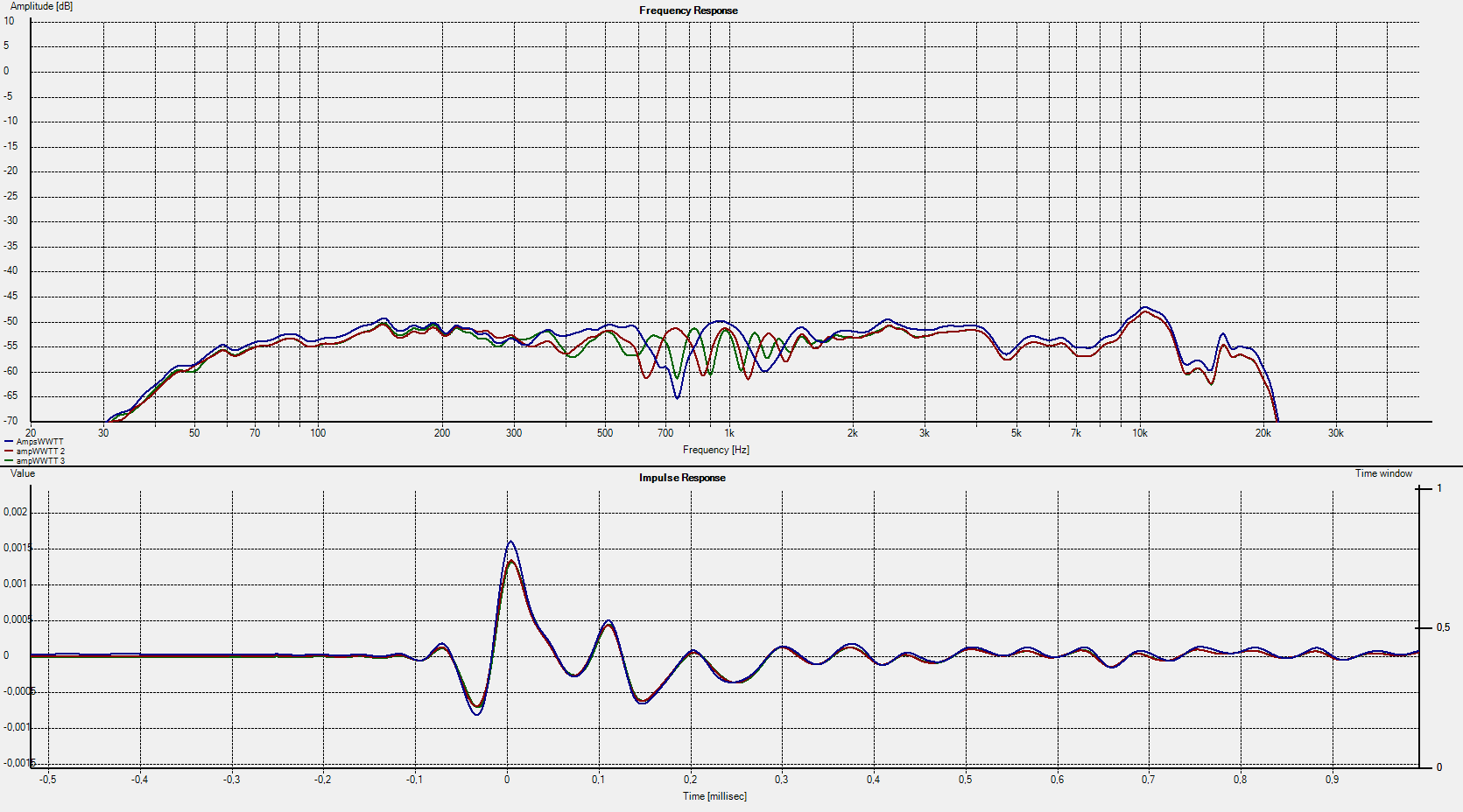

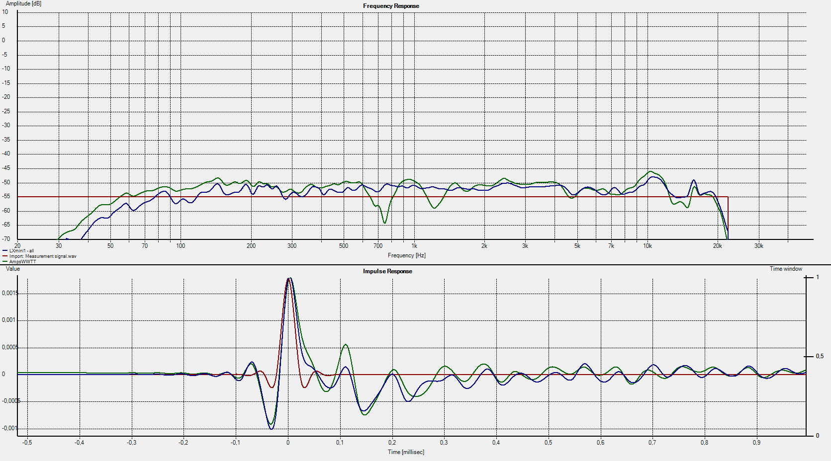

Belo some measurements when I put the both tweeters on the same amp and both woofers on the same amp.
First is a comparion: measurement signal, expected response (W+T on the same amp), disaster due to W and T on different amp, with the strange delay
Second is 3 measurements of the same config with both tweeters on the same amp and both woofers on the same amp. Seems that the delay is not constant...
