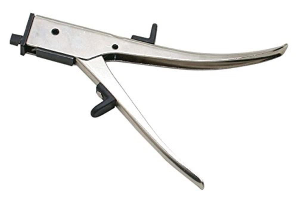

While a little tedious, one of these works very well - Amazon has them for around 16-17 USD. I use them frequently to upgrade old oval power connector cutouts to IEC.
One of the major benefits of the nibbler above is that there is only a small nibble of material removed at a time - easy to collect so it can all be done while everything else is still mounted to the chassis - no worry about metal shavings/debris in the equipment.
Yes, these old nibblers do cut fairly well, but the handles can be real finger pinchers. I always wear leather gloves when using them.

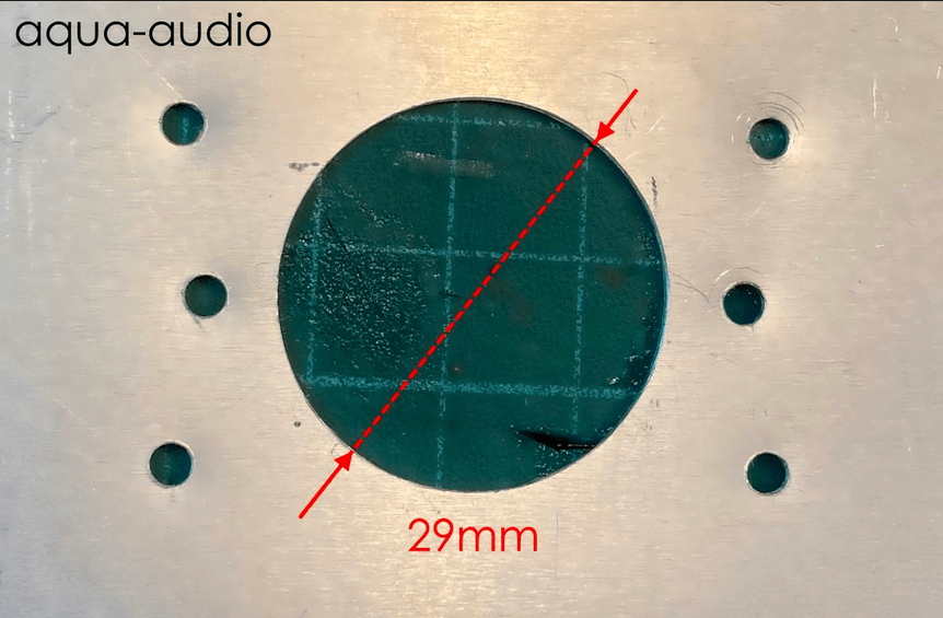

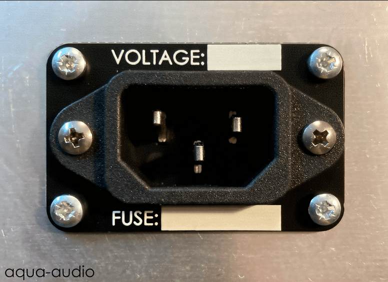

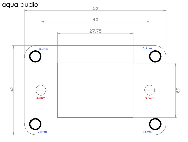

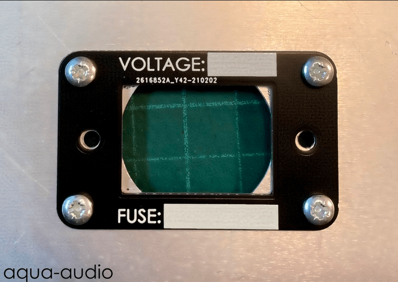

Another method is to drill a large round hole for the IEC socket body and 2 smaller holes for the mounting screws, the other 4 screw holes are optional.
A rectangular PCB, plastic or aluminum plate is then used to accommodate the IEC socket. This is much easier than making a rectangular cutout in the back panel.
There are ready-made IEC boards on the market, but the shipping costs are quite high!
https://www.ebay.com/itm/196381439486
https://www.etsy.com/listing/1385609914/iec-socket-to-round-hole-mounting-plate
