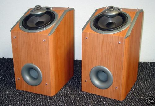

Interesting, I was just perusing the Mirage site, but I didn't see the model in your picture; which one is it?

Oh yea, I have the Omni 50s as my current speakers. They are discontinued. Their new series are really nice they now have reference grade omnipolar loudspeakers. My speakers are pretty nice the only complaint is that they can be a bit on the bright side occasionally. Soundstaging is huge and aslong as they are more or less equidistant from side walls the image the doesn't skew to one side. A pair on Ebay should be a good price. I bought mine for $200 oddly enough at The Great Indoors, a furniture store as they were being discontinued.

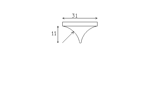

As promised a drawing of dispersion cone. The advantage of this design that it reflects sound good. The cone on the Mirage omni speakers reflect too much back to the dome, because its too flat. This gives interference errors.
The cone works as a phase plug too. Another fact: when i first placed the tweeter vertical on box, it was very obvious to hear a sort of "doppler effect" when i moved speaker from front to back. With the tweeter mounted horizontal with dispersion dome, i could not hear allmost any difference in sound with moving! So i placed tweeter in the best position it would be when it is mounted vertical: baseplate 1 cm from edge box.
Its advisable to search a tweeter which has about 3dB more efficiency then woofer, because its radiating around and fills allmost whole room with high tones. But tweeters have usual a lot more efficiency then woofers.
The radius in the concave is about 33mm. For a bigger tweeter(this cone is for a tweeter of 20mm diameter) it can be enlarged. Mounted it just above dome, 1 mm away from it. The tip has a small convex curve of about 0.6 mm radius.

Interesting point on the mirage omni cone reflecting too much sound back into the dome. I never really thought of that, but the omniguide is designed to have a bias to radiate sound to the front. Tubee, does your design exagerrate the soundstage too much?

Angsuman, i listened to them in stereo, to compare sound. The soundstage is in a good proportion, even considering the cheap tweeters.
