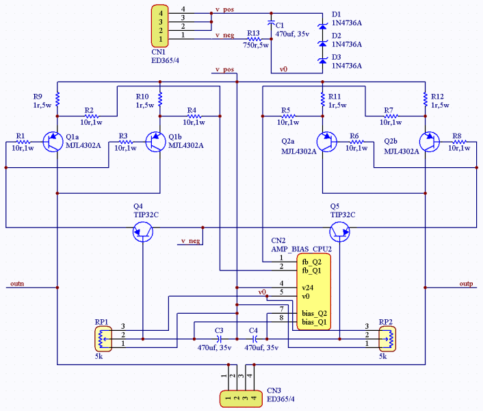

Rough draft, modified SOZ with CCS pull-ups & CPU biasing, need advice.
Here’s my first brainstorm. My goal is to achieve around 100 watts with a 750 watt supply. I will be feeding this amp with a 10vrms audio signal from a Balanced Zen Line Stage amp.
I’ve also been told that using CCS pull-ups in the SOZ design lowers the damping factor, in an attempt to compensate for this, I’ve added feedback resistors R3 & R4, however, I still haven’t worked out a good value.
The big question, will I get a good sound out of this design?
OOOPS, I just re-uploaded the hi-res version of the schematic, the low res 1 was in there. HIRES:
http://www.diyaudio.com/forums/attachment.php?s=&postid=255760
The design uses 2 diferenc CPU modules, though, each module has the same circuitry, the software is a little different.
The goal of "AMP_BIAS_CPU1" is to optimize the Drain bias voltage of Q1 & Q2. It takes in nets "fb_Q1 & fb_Q2 (in green)" which are divided by 10, (hence the 10K res divided by 1K res down by the cpu module connector), fed to the 2 x 24 bit AD converters. The module will measure the inputs between (v_neg) and (vn+24), which is 24v regulated above the (v_neg).
The module has 2 x 18 bit voltage out DACs which also go between (v_neg) and +24v.
The goal of the "AMP_BIAS_CPU2" is to maintain the CCS1 & CCS2. It operates between (v_pos) and -24v, (v_pos) regulated down with a negative 24v regulator. It will be trying to maintain a 23v level (from the modules point of view) at the (fb_CC1) and (fb_CC2).
The 2 modules working together can startup the amp nice and slow controled manner, + compensate for warm and general temparature drift, + with internal flash memory, they can chart the potential deteriation of a lemmon part.

1) it acts like a volt meter. eg: in the main amp section, it will measure the voltage over the 2 speaker outputs.
2) after measurements are made, it will adjust the bias voltage sent to the 2 gates on Q1 & Q2 so that my output is 50% of the supply voltage & the DC voltage difference sent to the speaker is under a microvolt.
In the processor module, there is the potential to store the 2 bias voltages being sent to the Q1 & Q2 gates which will move slightly with amp temperature & age. Downloading this to a PC would give you a graph of your Amps consistency. Sort of like the little diagnostic memory capability in some car's fuel injection system microprocessor.
This concept is not completely new, there are some microcontroler biased tube amps which corect for drift as the tube ages.
