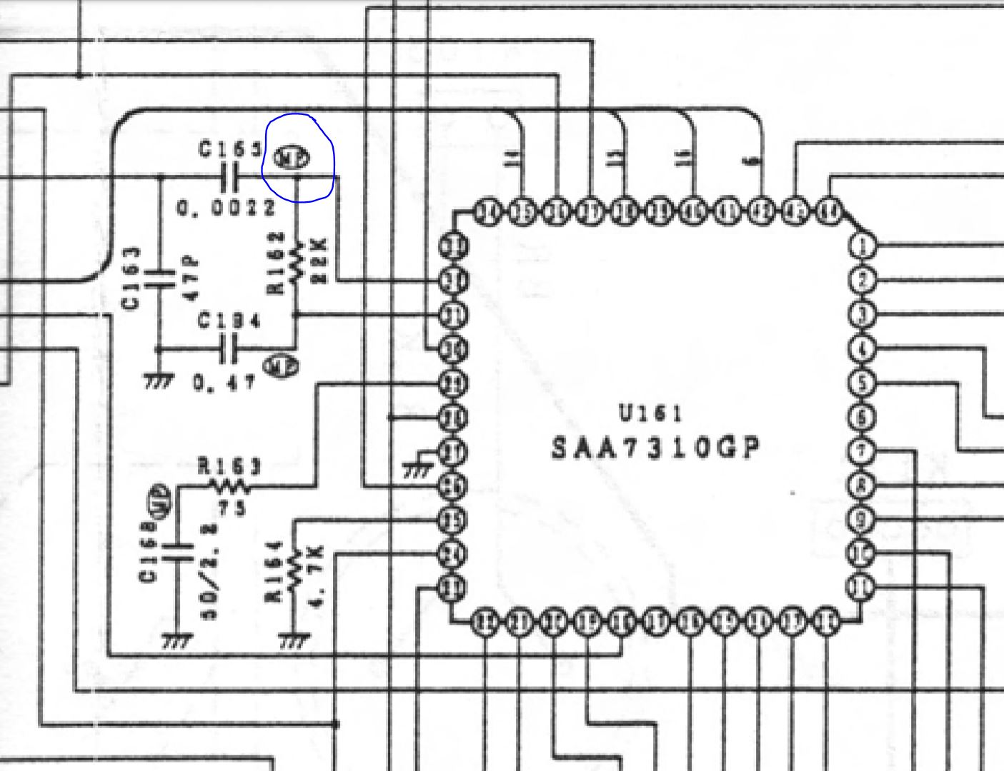

Also, is there any way I can get an eye pattern from this player ? I have a scope but can’t find an RF test point on the circuit board. Nothing about this in the service manual either.

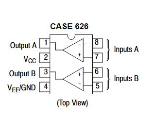

I have done a few things for you; look at U191, U192 and in particular the D191 and T191.
Make sure the +5V is stable (reference for U191 comparators).
I found the service manual and the U191 DIL8 pinout (both attached)

Any idea how to get an RF signal from this CDM-9/65 ? Just wanted to have a look at the eye pattern. I know there are no adjustments on the RDD-980 but I don’t see an RF test point in the service manual either.

Download the SAA7310GP pdf. Look at "HF Input" into a DATA SLICER.
It is PIN 32
... after a closer look, the schematics diagram does state the "HF" point, it's not really readable, but it's there... see attached
