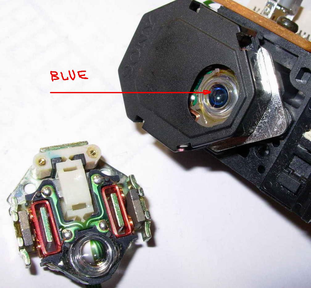

Excuse my ignorance, but my RCD-971 refuses to read any CD ("no disc" in display and when pressing play it spits the cd out). Clean a lense? How does one do that Help!? Regards from Oslo, Norway

Take the top off, locate the laser pickup and carefully clean the objective lens. Use a cotton bud and I guess something like a camera lens cleaning fluid.
I use Sony lens cleaning fluid. ISO is mentioned by many... Sony expressly warned against it years ago as it damages the coating on some lenses. Don't use glass cleaner (ammonia).
Glass of water with a single drop of detergent mixed in is OK.
The lens should look clean and bright if viewed with a bright torch.

Its normal pickup and good servosystem.
Old pickup KSS-213С have lense whis blu optical plases.
Chinamade KSS-213С have simple lenz(like botle Koka-Kola).
I replace old lense(whis slade and treking coil) for new pickup – its better.
Flat casle mast be demphing.
