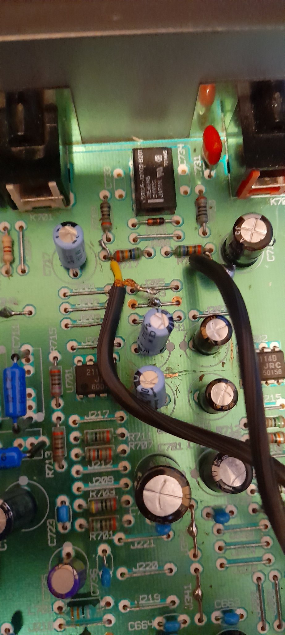

That is not going to carry you too far...Also if I unplug the good channel and turn the volume all the way up to max I can hear the music playing clearly but very quiet still.
Burn a CD with 400Hz or 1kHz sine signal and start tracing the AC voltage with a DMM.
Report back with your measurements.
Thank you for your help.Burn a CD with 400Hz or 1kHz sine signal and start tracing the AC voltage with a DMM.
This bypass has it working now just need to solder them in and not loose! But on the test speakers it sounds good. So the comment yesterday about the relay was correct?
I have looked for this 10 pin 1A 24vdc relay but can only find 2 online and they're in the US and not cheap.
Something like this wouldn't work? Relays are somewhat standard...

Capacitors on the last photo are different from the photo in the opening post - is it the same device?
Yes same player just recapped any slightly off output lyrics.Capacitors on the last photo are different from the photo in the opening post - is it the same device?
