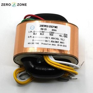

I would look at the power supply.
i am not a big fan of toroidal transformers in low level units ... especially if standard regulators are used.
They have usually poor rejection of higher HZ mains noise
I prefer EI type or better R-core
