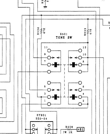

You could bybass the tone stage but its still nice to confirm (and maybe fix) the original issue. Drys are a definite possibilty. Its also often possible remove and open up switches to clean them properly... squirting with something often doesn't last. The same applies to pots to. Many (not all) can be opened and cleaned and the wiper bent slightly both to retension and move it to a new part of the track.
To by bypass the tone controls you need the circuit in front of you. The switch is in the bypass position as shown and so you solder across pins 1 and 3, 2 and 4, 11 and 7 and 12 and 8 but check that first with a meter... you go cross eyed looking at these things on a screen 🙂
Here's the switch shown in bypass position.

This switch (judging from the drawing) is not going to be easy to remove. Both the steel cover and the insulating switch frame holding the contacts, are likely soldered at multiple points. I would not attempt this unless you have a solder sucker or fluxed solder braid, to remove the solder completely. Otherwise, the PCB will be damaged if you try to force it out whilst heating with the iron. Even so, It may still be necessary to remove the front panel in order to release the switch.
In another thread, where there were similar problems with these Rotel rotary action slide switches, the fault was in the mechanism, which can no longer push the slider contacts to align with the fixed ones. Unless you can somehow repair the mechanism, I think the best fix will be to bypass it, as Mooly described.
