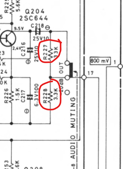

My Rotel RA-611 produces excess hiss - enough that it's audible from across the room with the volume at zero. I believe the issue is in the Tone/Preamp section, since if I pull the connectors to the main amp the hiss is gone.
I've traced through the circuit with an audio probe and it's nice and quiet until the collectors of Q204 and Q208. From this point forward there is the loud hiss in the circuit. I thought it might be the 50 year old transistors, so replaced the 2SC644s with KSC1845Fs, which made no difference. All of the voltages match the schematic, the capacitors have been replaced and the carbon resistors have been replaced with metal film - also made no difference.
Please find the schematic attached.

Adding a little attenuation is probably the easiest. I'm guessing you never use the mute function and so the easiest way is just to alter the two resistors in the mute circuit.
If you change the 33k and 3.3k to a 15k and 12k you would get -7db attenuation instead of -20db. You don't want to load the preamp stage with to low a total resistive value but equally for best results you don't want it to high (although no damage would occur whatever values you pick).

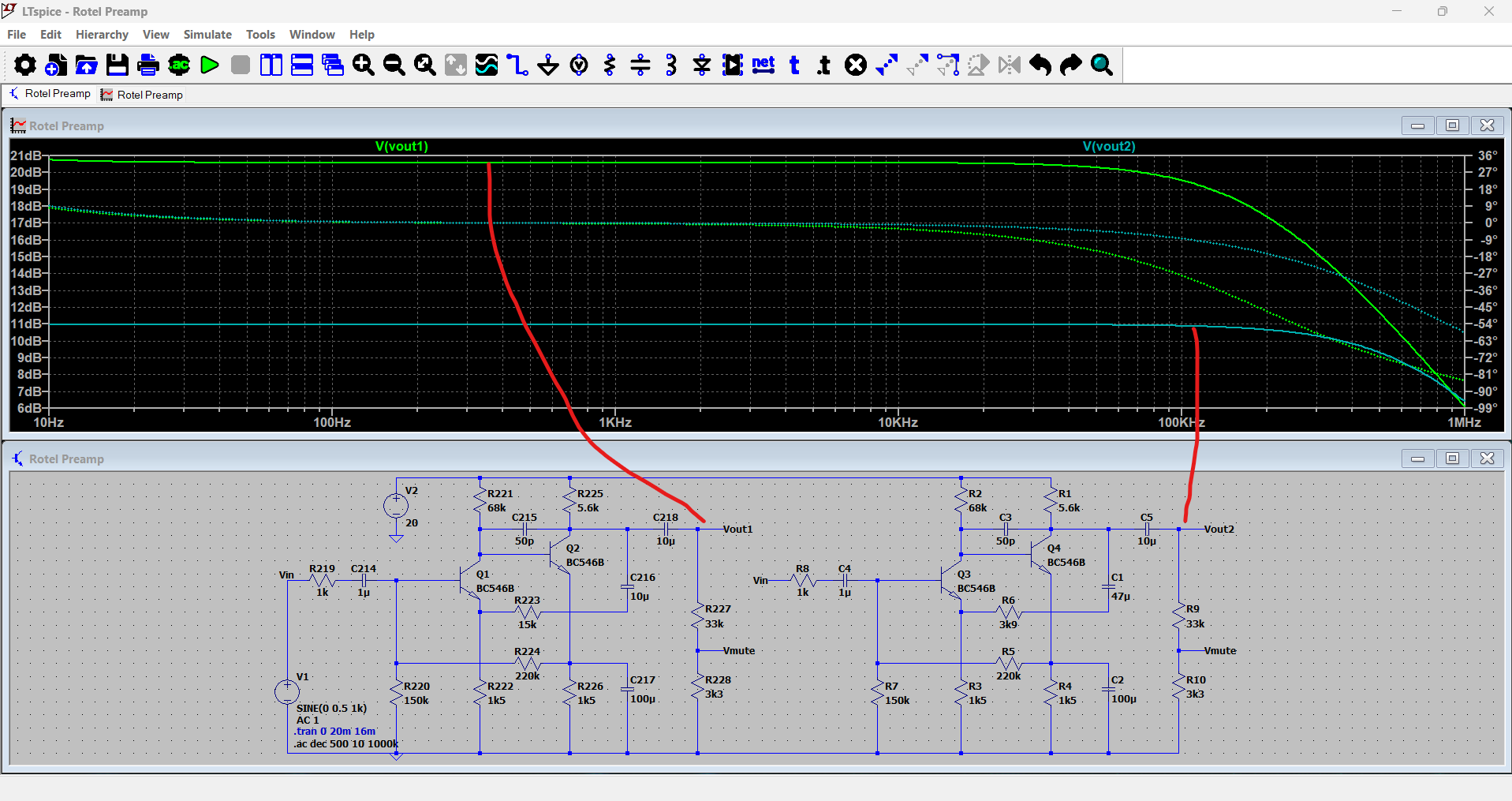

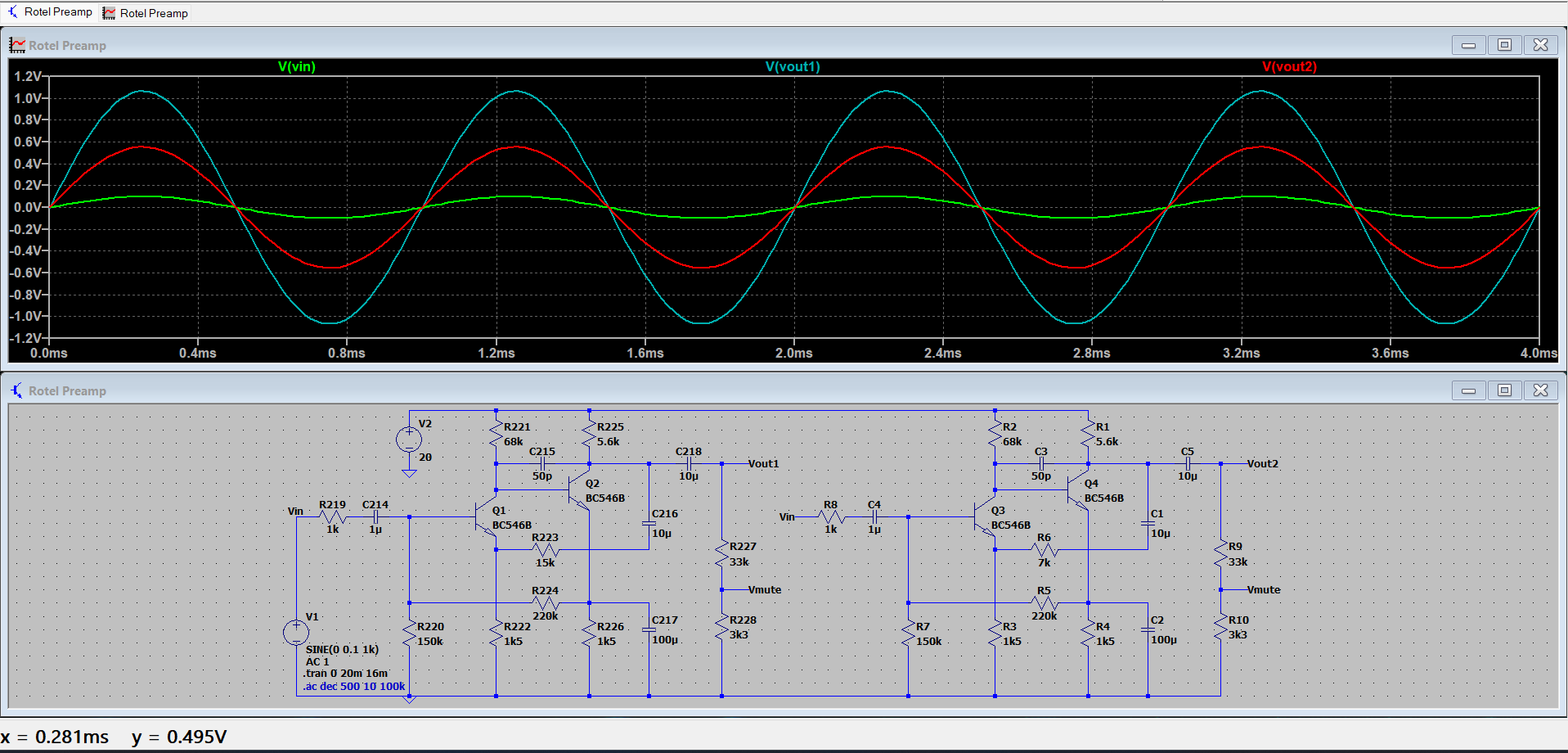

I'm pursuing altering the line stage gain as something easy to try.
This shows the original configuration on the left and the altered on the right.
We have voltage into both in green, the output of the original in blue and the output of the modified stage in red. All that is altered is R223. I've actually gone down to 3k9 here.

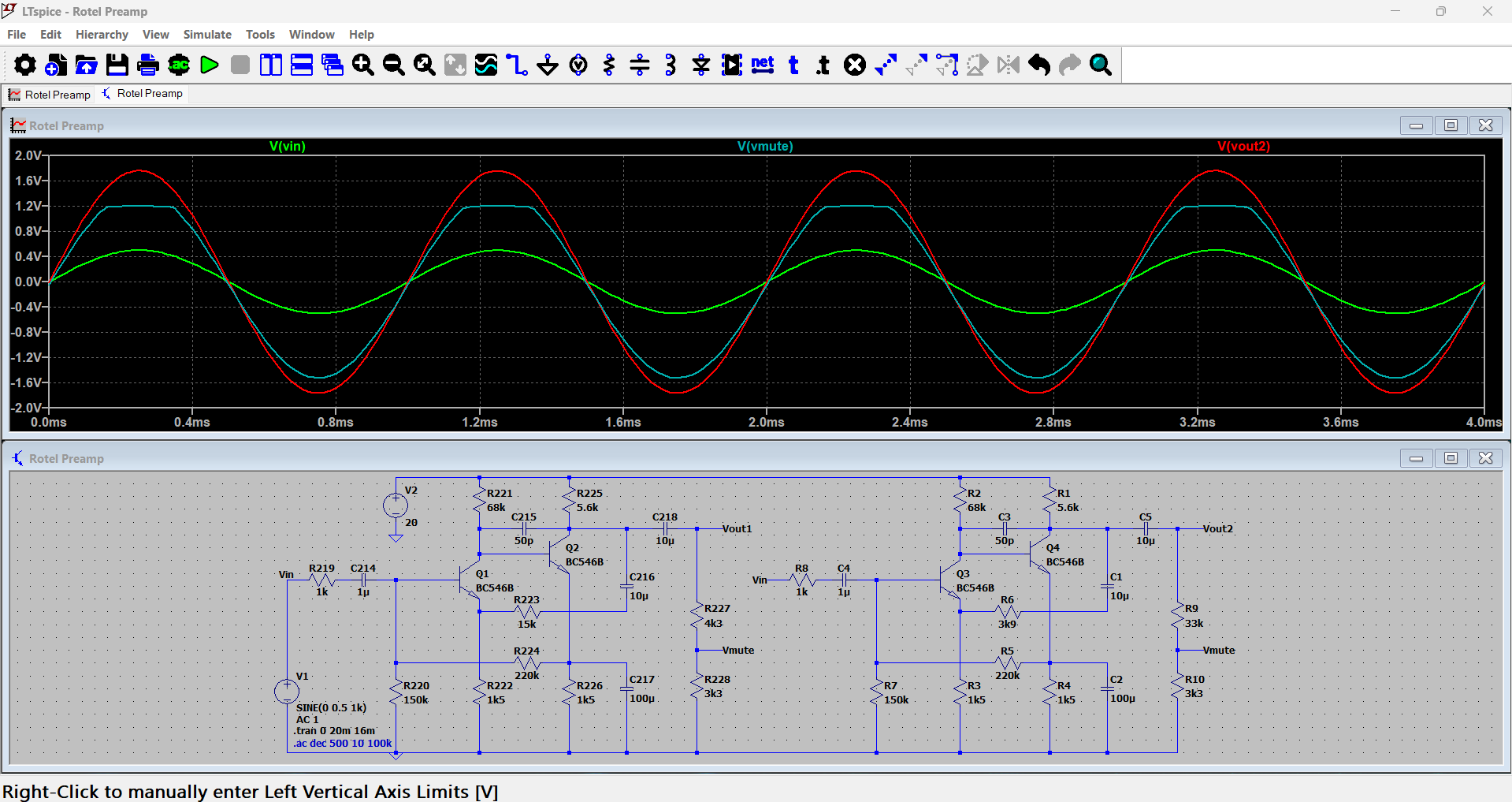

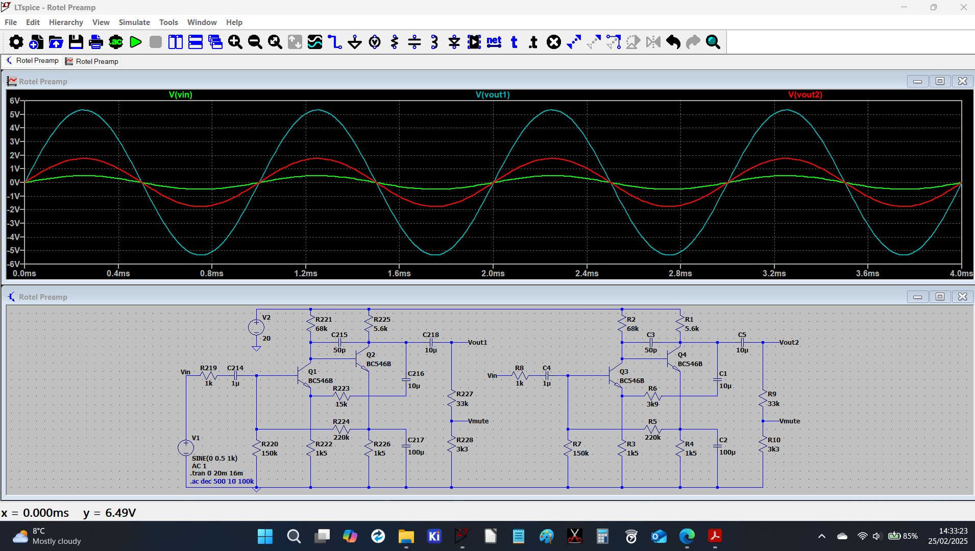

If we look at the original version and now alter the mute resistor and the fitting of a 4.3k to give a -7db attenuation we hit the problem of the loading becoming an issue and causing clipping.
The altered gain stage on the right does not clip and offers almost the same attenuation as the -7db mod.
Response of two version, original and modified. This shows the gain down from 21dB to 11dB. The high frequency response is a little more extended as we have reduced the gain.

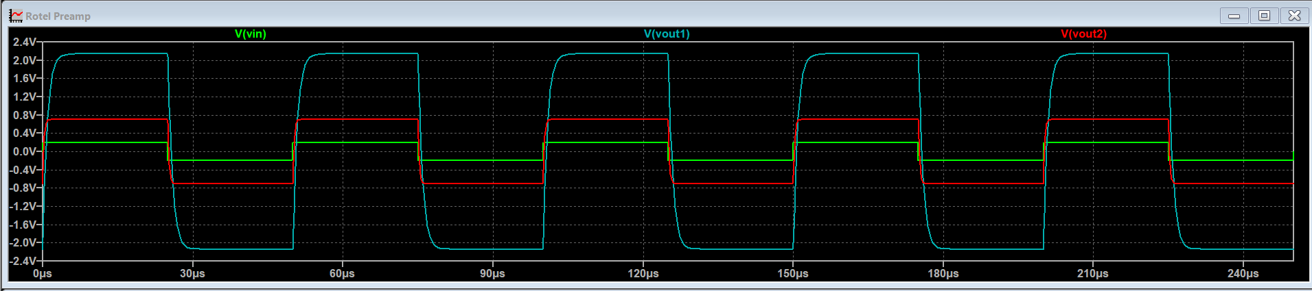

Square wave response at 20kHz. All good. As before, Vin in green, original output in blue and modified in red.
This is a modification that would be super easy to try because all you need do is tag a new resistor across the original 15k to get the value you wish. A 5.6k would get you to around 4k in total.
