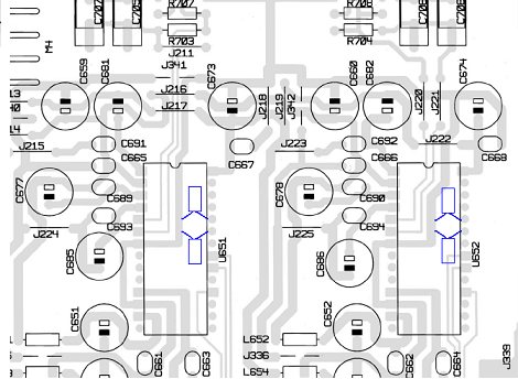

jean-paul said:My experience with replacing PCM63P or J is slightly different. K version is an improvement ( not too big but remarkable ) but if there are adjustment pots on the PCB it is better to remove them if you haven't the equipment to adjust them for least distortion. Leaving them as they are will degrade performance of K or whatever version more than no pot at all. My experience with these chips was not when used in this particular Rotel cdplayer but in some Pioneer models and separate DAC's.
In my Rotel RCD-971 those pins for adjustment are not connected to anything. But the PCM63 datasheet recommends connecting the pins 23 and 24 to the ground via 0.1uF caps. I am planning to solder two Black Gate NX Hi-Q 0.1uf/50V for each DAC on the bottom of PCB as shown on the picture. Is that a good idea, any thoughts?
