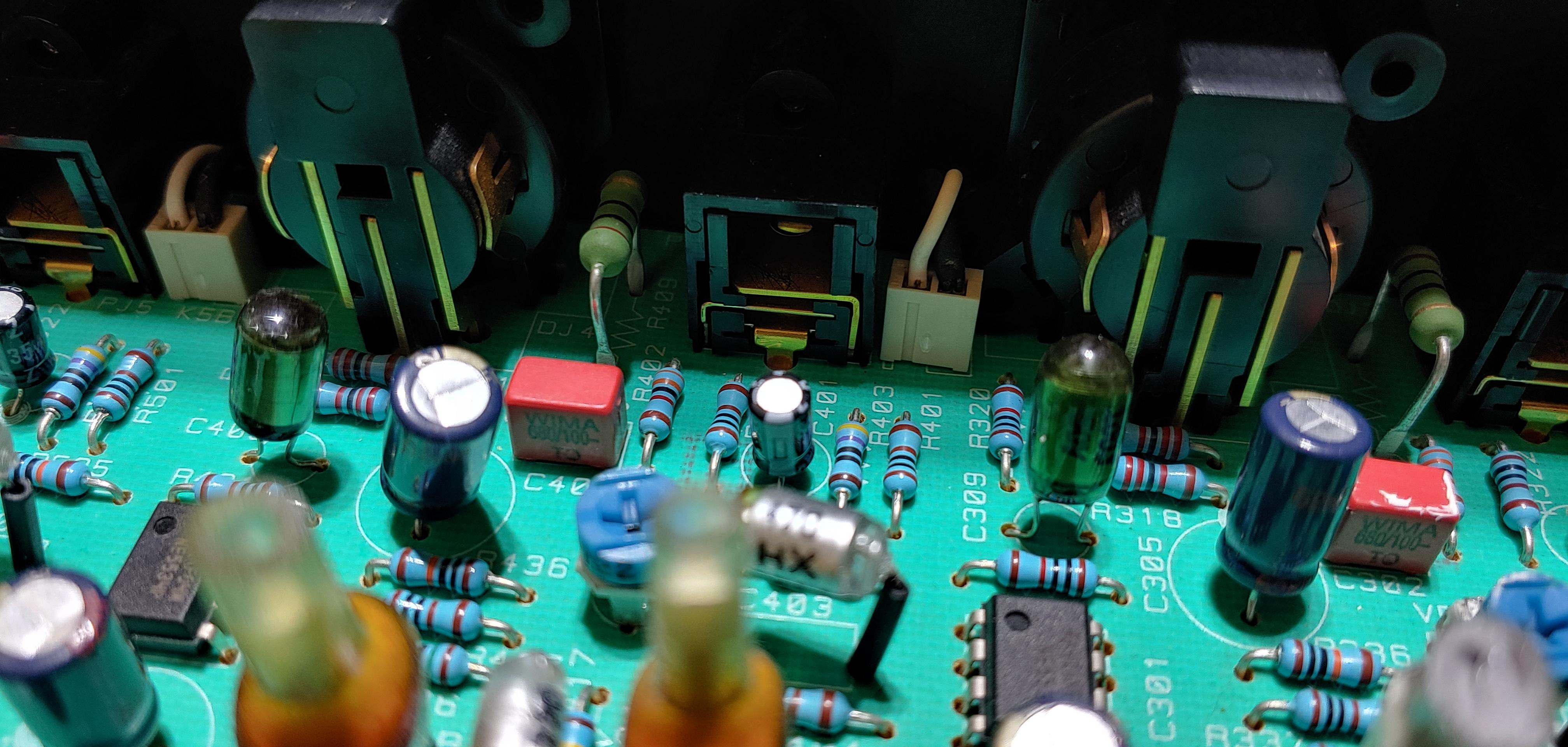

Hi Chris, I have questions regarding "reduce bias current...". I found a service manual for this Rotel RMB1095 amp (attached picture). Under the "service", it stated (adjust to) DC mili volmeter read 5mV. You mentioned set to 20-30mA.... So assumed if I am going to readjust the bias current, what should I reduce it to?? is this document what you were talking about??

Hi Bill,
Thank you. Yes, for 0R22 emitter resistor measuring across a single one would yield about 23 mA which is entirely reasonable.
Hi nguyenphananh,
The amplifier should not run very warm at those levels. Measure the supply voltage and multiply that by 0.023 to give you the heat dissipation from each output transistor. That should give you an idea of how much heat each transistor dissipates at idle.
First measure the bias current on each output transistor (to make sure one isn't running way too hot) and record them. I would love to know what level the bias current was set to. One easy way to do this is connect one lead of your meter to the positive output terminal for that channel. Then just measure the lead of the emitter resistor nearest the emitter. You'll have two hands to do this. I do not want you to measure on the emitter itself as it might be too easy to slip with the probe and short the transistor emitter to the collector. That would cause next to instant failure of that channel.
There are times when they invert one channel and the active output is the negative terminal while the positive one is "grounded" (ie some Carvers and others). Some other amplifiers are bridged, which means both the red and black terminals are active (ie the Adcom GFA-1 and 1a). So keep this in mind when looking at other amplifiers.
