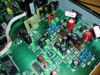

Hi!
1) independent PSU for spindle motor\pickup motor.
This decrease low and high frequences hum\noise in another digital supply circuits such as rf-amp, decoder, dac. Very effective!
2) replace low quality ceramic caps ("disk"-type) on X7R
3) replace diodes (very cheap Infineon SDT04S60)
4) replace 3-pin regulators on discrete (analogue stages) and advanced regulators such as Linear Technology LT317\337 (for digital stages)
5) add master-clock generator (such as Kwak-Clock and etc.)
6) replace output opamps. (I use AD811 as I\V, THS4601 as output buffer)
Look some photos (sorry, but without text) with Rotel-951.
This project curently in work.
