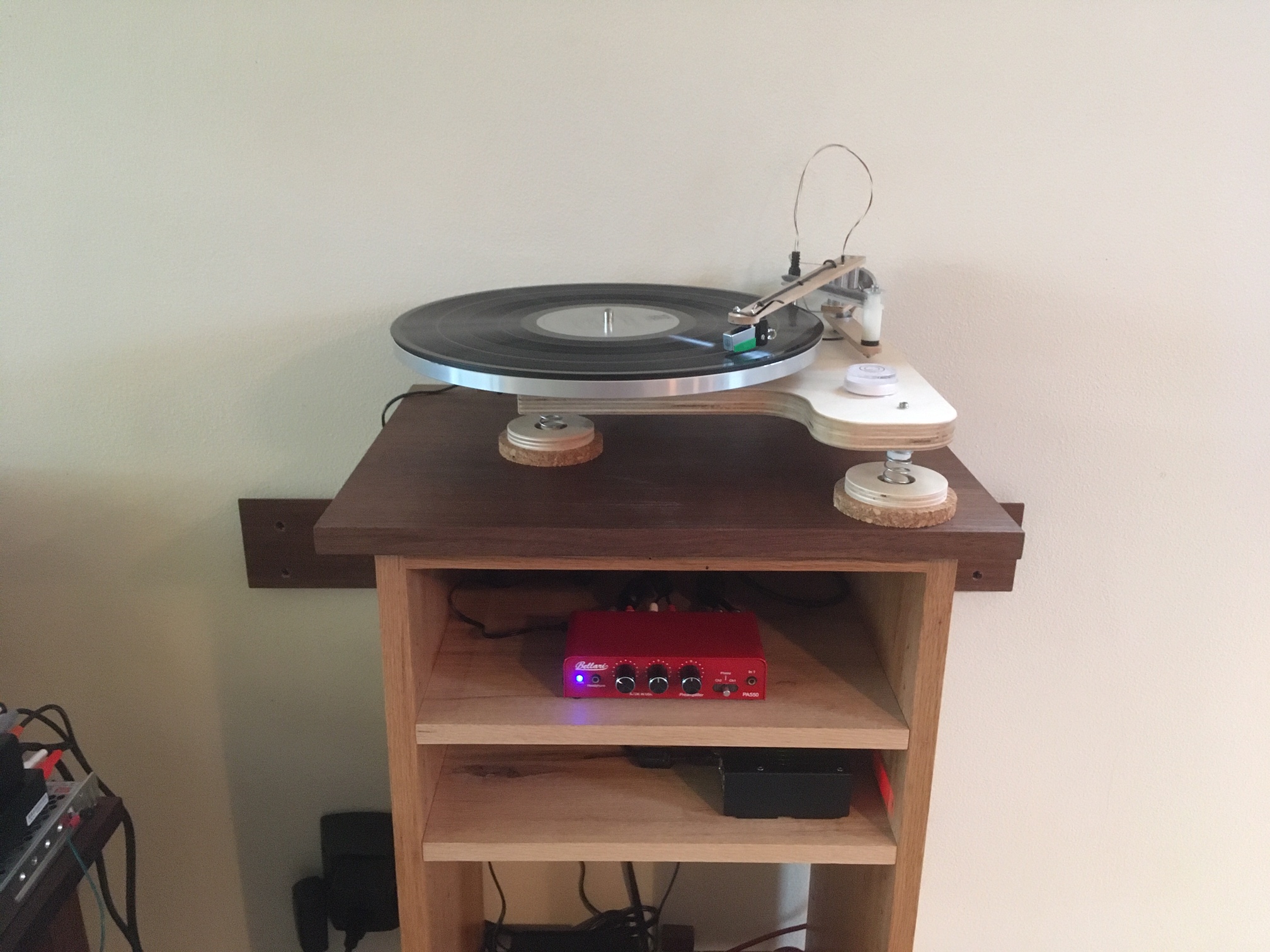

I've included a pic. The new power supply is on the bottom shelf, I should have tried to get that in the photo.
I'm currently running an Audio Technica VS215E in a 1/2" adapter. It came with the original SL-6 and is a good match for my lower-mass tonearm. I had tried AT-VS95* 1/2" cartridges and they were good, but I had some trouble tracking vibraphone. I have a sampler album with some solo vibraphone, turns out it is a bit of a torture track, probably akin to the Shure album with the bells. Anyway, the old p-mounts with their higher compliance values seem to be a better match, as the problem went away.
The p-mount also does a better job tracking the HiFi News test album skating force tracks. I can track them all. I get distortion on the highest amplitude track, but the needle stays in the groove. All the other skating force test tracks have no distortion.
I had built a wall shelf for the unit but found I was getting street noise (I live on a busy street). I think the combination of the cooler temperatures and harder tires/ground was causing the stiffer suspension I was using previously some difficulty. With the adjustable spring feet, I can rap the shelf and get no sound.
Also added a better/easier azimuth adjustment for the tonearm. My counterweight is a stack of stainless washers between nuts, and I've added an asymmetrical piece at the end. Once I set the tracking force, I dial the azimuth in by spinning that piece.
It is sounding pretty good. This was V1, I'll likely do a V2 with a few improvements learned from V1. I already purchased another motor/spindle/platter via eBay so I can be working on V2 while still "driving" V1.
