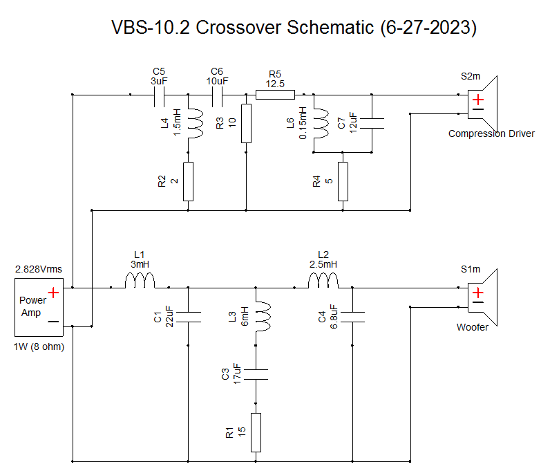

I have attached an example of a crossover that is beyond my reckoning. It's for the VBS 10.2. In the case of this crossover design, what is the benefit of placing the LCR filter in the middle of the 4th order filter, rather than before or after? For the tweeter circuit, why are there so many resistors? What is the filter in the HPF that uses an inductor+cap+ resistor? I know there are reasons for these things, but I don't know what they are. I probably speak non sensibly, but it is hard for me to speak sensibly when it doesn't make sense to me. Anyways, if anyone knows of any resources that makes sense of crossover design in a deep enough way for me to make design decisions like I'm describing, I would really appreciate it

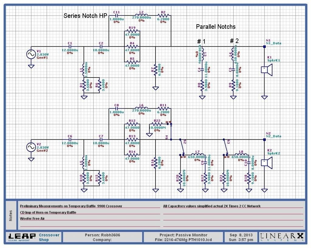

The easiest way to see what's going on if you have the schematic in a sym is to just add switches. That way you can just look at the response changes
as you shunt it out of the circuit. If you look at the attachment you can see the switches added for all 3 notches. I used the switches to see exactly what the notches did to tailor the Frequency Response.
Rob 🙂
