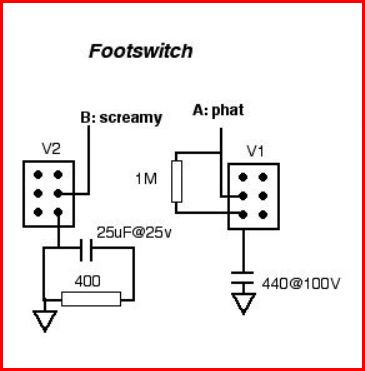

No Mooly, the point B (and A on V1) are the connections on the footswitch. Ground symbols are drawn w/ an arrow pointing down-all of them do.
The cap and resistor are not in circuit.
All the switch does is short point B to ground as drawn.

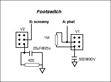

From point B to the switch, connect the switch and you have 'whatever the correct term is' for the stuff coming from point B of the cathode now adding the 400 ohm resistor and 25uF cap before it goes to ground. Maybe you are seeing a direct line to ground due to the drawing
Please assume I know how to hook it up, the amp does work, and quite well. The drawing is supposed to represent the cap and resistor wired in parallel to ground from the switch. I see the line from the switch to the box may look like it's not connected that way, but I would not have a very nice sounding amp if it were like you are understanding it. The picture is a better representation because that is what I am using.
It seems like too much is being made out from my drawing.
The only issue is: can I switch in an additional resistor on any preamp cathode w/o popping noise? (not including the FET info) And for that matter, switching in a bypass cap w/o popping noise also. The cap issue has been resolved as far as I am concerned-the time constant wrt resistor.
With that said: Imagine a 12ax7 cathode w/ a 1.5K resistor to ground. I want to add another resistor, in parallel, to change the value of the resistance on the cathode. Any switch, anywhere. Can that be done w/o popping noise?

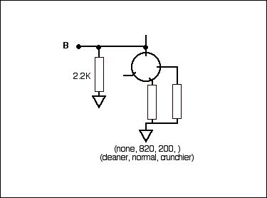

As I said before, if you have only resistors in the circuit between the cathode and ground, and you throw a switch and then have only resistors in the circuit between cathode and ground, a small capacitor between cathode and ground that is ALWAYS in the circuit may get rid of the pop. It depends on the size of the capacitor.
It needs to be small enough that it has a higher impedance at 1kHz than your highest resistance combination, which in this case appears to be 2.2k on the B tube.
And it needs to be big enough to keep from charging near instantly THROUGH the resistors.
Try different values and see what happens. A small capacitor will have little effect on the audio, whether you later switch in a big capacitor or not, whether you have a capacitor in the circuit and switch it out.

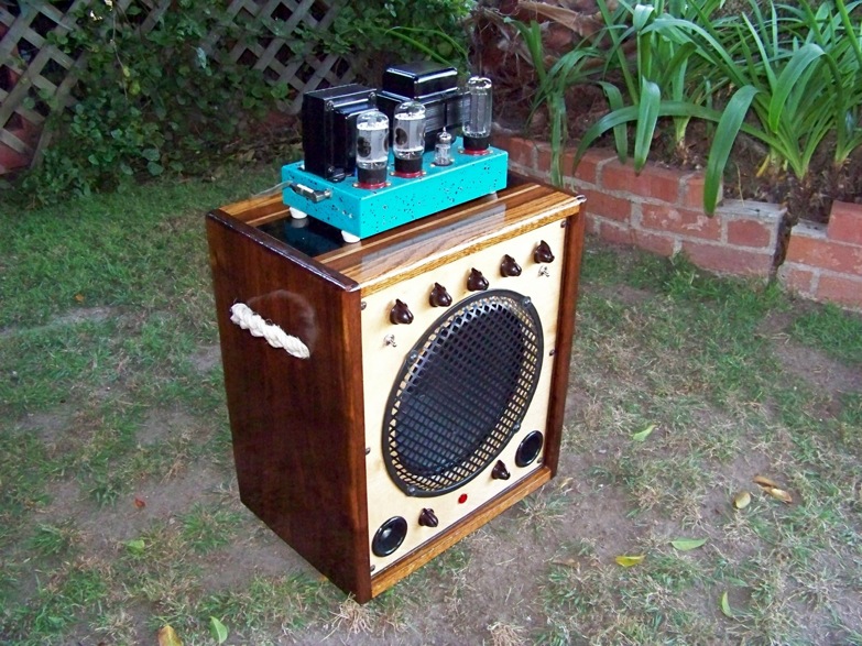

Here is picture of the amp, in case you're interested...
