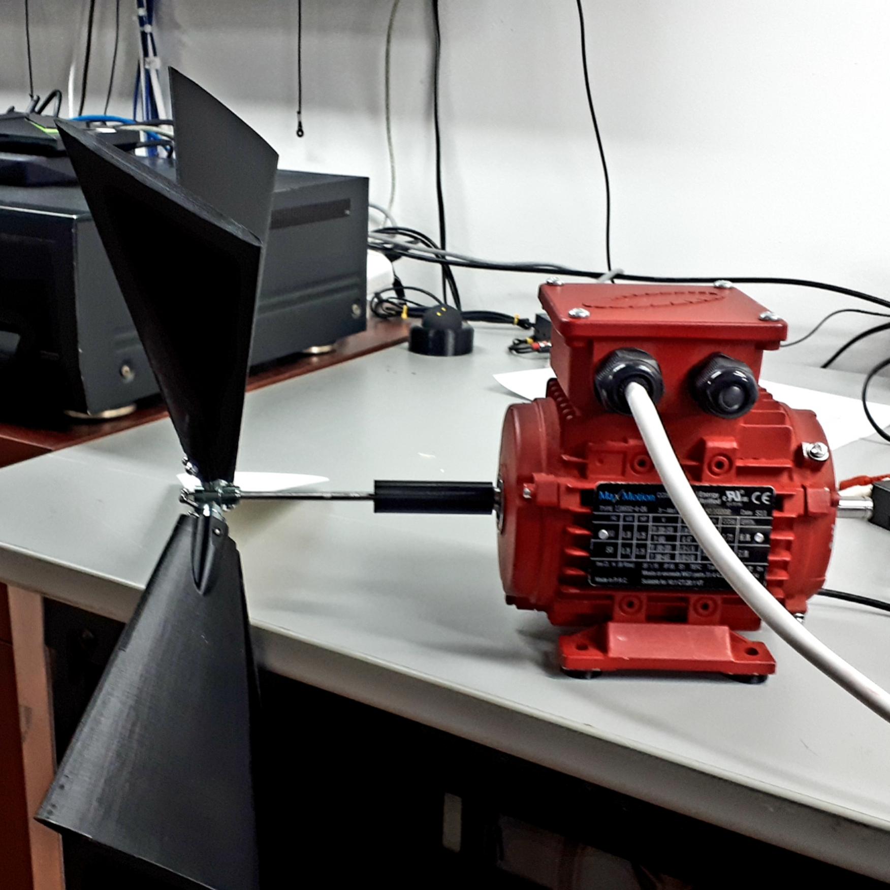

1)When I said that it works quite well I meant that it is working properly electromechanically.
2)I can't test its effectiveness until I place it in an infinite baffle. That said I have measured the SPL with the fan spinning at 800 rpm in neutral which is +12Db above the noise floor. Reducing that 12Db through blade design and baffle systems is what I am focusing on.
3)Only a rotary sub woofer can reproduce a significant SPL below 20Hz. Only a rotary sub can produce +100SPL at those infrasonic frequencies.

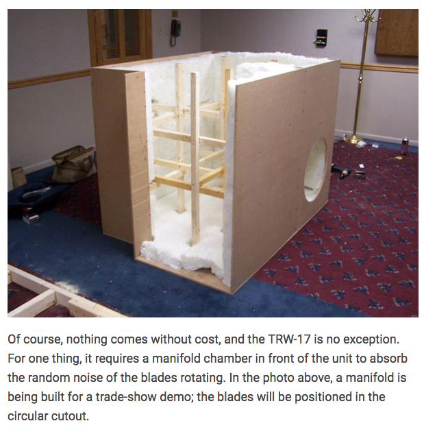

Standard subs make no noise with no input, fans always make noise, whether contributing any signal or not.
Is high SPL below 8Hz worth the continuous noise the fan will produce at idle?

1) Thanks!
2) C weighted at 1 metre
3) I'm impressed with Captivator's specs but it would cost me at least $4K USD to get down to 12 Hz. To get there JTR has to pump 4000 to 6000 watts into two 18 inch subwoofer drivers! With a rotary sub I can get down to 1Hz ... total investment $400 Canadian. Plus I only need 150 watts to drive it.

3)The Captivator 4000ULF is a commercially available loudspeaker comparing favorably down to around 8 Hz to a commercially available rotary subwoofer transducer costing three times more even before building it's baffle and noise suppression chamber.
Any speaker can "get down to 1Hz", it's the SPL at any frequency that counts.
Until you build a baffle and measure the response, no way to know your SPL to $400 Canadian investment ratio, or the signal to noise ratio.
